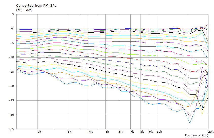

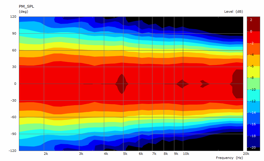

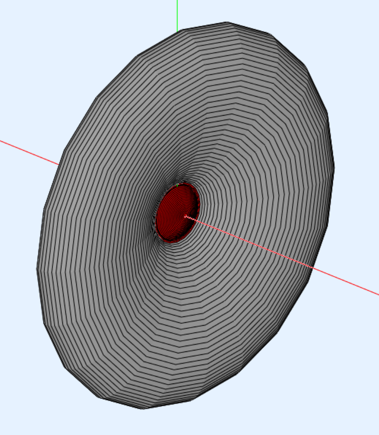

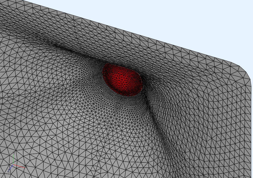

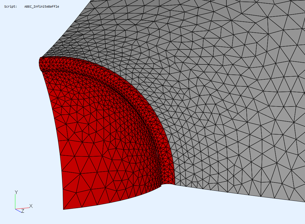

- I've found some older experiments with Bliesma T34B, here's the code for its shape if anyone wanted to try their luck. I haven't found anything that I would be really satisfied with but probably haven't tried hard enough (also I had no optimizer at the time)...
I only hope it still works. It should be also easily possible to add various "phase equalizers" in front of the dome in the script.
It's all described in 6.5 in the User Guide: http://www.at-horns.eu/release/Ath-4.8.2-UserGuide.pdf#page=40
Code:
; Bliesma T34B
Source.Contours = {
point p1 7 0 3
point p2 0 17 0.6
point p4 -1 18 0.6
cpoint c1 -17.139 0
cpoint c2 0 18
arc p1 c1 p2 1.0
arc p2 c2 p4 0.75
arc p4 c2 WG0 0.25
Source.Velocity = 2

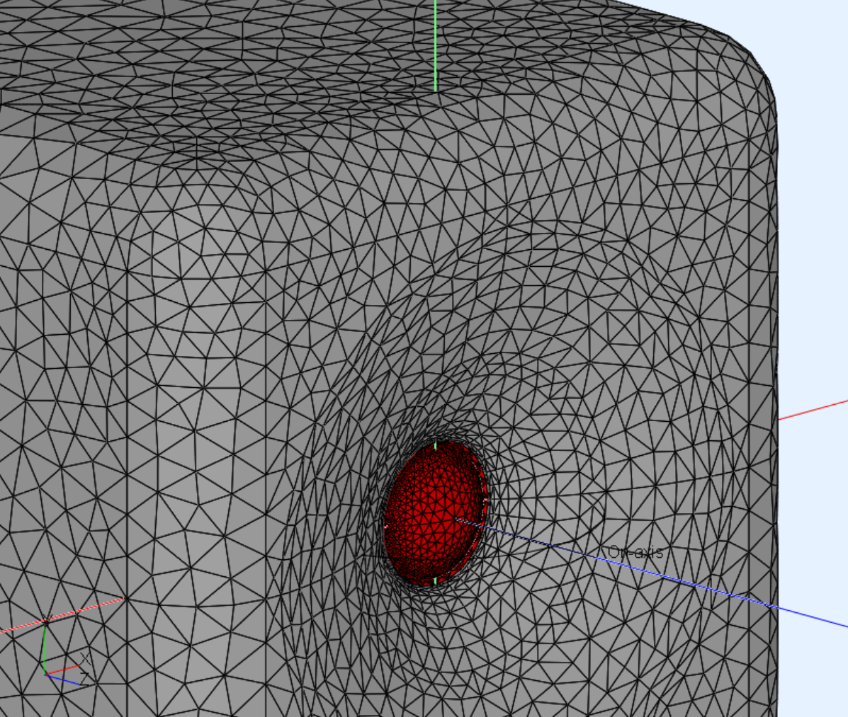

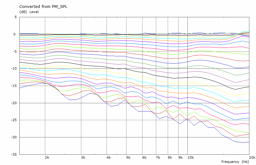

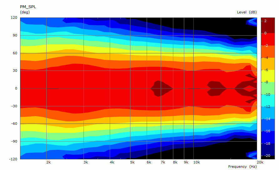

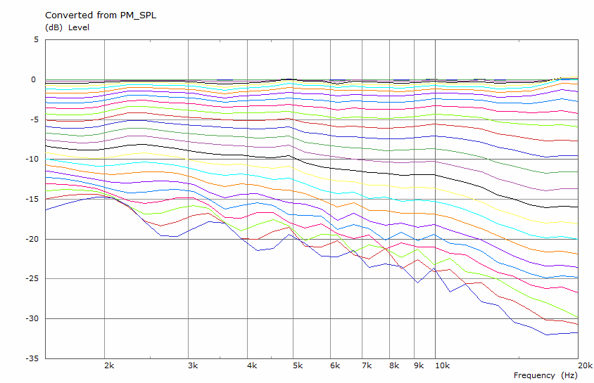

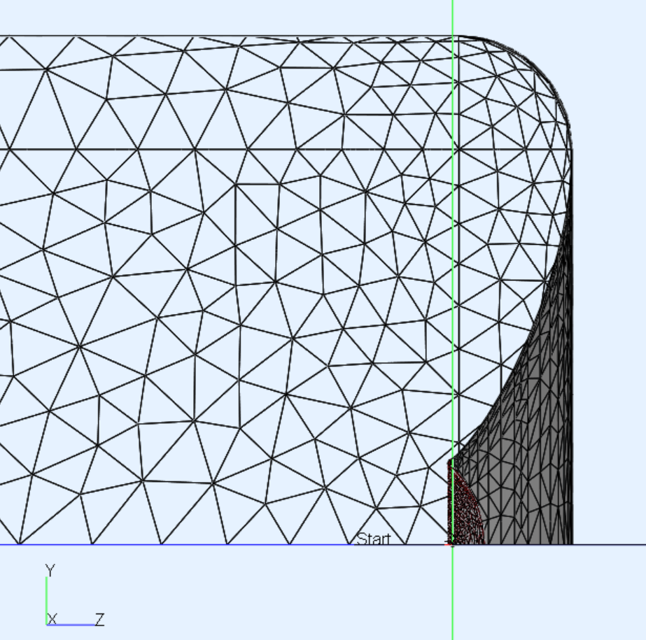

...Only quickly put in a ST260-like free-standing "plate" -
Now someone could try to make it a bit wider

Yeah, I would say that if top octave performance is critical then something like that would be obvious choise over compression drivers.
It wouldn't work with very low crossover, so both would enable different kinds of systems, bigger or smaller mid.
If one needs very narrow coverage then the compression driver work better at system level, better sound overall even if the top was little bit less than ideal.
One should choose set of compromises, which ever enables best fit system for given application.

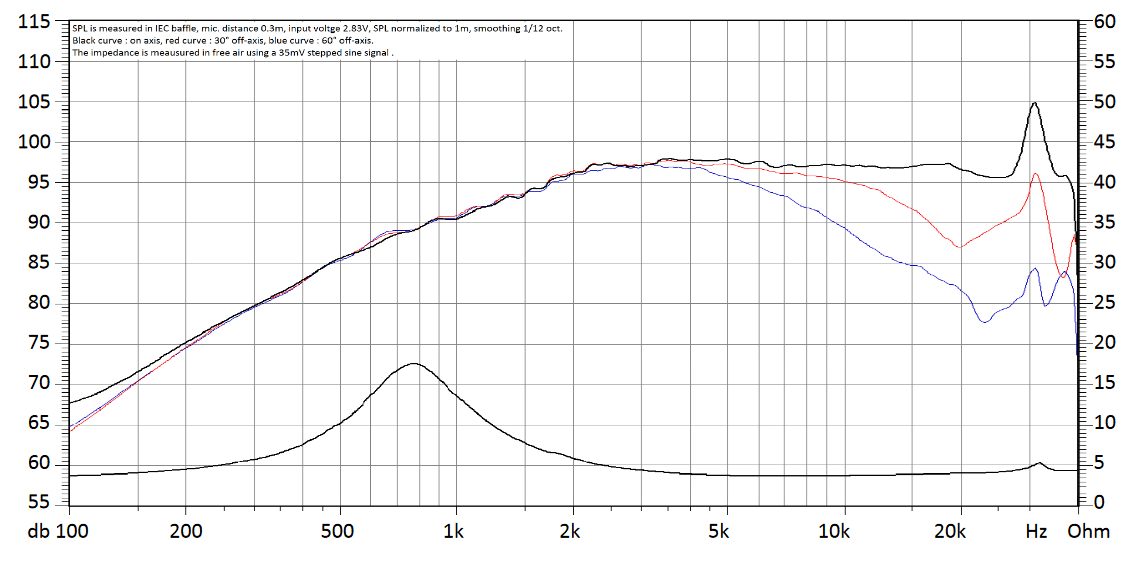

Given the very high breakup of the Bliesma tweeter, the above would be indeed an extremely smooth solution.
Could be approximated with an OSSE profile and put into a rounded box as well.
