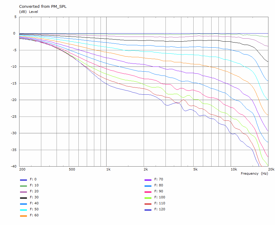

With a regular 1" throat, this is what I was able to get as "wide controlled directivity"...
(Could be more flat to ~15 kHz but then it would be more abrupt above it.)
The advantage being that one can use such device down to 800 - 1k with dynamics to spare.

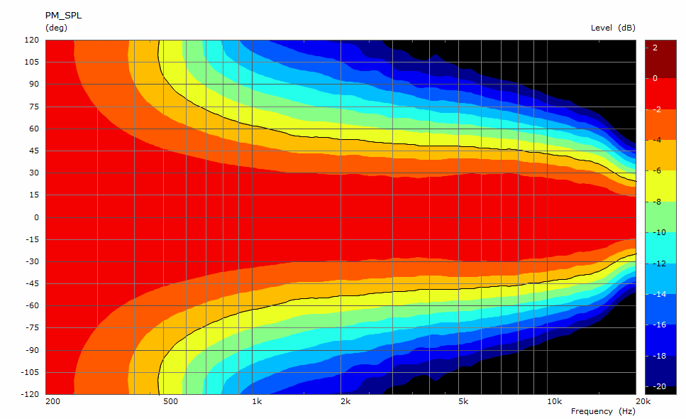

Interesting information about the Purifi approach from the measurement posted by sheeple:
More: https://purifi-audio.com/blog/tech-notes-1/spk16-reference-design-12For starters we use a hard dome that remains pistonic to ultrasonic frequencies.
The second being using a ‘Coherer’ i.e., a collection of ring-shaped objects that shape the wavefront around the throat of the wave guide in order to direct energy to the further of axis directions. Finally, the wave guide shape is of course critical for both controlling (ie narrowing) dispersion at the low end of the frequency range and yet allow wide dispersion towards the high frequency range.
Interestingly, the optimisation resulted in a waveguide being relatively shallow with a depth of only 16mm (which is surprisingly shallow compared to its 147mm diameter).

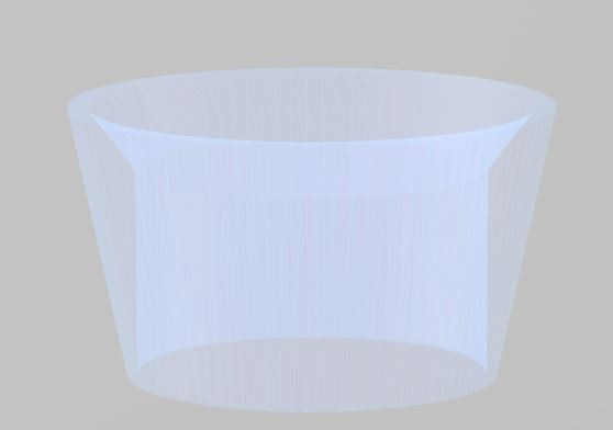

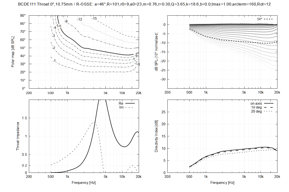

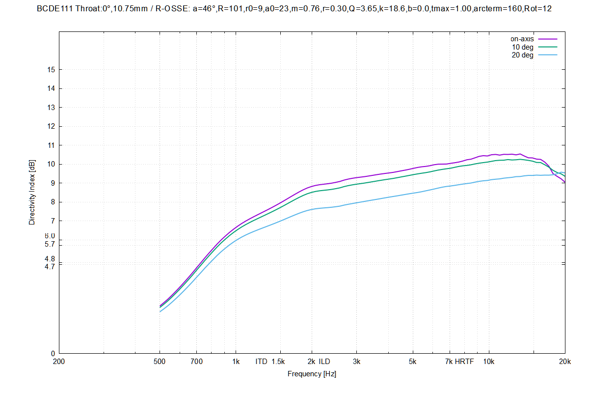

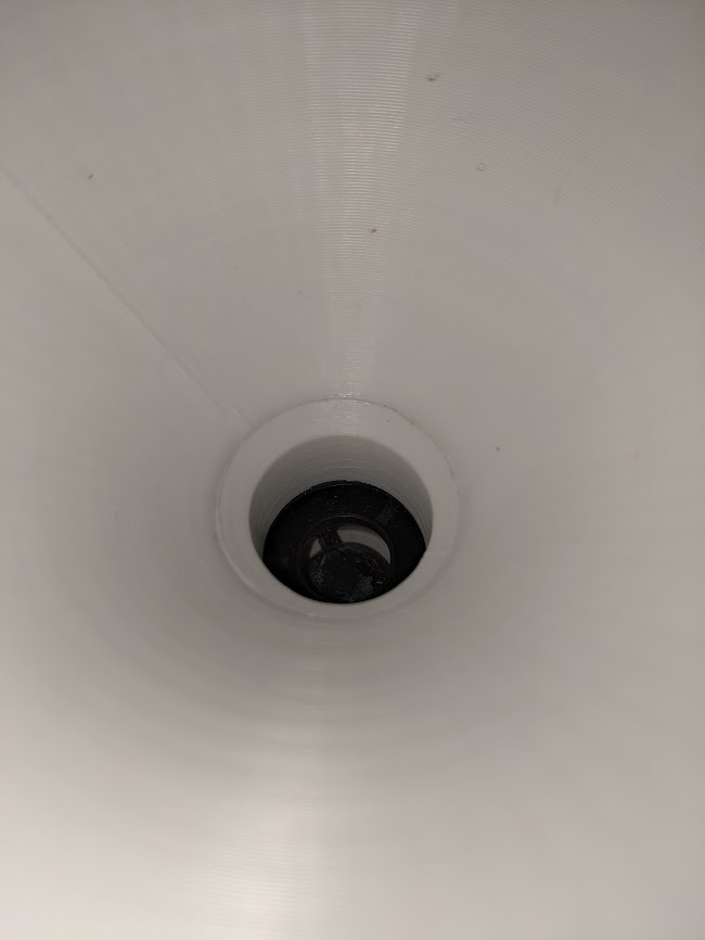

This is not wide coverage but it widens rather than narrows above 15k. It uses an internal ring. With my 3D printer I was able to fit the internal ring snugly inside the DE111 using a 12.002 degree half angle (a cone 25mm diameter 58.8mm in length). I printed the Internal Ring to only 14mm deep to fit inside the DE111 which is 15mm deep, leaving 1mm of wiggle room.
Throat.Ext.Angle = 0
Throat.Ext.Length = 10.75
Slot.Length = 0
R-OSSE = {
R = 101 ; horn radius (1/2 diameter)
a = 46 ;horn control angle
r0 = 9 ; compression driver throat radius
a0 = 23 ; compression driver exit angle
m = 0.76 ;
r = 0.30 ;
q = 3.65 ;
k = 18.6 ;
b = 0.0 ;
tmax = 1.00 ;
arcterm = 160 ;
Rot = 12 ; 7
I don't know if you're talking about the one I made for the DE111 or the horns higher up in the thread but mine is only simulation. I haven't finished printing the last part of the horn yet.
Narrowing the aperture which is kind of a diffraction slot, splitting the wavefront and redirecting it, like fins, multi cells and sounds similar to Purifi's coherer rings. Increasing the radiation impedance by bypassing the conical adapter like above isn't quite the same thing.Now I am curious: what is it that you know of, that could be done?
Above 10K greater knowledge of the diaphragm material, phase plug geometry etc is needed to simulate anything accurately. Purifi are using COMSOL multi physics to combine the properties of the driver and the waveguide together which is a step beyond anything ABEC/AKABAK can do.

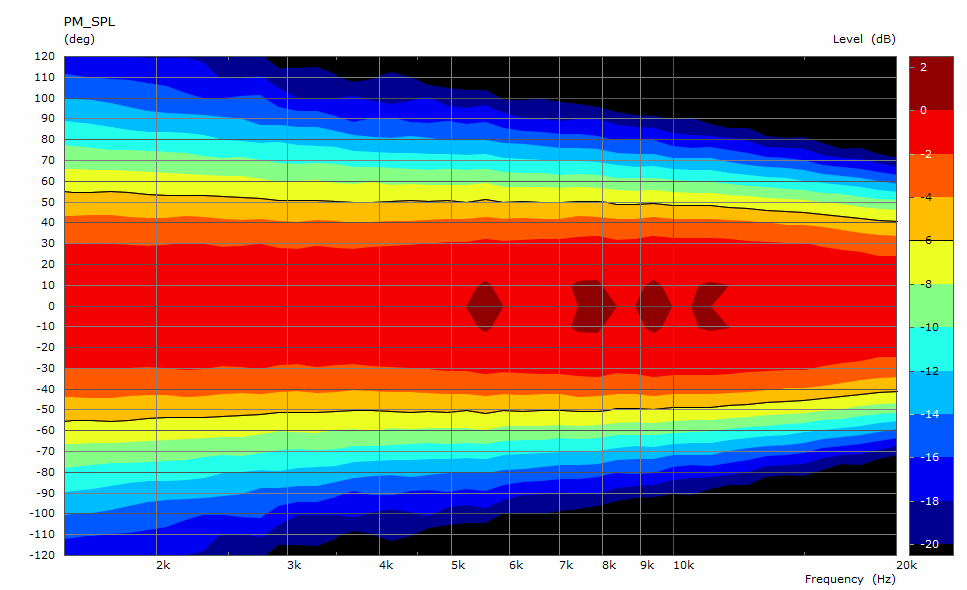

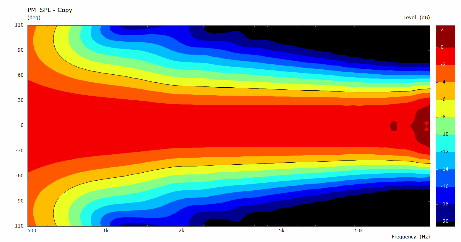

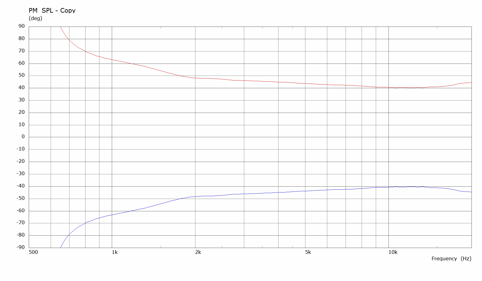

Here I tried just a smaller throat for my example in #12,384.
This is the regular 1" throat (black line = -6dB):
And this is with 16mm throat (possibly doable with a throat ring?):
It does extend it a bit but still it's not 140deg nominal coverage...
(I don't say it's needed or even a good thing, only that it would be tough to actually achieve that with a 1" compression driver.)
(This is the device from #12,218 shown earlier, designed to be used with an open-baffle midrange.)

^^ Depends on the throat depth of the driver. My driver has conical exit starting about 16mm diameter to 1" at exit, about 1" deep. I played with the throat/ring insert so that R-OSSE profile started right at the 16mm start and the top octave smoothens out in simulator, but cannot get coverage angle past 90deg or so if I remember. The throat is just too deep for smooth profile with wide coverage. Perhaps some more optimization could make it, but this is the impression I remember from the experiments. We would need compression driver with small opening and no / short conical exit.
Perhaps if the ring insert was straight tube without any expansion could work for some driver. Or driver with 0deg exit angle, or some big exit angle.
