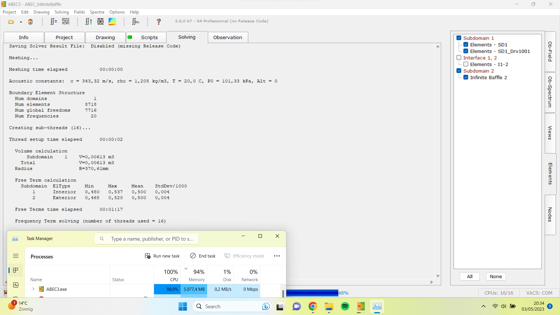

I've played around with Ath a bit more. So far, only OSSE in an infinite baffle. When the model becomes larger, particularly when Term.s=2 or slightly below, it takes quite a long time to solve the model. And I've already had it apparently get stuck at 48% for hours on end. Is this a common problem? Or should I simply give it a few hours more?
Is it because my computer is running out of steam? It's by no means a powerhouse:
Processor: AMD Ryzen 7 5700U with Radeon Graphics 1.80 GHz
RAM: 16,0 GB (13,9 GB usable)

For axisymmetric devices there's a "CircSym" mode, which takes seconds instead of hours (see 6.10 in the User Guide).When the model becomes larger, particularly when Term.s=2 or slightly below, it takes quite a long time to solve the model.
With a full 3D mesh (for any general device), you have to balance the total number of mesh elements by setting its resolution. It's advisable to keep it under say 5000. For complex models this can easily become quite limiting.
Thanks Marcel, this works wonderfully. The learning curve is steep, but I'm finally starting to get the hang of it!For axisymmetric devices there's a "CircSym" mode, which takes seconds instead of hours (see 6.10 in the User Guide).

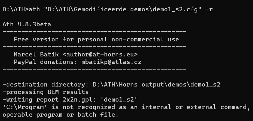

Right now I'm trying to create an Ath report, as explained in the User Guide chapter 6.14 Reporting Results. However, when I run the report script from the cmd prompt, I run into an error:
I think what's going on here, is that Ath is trying to use Gnuplot, but ATh doesn't accept the space in the path, in "Program Files".
Below is the line in de .cfg file, which refers to where gnuplot.exe is located.
GnuplotPath = "C:\Program Files\gnuplot\bin\gnuplot.exe %f"
I had this issue with spaces in paths before. It took a while to figure out that you can use quotation marks around the path to circumvent that. But can I use a similar trick here?
If the quotation marks don't work I suppose one could try to use the old "ms dos" short name: c:\progra~1\gnuplot\ etc. or move the gnuplot files to a folder without spaces...

I use this without the %f you hadBelow is the line in de .cfg file, which refers to where gnuplot.exe is located.
GnuplotPath = "C:\Program Files\gnuplot\bin\gnuplot"
