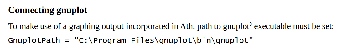

There really shouldn't be "%f" in the gnuplot path, which is obviously causing the trouble. Here's an example of ath.cfg:
OutputRootDir = "D:\Horns"
MeshCmd = "D:\gmsh-4.6.0-Windows64\gmsh.exe %f -"
GnuplotPath = "C:\Program Files\gnuplot\bin\gnuplot"
Yeah, but that's a common issue and I strongly recommend not to use spaces in file/dir names. You can spare yourself a lot of trouble, not only in Ath.I had this issue with spaces in paths before. It took a while to figure out that you can use quotation marks around the path to circumvent that.
Thanks! The "%f" behind the gnuplot path must be a remnant of earlier trial and error to get Ath to run. I feel sheepish again 🐑.

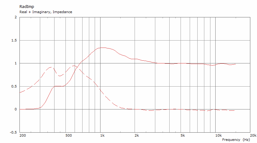

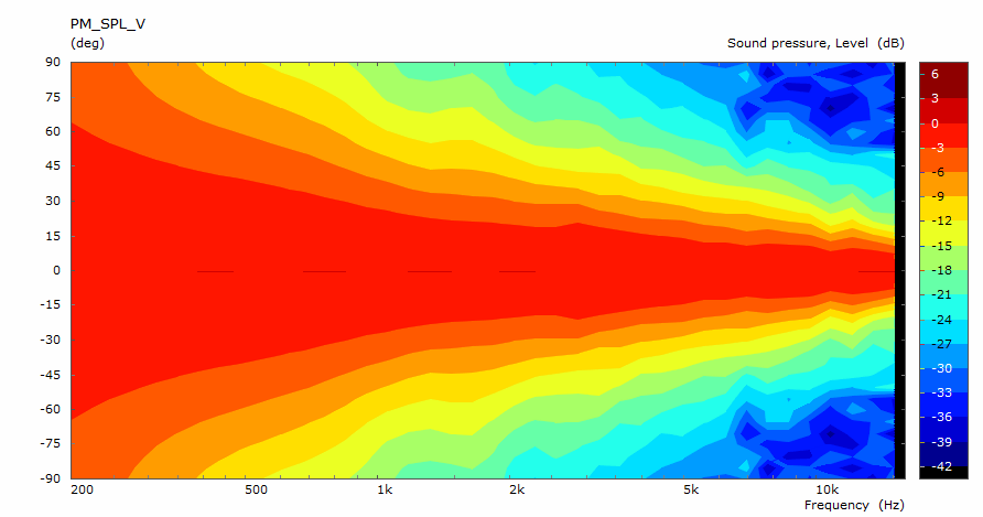

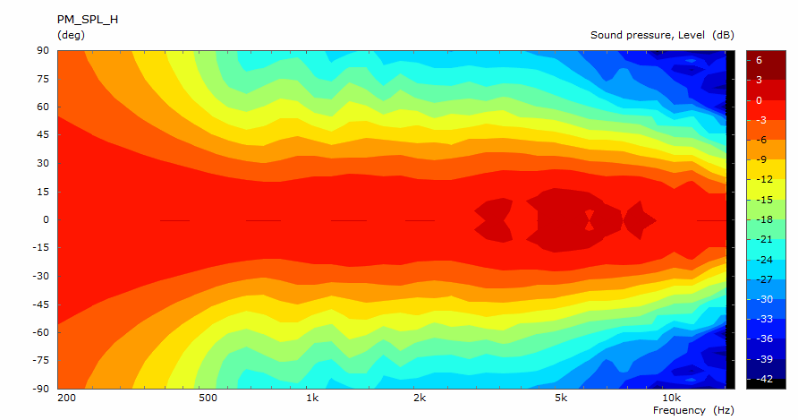

Hello Marcel, thank you for this horn code! sorry for my question, which is probably stupid, but I can't understand: am I doing something wrong, or for this horn/geometry type the rear shape function not available (as well as a rollback)? I've tried to make to check in AKABAK later little bit bigger free standing horn for the 2 inch CD. But I can't. May I ask you to have a glance please?Here's a two-boards design I can share 😉
(Not optimized in any way, it's just a quick try to see what it does.)
648 x 295 x 360 mm, 1.4" throat
H, V, Throat impedance:
View attachment 1094055View attachment 1094057 View attachment 1094058
Code:; DS8N / Ath 4.9 HornGeometry = 2 Length = 240 Throat.Diameter = 36 Throat.Angle = 0 Horn.Adapter = { L = 120 k = 4 Width = 120 Height = 42 SC = 0 Segments = 10 ZMap = 0.5,0.4,0.5,0.5 } Horn.Part:1 = { L = 1 Segments = 16 H = { r0 = 50 a0 = 30 k = 4 s = 0.78 a = 34 n = 4 q = 0.994222 } V = { r0 = 30 a0 = 5 k = 4 a = 23 s = 0.5 n = 4.0 q = 0.994222 } ZMap = 0.5,0.3,0.5,0.9 } Mesh.AngularSegments = 64 Mesh.ThroatResolution = 5 Mesh.MouthResolution = 14 Mesh.InterfaceResolution = 6 Mesh.RearResolution = 25 Mesh.SubdomainSlices = -2 Mesh.InterfaceOffset = 0 Mesh.WallThickness = 10 Mesh.ZMapElementSize = 0.3,0.6,0.5,0.95 ABEC.SimType = 2 ABEC.f1 = 200 ; [Hz] ABEC.f2 = 15000 ; [Hz] ABEC.NumFrequencies = 40 ABEC.MeshFrequency = 1000 ; [Hz] ABEC.Polars:SPL_H = { MapAngleRange = 0,180,37 Distance = 2 } ABEC.Polars:SPL_V = { MapAngleRange = 0,180,37 Distance = 2 Inclination = 90 } Report = { Title = "DS8N - H" PolarData = SPL_H NormAngle = 0 Width = 1400 Height = 800 } Output.STL = 1 Output.ABECProject = 1

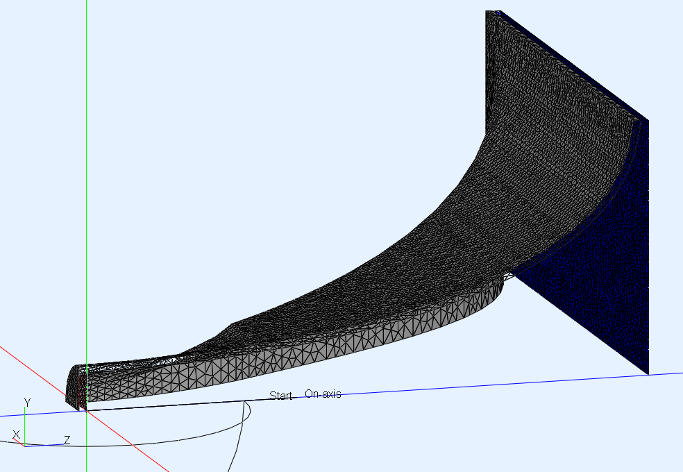

For a rollback in this case, what you can do is instead of defining separate "H" and "V" OSSE profiles, define a single "D" (diagonal) profile as R-OSSE, e.g.:I've tried to make to check in AKABAK later little bit bigger free standing horn for the 2 inch CD. But I can't. May I ask you to have a glance please?
Code:
D = {
R = 150
r0 = 25
a0 = 5
a = 35
r = 0.35
b = 0.15
m = 0.8
q = 4.4
Inclination = 20 ; [deg]
Note the Inclination item which sets the angle of the diagonal (when looking at the mouth from the front).
The old Rollback feature was removed from Ath altogether in the latest releases.
- You can simulate (and use) such horn as free-standing even without a rollback, though. It won't be as good but still pretty usable, IMHO, due to the asymmetry.

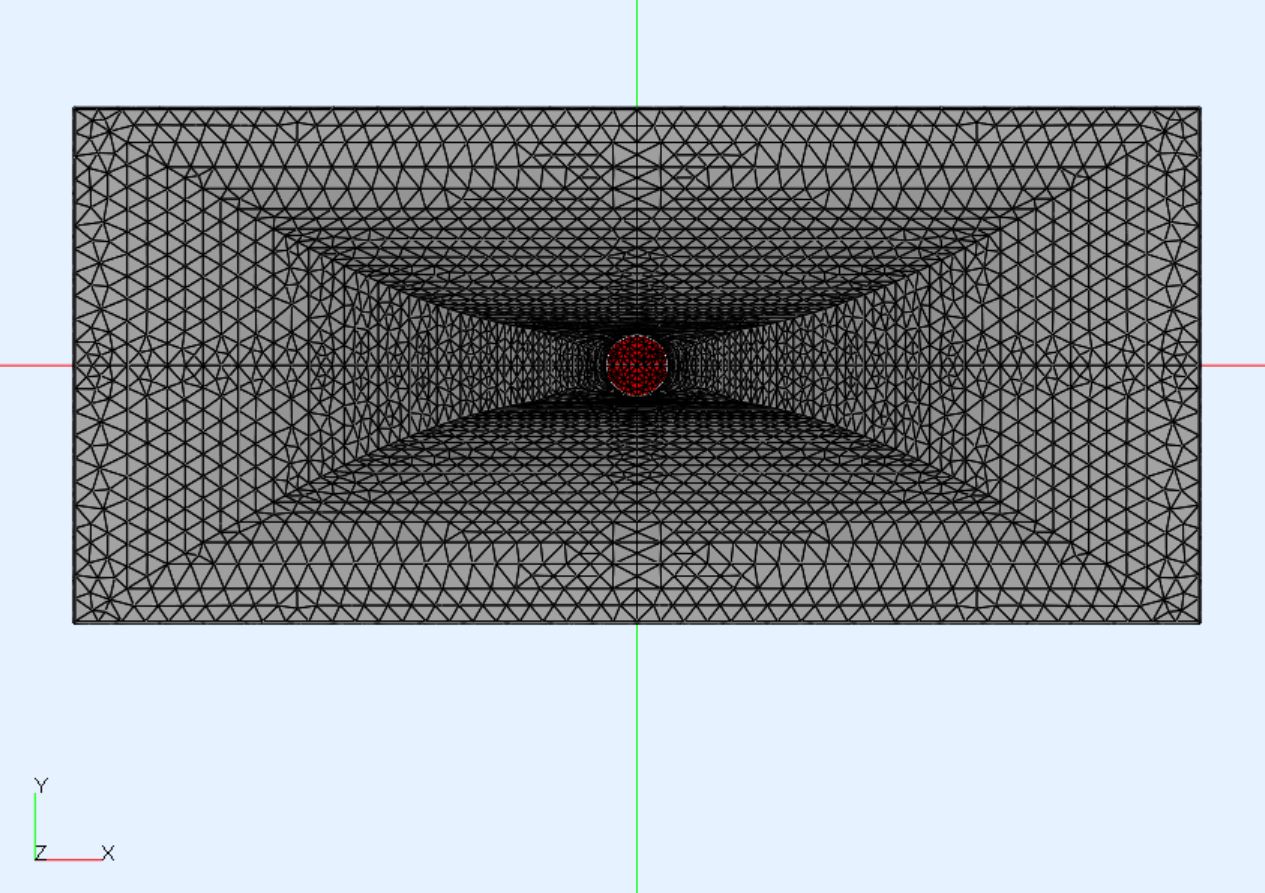

Thank you for this explication Marcel! for the rollback it's clear now, but as you can see in the code it was deactivated, the key issue was a rear mesh, is that feature has been also removed? :For a rollback in this case, what you can do is instead of defining separate "H" and "V" OSSE profiles, define a single "D" (diagonal) profile as R-OSSE, e.g.:
Code:D = { R = 150 r0 = 25 a0 = 5 a = 35 r = 0.35 b = 0.15 m = 0.8 q = 4.4 Inclination = 20 ; [deg] }
Mesh.RearShape = 1
Mesh.RearResolution = 5
Mesh.WallThikness = 10
Thank you for your work!
Roman
The code I provided (which you quoted) certainly produces a rear mesh as well - it's a free standing horn. Did you try that?

I tried the code you provided (as is) and it works fine. The only issue I see is the very large number of elements (over 17000).
I would suggest this instead to produce something more reasonable (~4200 elements):
(I have good experience with placing the interface somewhat behind the mouth edge (inside the horn). This is done with "Mesh.SubdomainSlices = -2", where -2 means the second slice from the end/mouth.)
