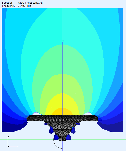

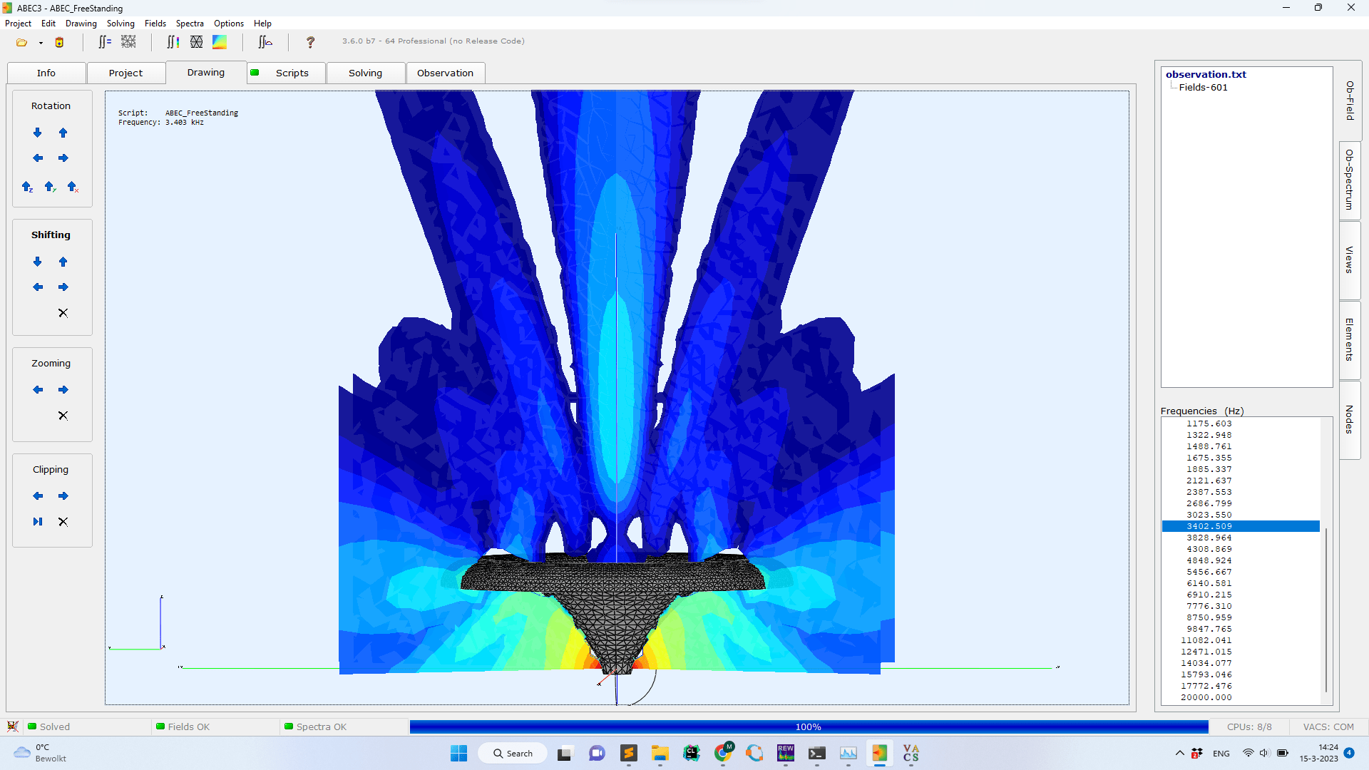

I'm (still) having problems with fields. I've started ABEC3 in windows 8 compatibility mode (on win11 machine), but this still doesn't look right:
Higher SPL on the back...
Anyone any idea what is going on and how to fix that?
Here is the ath file, btw:

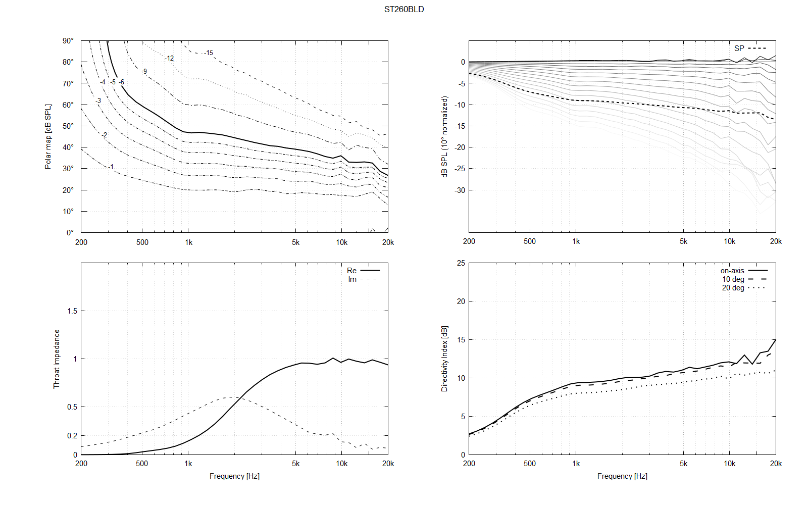

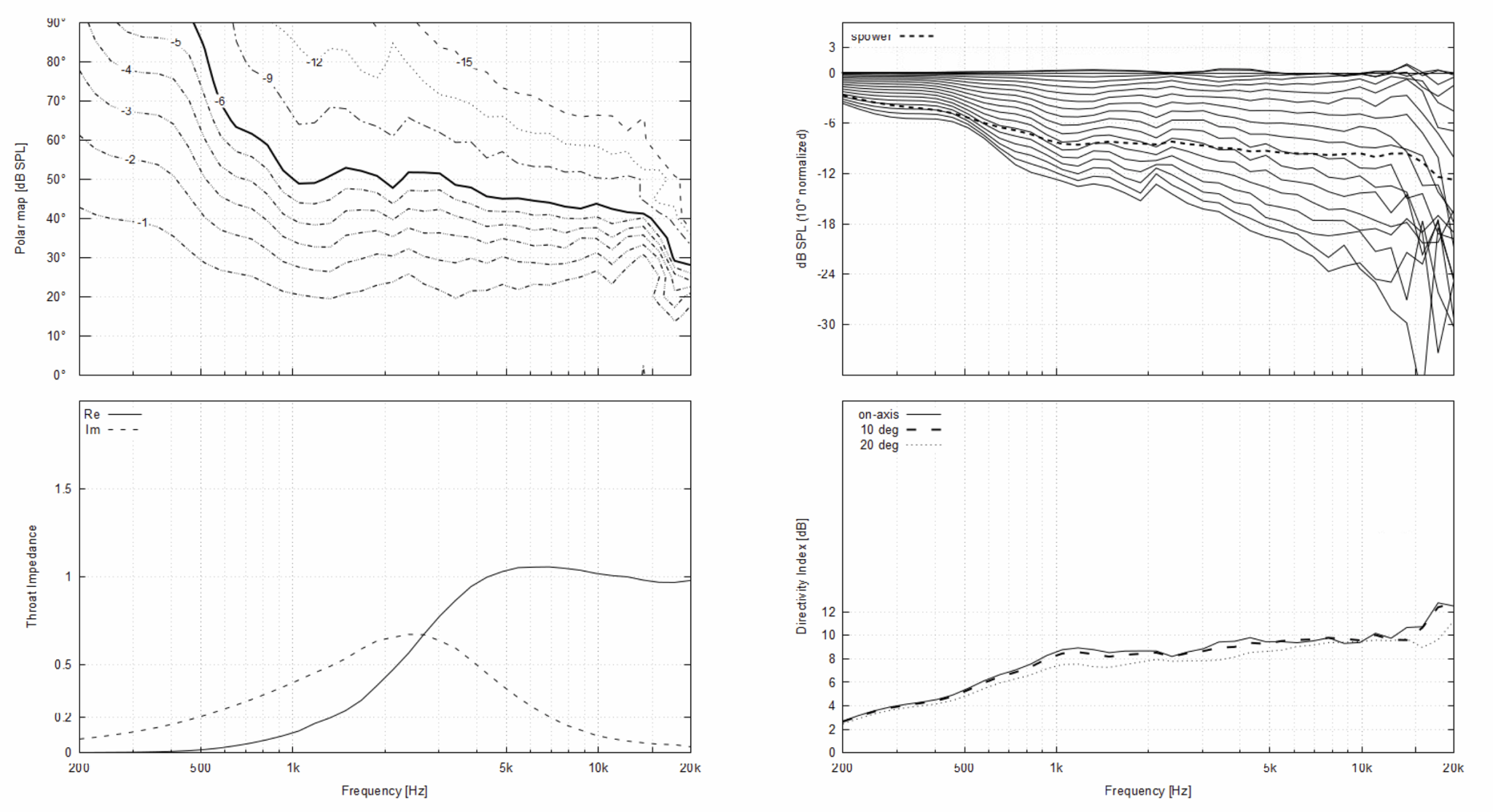

For an axisymmetric horn there's of course no need to do it with a full 3D mesh.
In a CircSim mode (ABEC.SimProfile = 0), to add a field insert something like this into observation.txt:

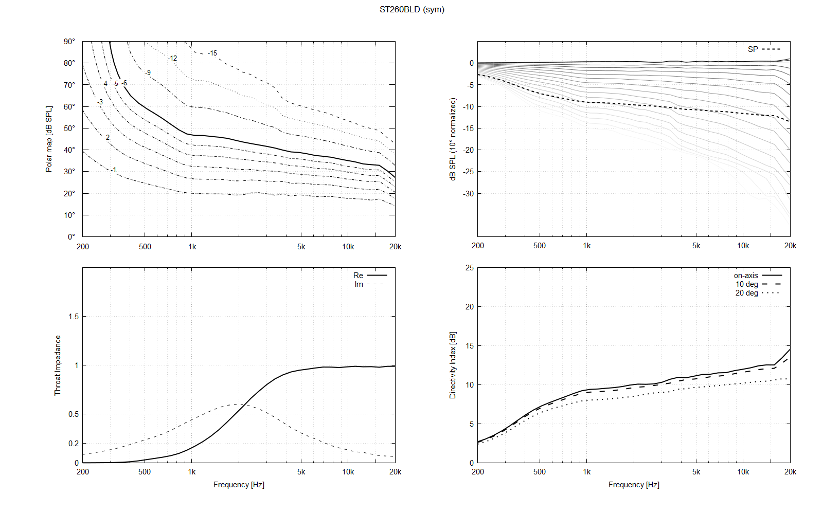

- BTW, this is the same waveguide solved as a full-3D mesh (~2700 elements) and in CircSym mode:
nope, also rubbish.Did the spectrum solve and display correctly?
Then ABEC itself is the issue not how the fields were created.nope, also rubbish.
ABEC in later versions of Windows seems to be unstable, changes to compatibility mode and changing the NUC settings and restarting have worked. I find it is handy to check something quick to see if it solves properly before wasting time on generating rubbish.

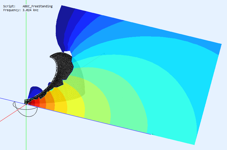

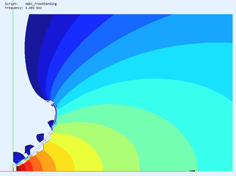

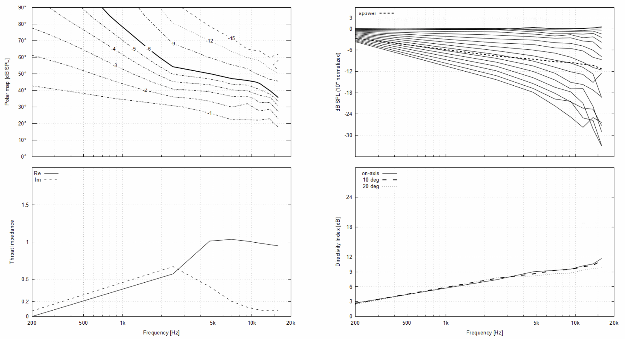

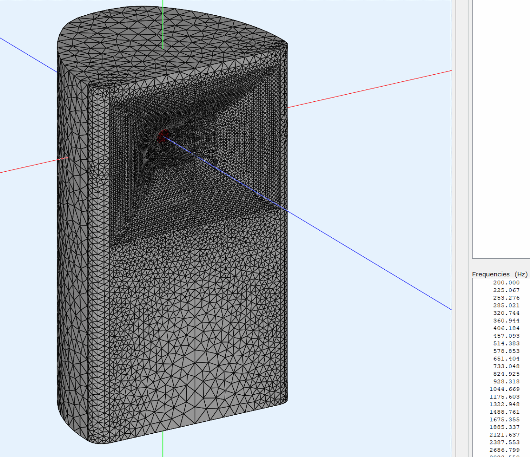

Iteration of my shaped cabinet with "WG v.4 - The Rising DI"
Linear DI +4dB 1k to 10k
Charts are wg in cabinet only - no LFSource
1st watt friendly design
Initial look - 10 points with following settings. Running 40 points over night.
Code:
Mesh.AngularSegments = 100
Mesh.LengthSegments = 24
Mesh.CornerSegments = 5
Mesh.ThroatResolution = 2.5 ; [mm]
Mesh.MouthResolution = 7.0 ; [mm]
Mesh.InterfaceResolution = 7.0 ; [mm]

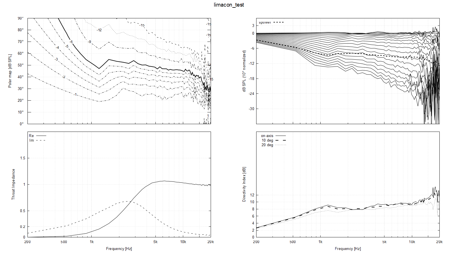

I see 8 points, linearly spaced between 200-16000 Hz, i.e. with 2257 Hz step between them. This is way too low, as there's almost no data below 5 kHz.
- One feasible option is to reduce the mesh resolution considerably and repeat the calculation for the lower (<5k?) band only, with a higher number of points and with log step.
These are still nice results
