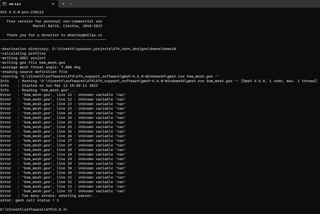

success when converting back to gmsh version 4.6 and ath4.7. Now i can play, wanting to design some rectangular throated horns for AMT's, so will be trawling back through the 597 pages some someone who's done it before. Hoping to improve on the ones i built using super ellipses and an OS expansion.
Been playing further - looks like its the version of gmsh - that was the challenge. Running latest version with gmsh4.6 on a few of the examples fine. I have tried running a example file of danibosn's for a rectangular throat. https://www.diyaudio.com/community/threads/acoustic-horn-design-the-easy-way-ath4.338806/page-512 However it doesnt like the syntax of some of the commands in the file - ignoring them and still running, generating a profile that looks like a vase. Can throat adaptors only be implemented in the beta version 4.9... ?

No, but I think Gmsh uses its own global config file, and as this is not explicitely defined in the .geo files, it can change the default behaviour. See if Mesh.Binary=1 is set somewhere. Or you can try to insert this (Mesh.Binary=0) into the .geo file generated by Ath and then run gmsh manually.

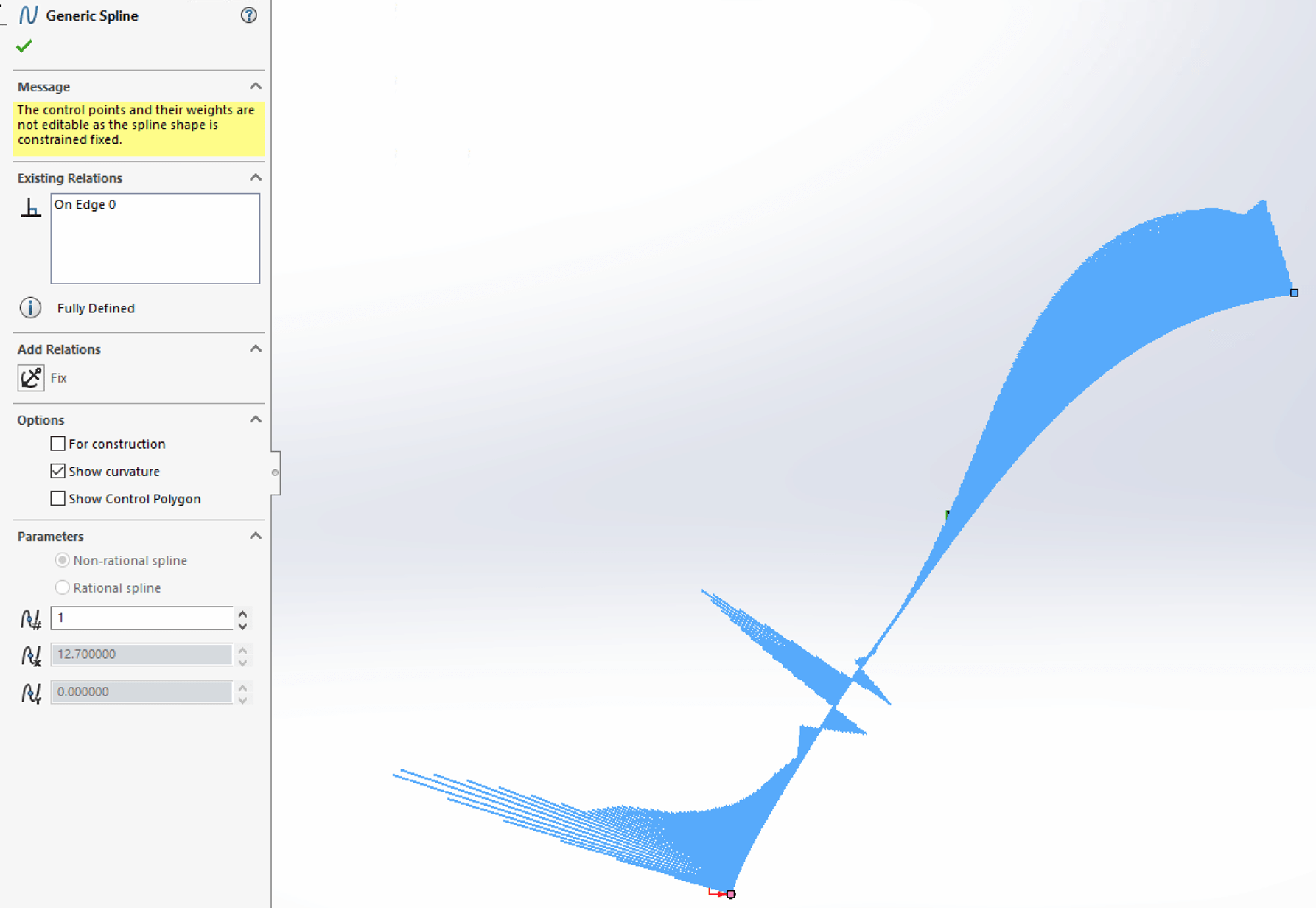

In Solidworks we have "curvature combs" - do you know of a similar feature for gnuplot? Sometimes the horn adaptor interface area has inflections due to bad config numbers. I'd like to plot the curve to see curvature before I splend time importing.
guess something could be done with plot 'coords.txt' but I am uncertain on the name that gnuplot would call curvature or spline combs if it had that at all.

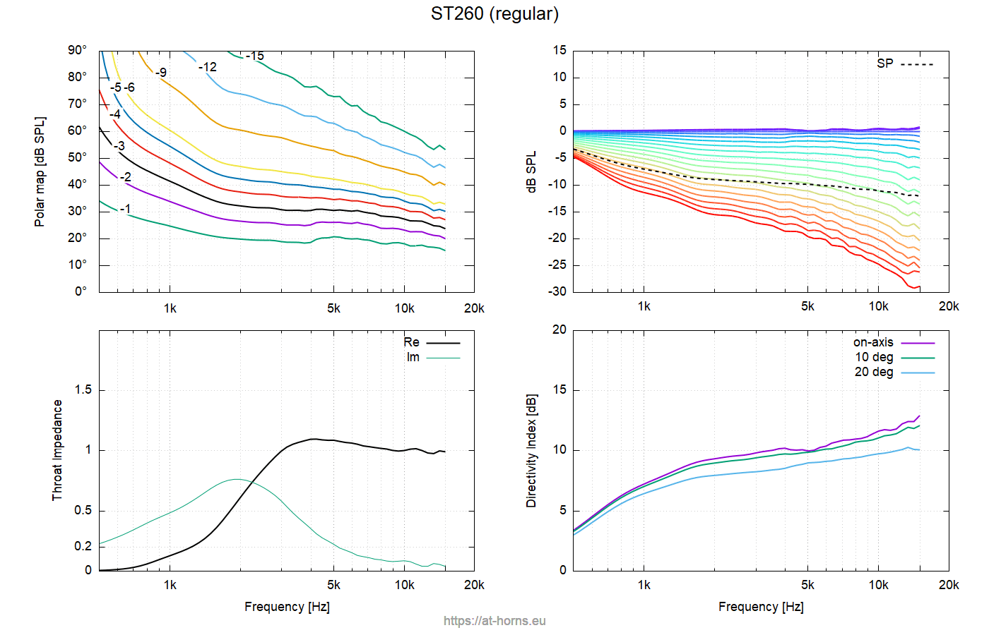

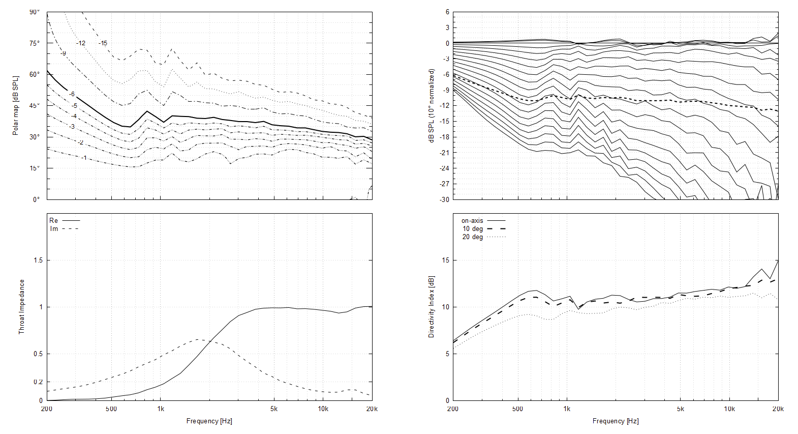

That's a very pretty gnuplot setup. Can you share the script?Just to stay within context, this is the regular ST260 (again) -
("SP" is the equvialent total radiated power, i.e. a FR of a point source radiating the same total power.
The on-axis ripple can be further eliminated, as was shown before, that's not addressed in this model.)
- I keep using it because it's small enough not to take a long time to calculate, yet it still covers all the design aspects.

I have been learning to use ATH through the examples in the user guide document. It has been a fascinating journey so far.
I have tried out the first nine demos, but when I tried the demo10.cfg, which is supposed to consider the scenario where a dome tweeter is placed on an infinite baffle (I think) I am getting the following errors:
I used the following .cfg file (demo10.cfg)
Throat.Profile = 1
Throat.Diameter = 25 ; [mm]
Throat.Angle = 7 ; [deg]
Coverage.Angle = 45
Length = 0 ; [mm]
Term.s = 0.5
Term.n = 4.0
Term.q = 0.996
Source.Contours = {
zoff -2
point p1 4.68 0 2
point p2 0 14 0.5
point p3 1 15 0.5
point p4 0 16 0.5
point p5 0 17 1
cpoint c1 -18.59 0
cpoint c2 0 15
arc p1 c1 p2 1.0
arc p2 c2 p3 0.75
arc p3 c2 p4 0.25
line p4 p5 0
line p5 WG0 0
Source.Velocity = 2 ; move in axial direction
Morph.TargetShape = 0
Mesh.AngularSegments = 64
Mesh.LengthSegments = 1
Mesh.ThroatResolution = 2.0 ; [mm]
Mesh.InterfaceResolution = 2.0 ; [mm]
Mesh.InterfaceOffset = 5.0 ; [mm]
ABEC.SimType = 2
ABEC.f1 = 1000 ; [Hz]
ABEC.f2 = 10000 ; [Hz]
ABEC.NumFrequencies = 20
ABEC.MeshFrequency = 1000 ; [Hz]
ABEC.Polars:SPL = {
MapAngleRange = 0,180,37
NormAngle = 10 ; [deg]
Distance = 3 ; [m]
Output.SubDir = "demos"
Output.STL = 0
Output.ABECProject = 1
Have anyone seen this error before? Can you help me with figuring out what is wrong.. ?
