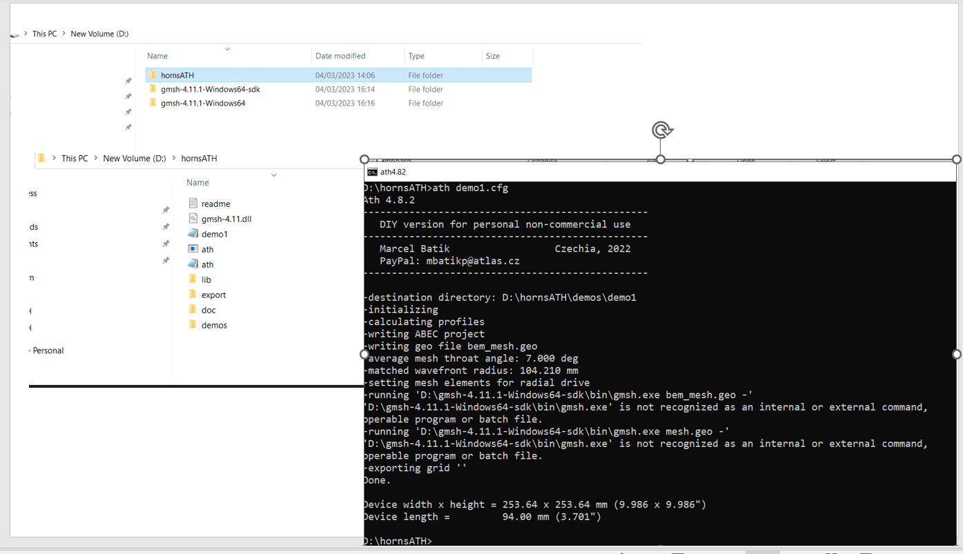

Looks like you have put a gmsh dll in the folder. There is a text file called ath in that folder where you need to specify the path to the the gmsh executable, I would also go with an older version of gmsh as a safer bet, I use 4.6.0, this is what is in my text file. I use the C:\ drive as I don't have a separate drive or partition.
OutputRootDir = "C:\Horns\4.9" MeshCmd = "C:\gmsh-4.6.0-Windows64\gmsh.exe %f -" GnuplotPath = "C:\Program Files\gnuplot\bin\gnuplot"

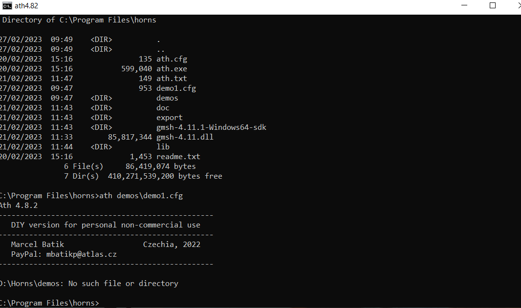

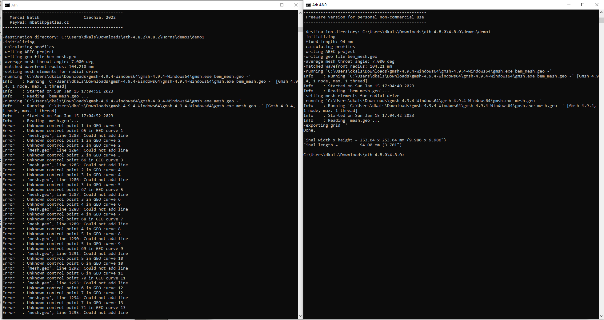

I've downloaded the latest (non-beta) version and had previously downloaded version 4.8.0 (though I never did anything with it back then). I'm currently getting the following error in Version 4.8.2, but 4.8.0 works - running the exact same demo1.cfg file.
Any thoughts on what I may be doing wrong?
