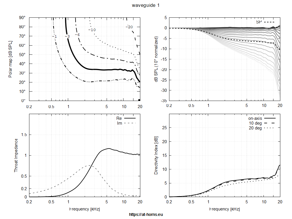

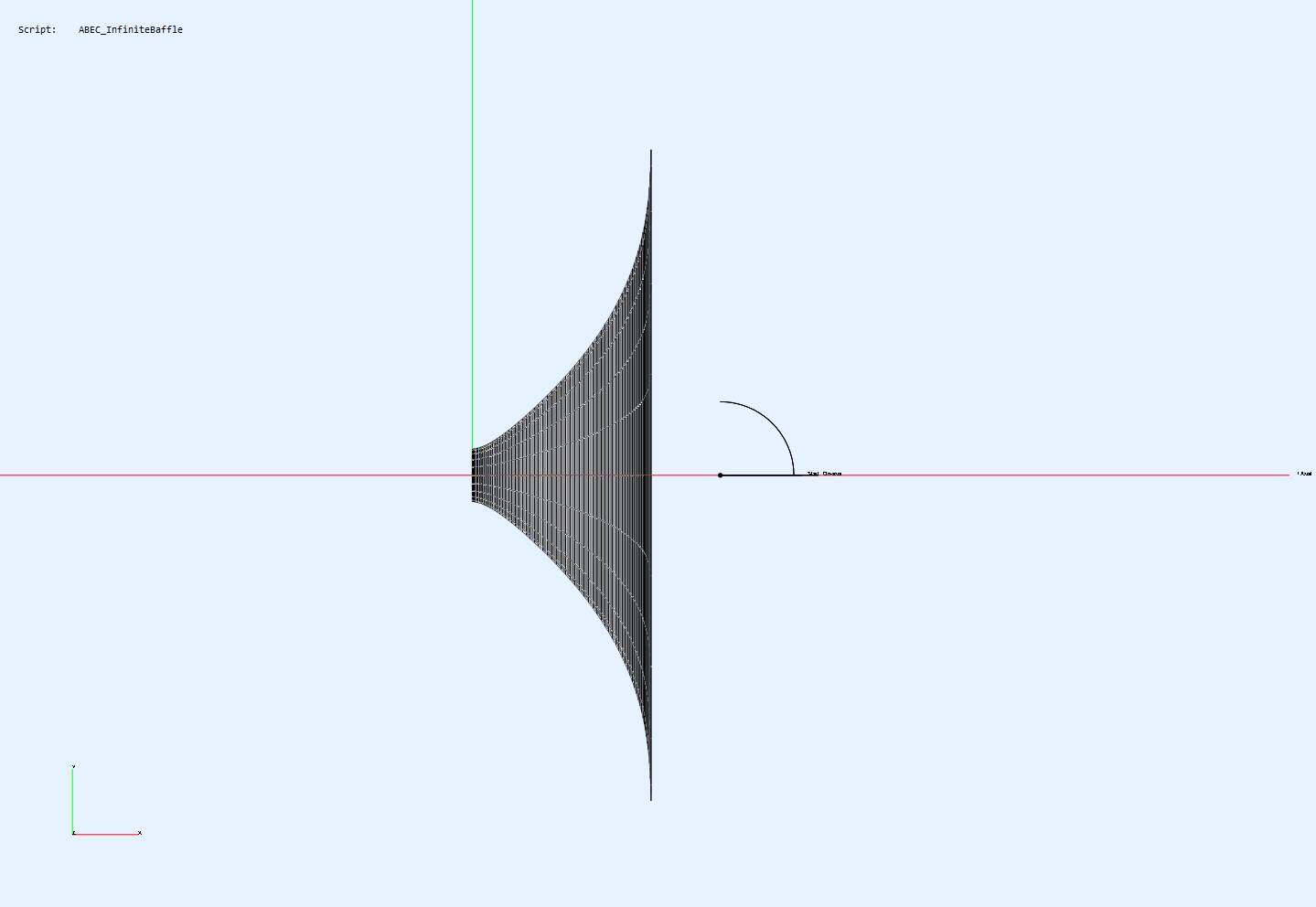

How do I have to interpret cut-off frequency for a waveguide with an ath report? This is a report for a waveguide with a diameter of 315 mm, baffle-mounted. If I use the -3 dB polar as a guideline, it looses pattern control already at 2 kHz, making a 1.25 kHz xo-point infeasible. I was not expecting this due to the good size and to me, there are three possible explanations:
1) because of the extended termination in comparison to many similar sized commercial waveguides, pattern control is actually lesser.
2) the widening of the pattern is also present with similar sized commercial waveguides with which the diy scene has gathered experiences before, but is usually mitigated by the reduction of SPL by a crossover point that is slightly below the widening
3) Actually, the -3dB polar pattern is not that strict. The ankle where it shoots up is not most important.
Can you help me out?

The widening below 2 kHz is due to the infinite baffle. The beamwidth will get narrower when put into an enclosure (which is what Ath can't do at the moment). Forget about cut-off frequency.
For freestanding waveguides, it shows the final results, full space. For baffle mounted waveguides, there's still this limitation.

The widening below 2 kHz is due to the infinite baffle. The beamwidth will get narrower when put into an enclosure.
Does this also mean that a compensative widening in the transition area above 2 kHz is advised?
No, this is already pretty good and in a real baffle it will get only better, regarding the global DI curve. There will be some diffraction off the edges, of course, but there's nothing more you can do about it at this point.

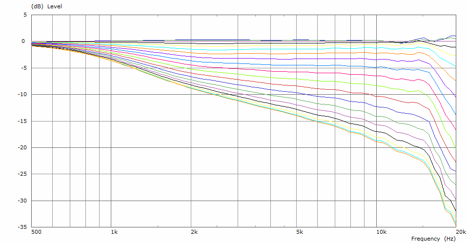

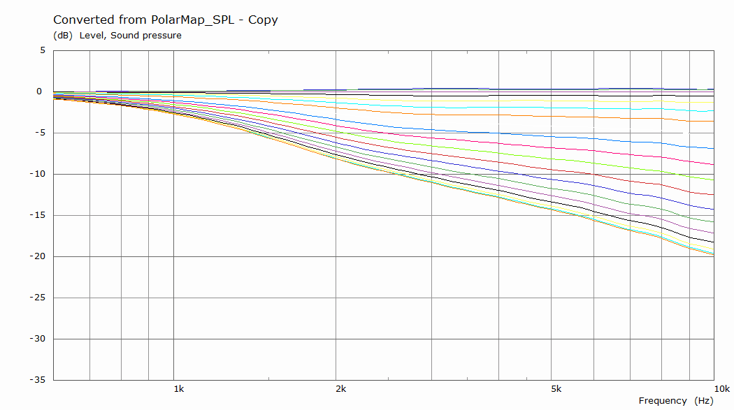

Here are two examples of the difference between the same waveguide in an Infinite Baffle vs a Finite Baffle. If you want to know more accurately what you will get then a 3D sim is necessary with a baffled waveguide.

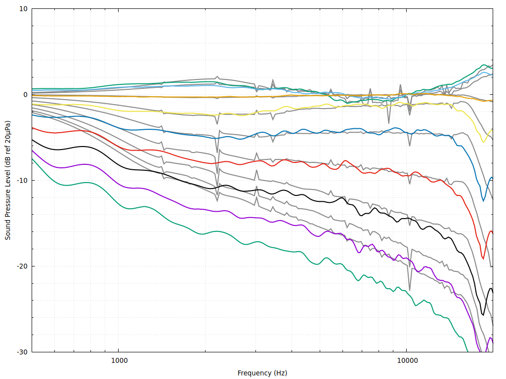

No, that area won't change much. Here's some data I posted last year:
Grey is simulated with an infinite baffle. The colorful lines are measured data in an enclosure (see this post for more info on my speaker build). Ignore the small glitches in the simulated curves.
I also compared my measured curves (same as above) to a simulated cylindrical enclosure in this post.
