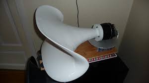

Here's an Iwata horn
Here's a JBL biradial, definitely some similarities to Iwata
Here's how you might be able to simulate Iwata in ath:
First of all, take a look at page 35 of the manual. In there, you can see that it's possible to vary the beamwidth of the waveguide based on the angle.
Once that makes sense, you'll realize you can also vary the LENGTH of the waveguide based on angle. For instance, you can have a waveguide that's longer on the Y axis than it is on the X axis. And once you do that, you can begin to approximate an Iwata horn. Keep in mind that an Iwata and a JBL biradial horn are basically based on circles and spheres which are rotated about the axis of the horn.
Having said all of that, my current project uses a horn that's biradial-ish, and I had to design it in plain ol' 123D, because I couldn't come up with a satisfactory solution in ATH. (I tried.) (https://www.diyaudio.com/forums/multi-way/374570-nightmare-labor-day-10.html#post6762519)
One of the tricky things about ATH is that if you start go manipulate the parameters to come up with weird shapes, the waveguide can't be terminated on a flat baffle.
IE, if you managed to make something like this using a formula, there's no way to attach it to a baffle:

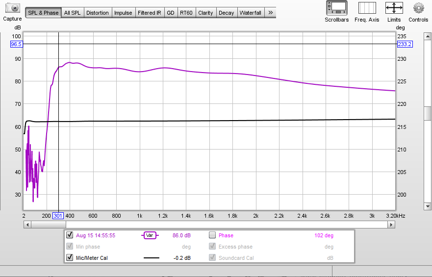

I am pretty satisfied with my Iwata-220. Sound more open and less like a well/barrol than my Kugelwellen round horn. Now it handles 300-2500Hz, but plan is to use a iwata 600 from 1400Hz, according JMLCs own design. To lowpass the dirty woofer already at 300Hz is a blessing.

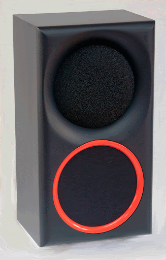

Is there a way to model the response when a freestanding axisymmetrical waveguide is “interrupted” when the axisymmetry is “carved into” to decrease the center-to-center spacing? Though the attached shows a baffle-mounted waveguide, the image should suffice for clarification
I don't think it's possible with Ath in the current implementation. You would have to do it manually.
You can see my best attempt at a "manual" simulation starting here 2 way waveguide speaker build ABEC modellingIs there a way to model the response when a freestanding axisymmetrical waveguide is “interrupted” when the axisymmetry is “carved into” to decrease the center-to-center spacing? Though the attached shows a baffle-mounted waveguide, the image should suffice for clarification
The woofer is simulated as a rigid boundary which is not completely correct so the diffraction effects and spikes are exaggerated but you can see that it does nothing good to the waveguide pattern. The CTC distance needs to fall in the right range either under a 1/4 up to 1/2 a wavelength at crossover or then 1 to 1.4 becomes better when you consider power response and DI smoothness.
The idea that closer is better is not always true so it depends on the overall design if that tradefoff is worth making.
With a freestanding guide it would make more sense to hang the waveguide out and in front of the woofer so the waveguide is in the way of the woofer rather than the other way round if a reduction was needed to make the overall design work better.
You don't need to carve into the waveguide; just mount the woofer from the rear of the baffle...Is there a way to model the response when a freestanding axisymmetrical waveguide is “interrupted” when the axisymmetry is “carved into” to decrease the center-to-center spacing? Though the attached shows a baffle-mounted waveguide, the image should suffice for clarification
