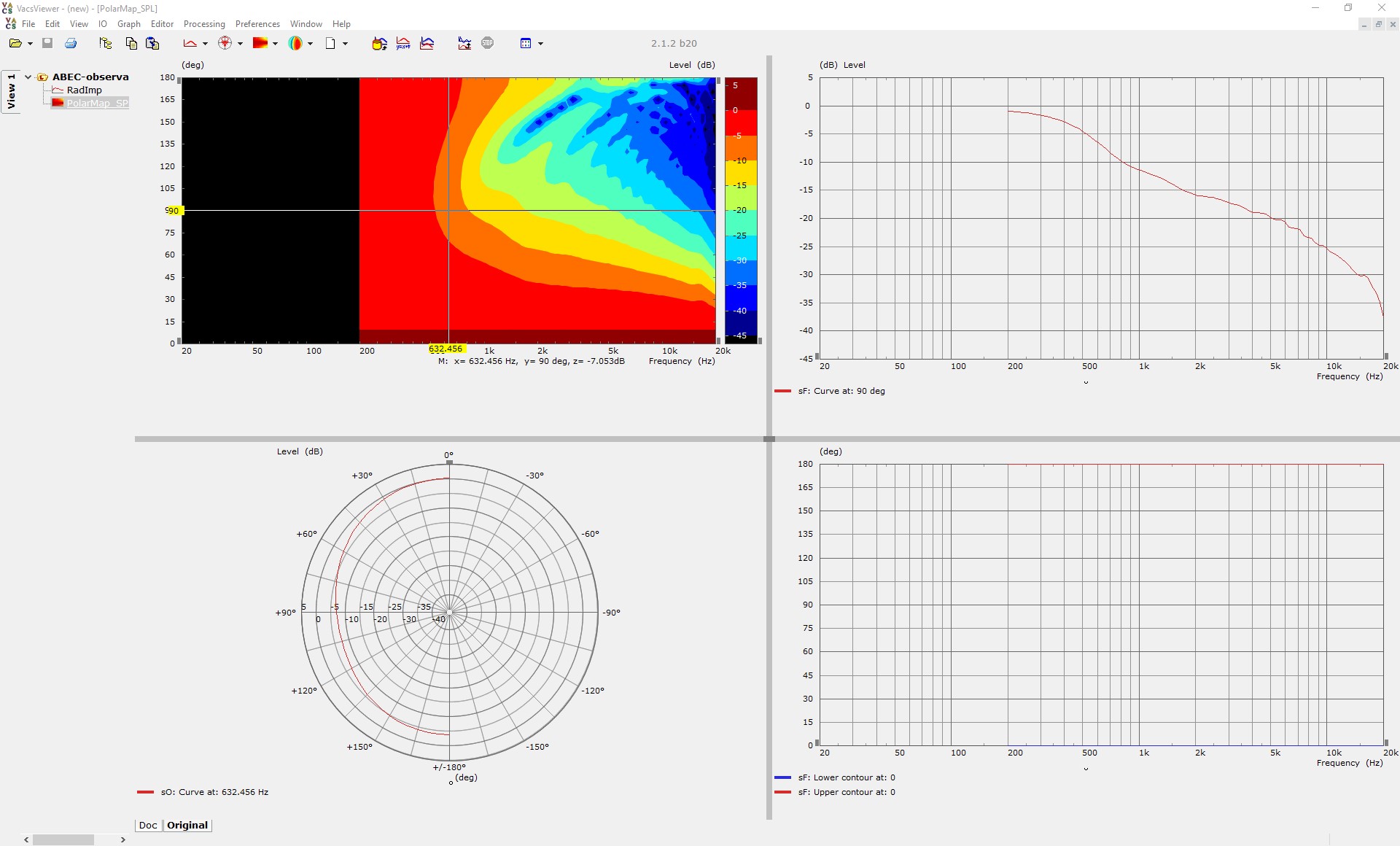

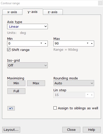

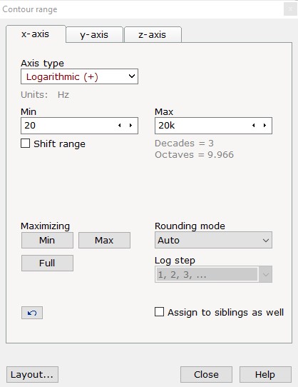

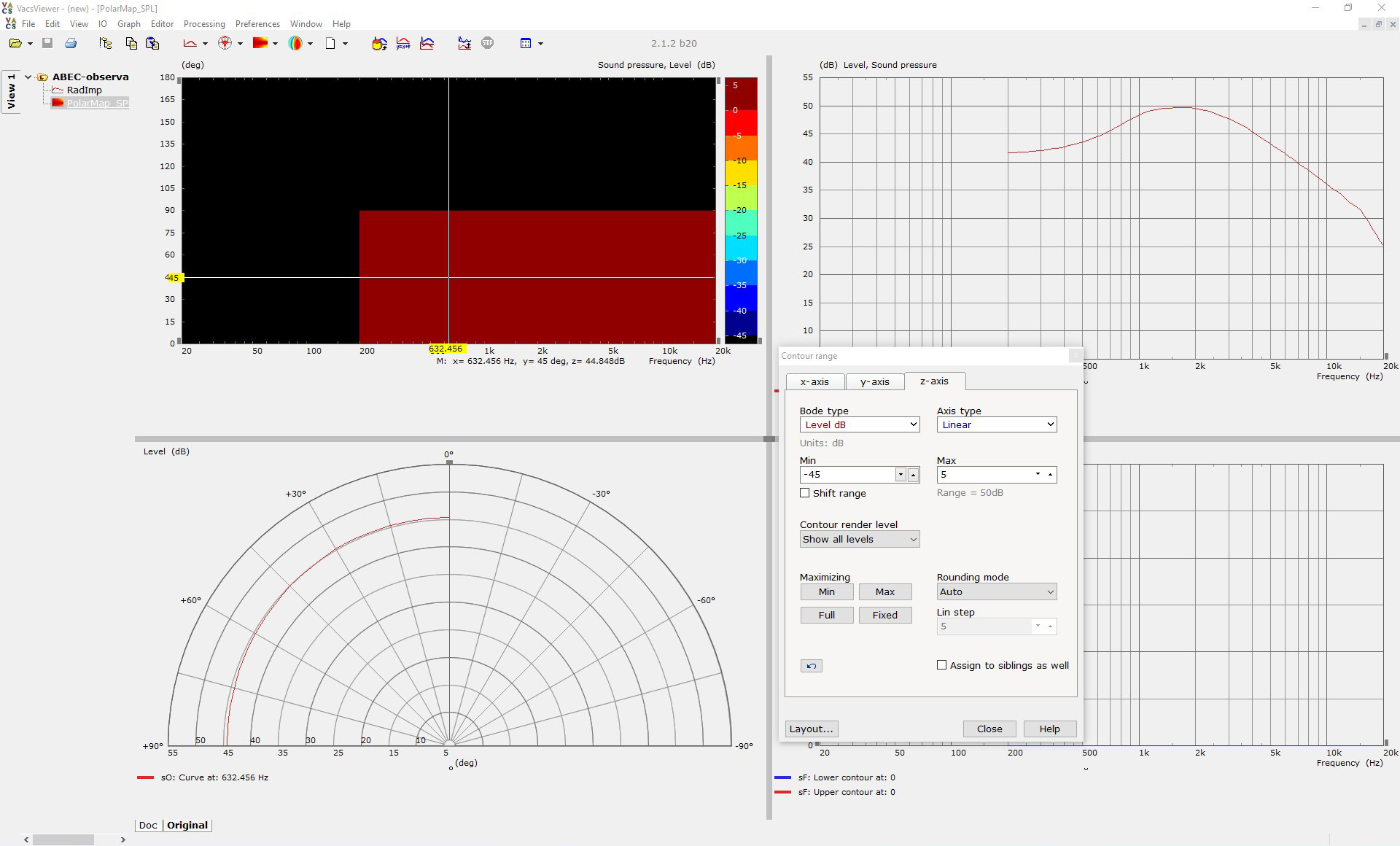

Thanks, I will try. Something I do not understand yet is the VACS output of both your ST260B and Tritonia, compared to ST260. The latter looks as expected and I thought it is something about the range settings, this is ST260:

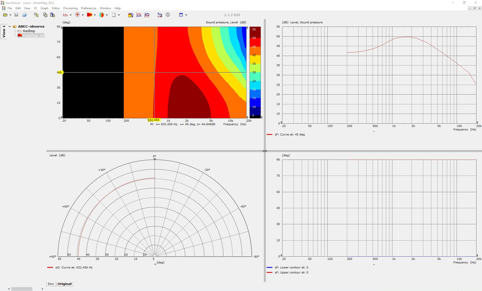

This is ST260B, and Tritonia looks the same but renders half an hour on my machine, so only ST260B is shown.

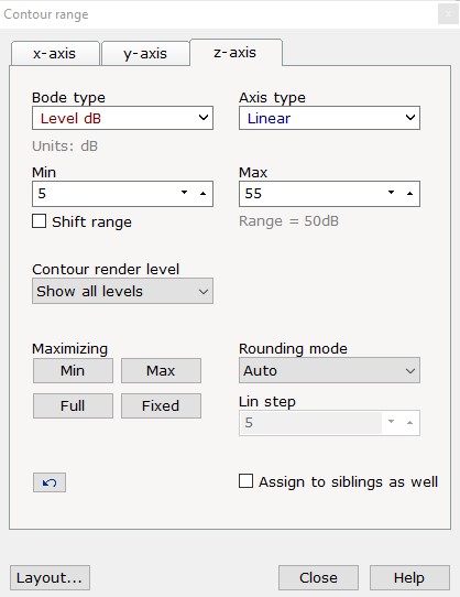

The range settings differ from ST260, where y-axis is 180 and z-axis is -45 to 5 dB. So I thought it be smart to change range settings and here is the result:
Hm ..
Hm ..
The Tritonia plot is not normalized so you should keep the "absolute" range 10 - 55 dB (or so). You can also convert the polar map to individual SPL curves by "Graph - Convert curves <-> contour", you'll see this clearly in both cases. You can set an angle for normalization as "NormAngle" in the "Polars" item(s) in the Ath script, depending on what you prefer.
Most of the time I normalize plots to 10 deg off-axis (as the ST260 here) but there are many situations where you may want to see an unnormalized plot.
(Normalizing to 10° means that everything is plotted relative to the frequency response at 10°. Which means that the response at 10° itself is shown perfectly flat, the same way as if you equalized the device to be perfectly flat at 10°.)

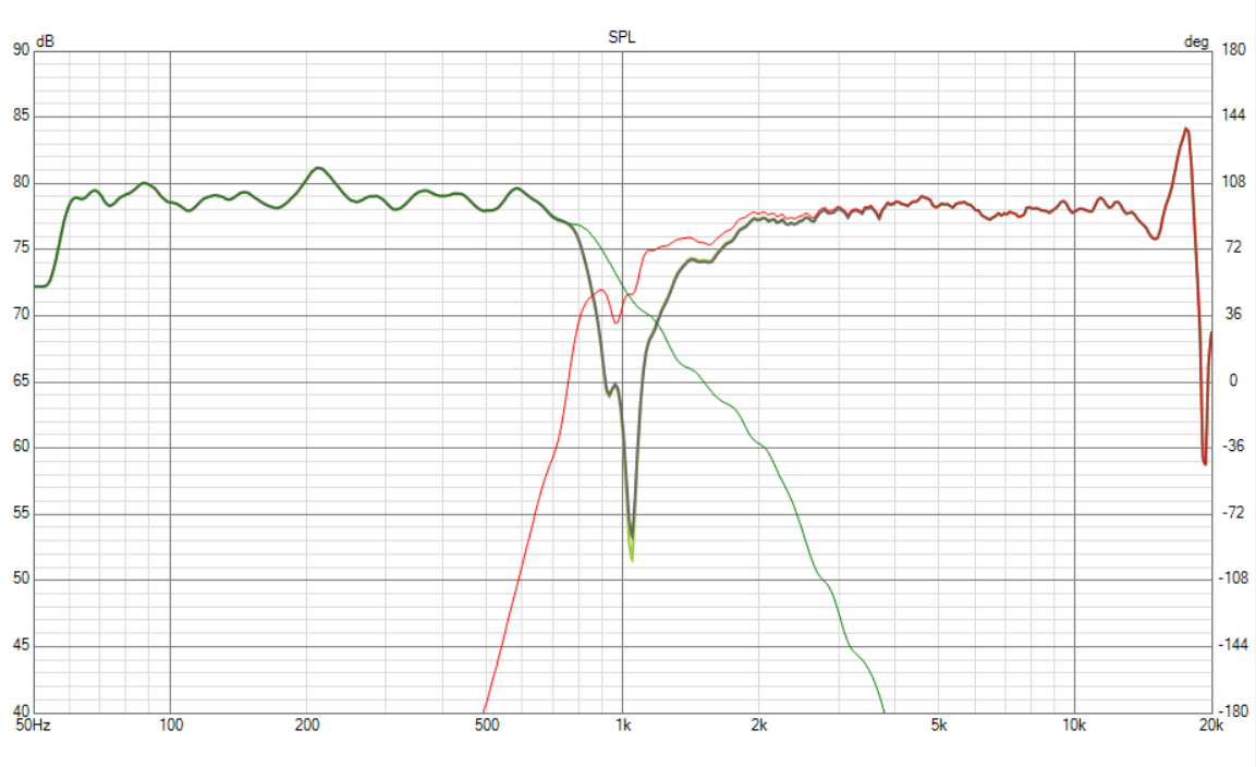

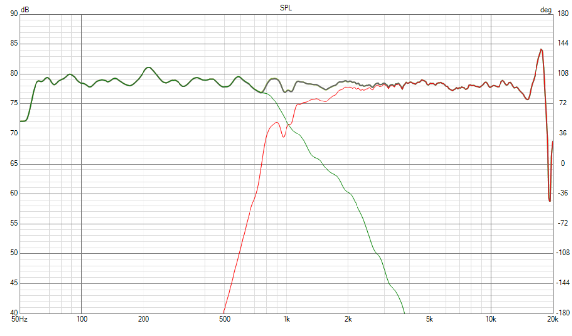

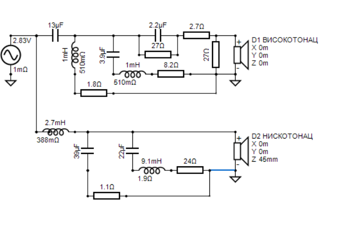

I would be a little concerned and probably would try to tame the driver resonance around 850 Hz. That should not add too much cost to the crossover. Otherwise it looks quite good, IMHO. You don't design the filters with the complete radiation pattern in mind?

I do not want to drift off-topic and allow myself one more remark, though zvu might have read this before. Maybe consider to shelf the HF response of the constant directivity horn. I have done it with my current DSP-speaker but not methodological and am still interested on a more thorough grounding. But here is what Earl Geddes wrote about it: https://www.diyaudio.com/forums/gedlee/264303-na12.html#post4247969 Could be that a flat FR is not desireable, but I have not systematically worked this through.
......... You don't design the filters with the complete radiation pattern in mind?....
We actually do consider radiation pattern. Lemme explain.
First we measure midwoofer 0 to 90 degrees then the tweeter (i showed tweeter measurements in this thread before). That helps to determine on axis to off axis consistency, direectivity and where the crossover points should be. Averaging those curves shows if there is a sound power problem (sudden dip or a peak that needs attention and is not directivity related). Then, we take separate measurements of tweeter and woofer on axis and roughly 40 degrees off axis. I say roughly because what you really need to do is compare power response (derived from 0-90 horizontal) to measurement at off axis angles. When you hit matching response/tilt, you pick that curve for simulation of off axis response. So two sets of measurements:

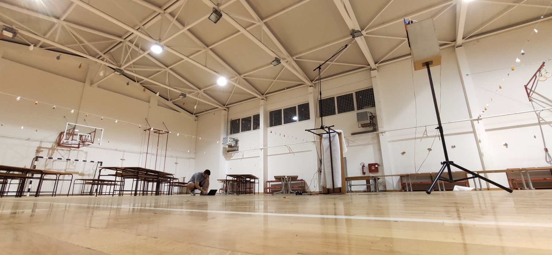

But behind all of this a question resides - why the f*** don't we do dual channel measurements and use VituixCAD ? Measure 360 degrees H and V in 10 deg increments would tell us everything and now, right
Well... Measuring at 3m height to be able to obtain such a high resolution measurements (to be able to actually see what happens in first six-seven octaves without too much software smoothing) does come with some caveats. One of them being a jig with rotation axis right at front baffle plain, that is high enough, stable enough and low diffraction. We have few ideas about how we could do that but (for now) it's just plans. We've made test cabinets that weigh about 40-50 kg each. You need to climb it on a 3 meter height and to be able to rotate it stably. If you look at the pic i posted before, you'll notice that we made speaker stand extension rod with welded plate on top. That plate with extension pipe is screwed on to the test cabinets. That was done on ground and we then lifted the speaker up in the air.
