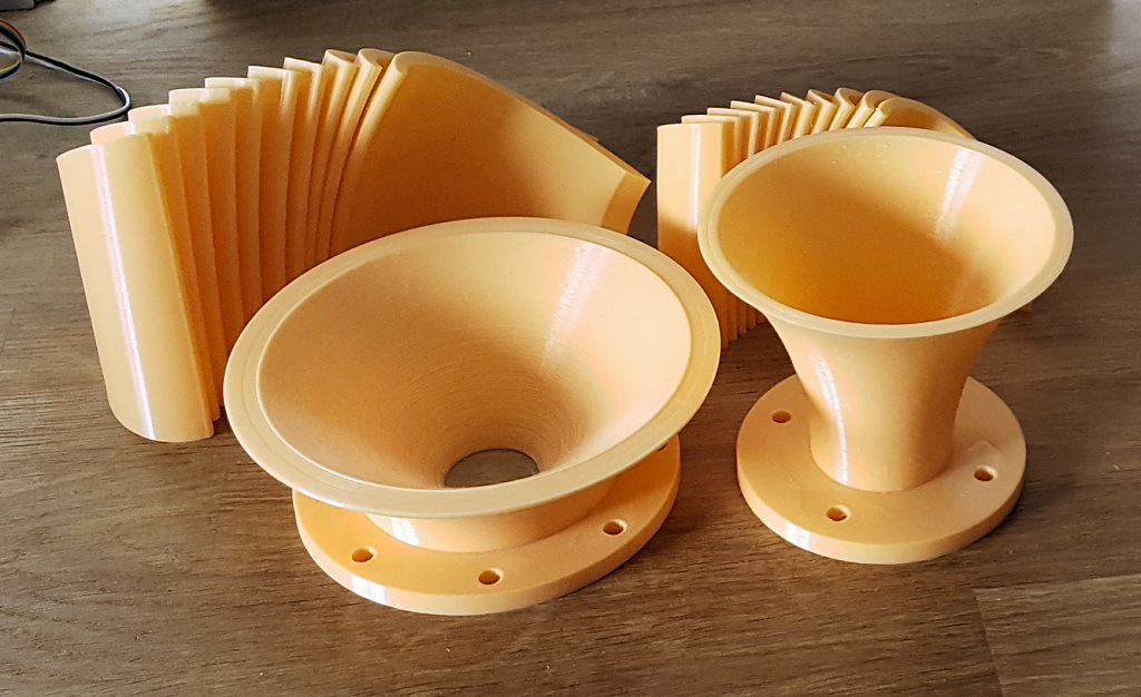

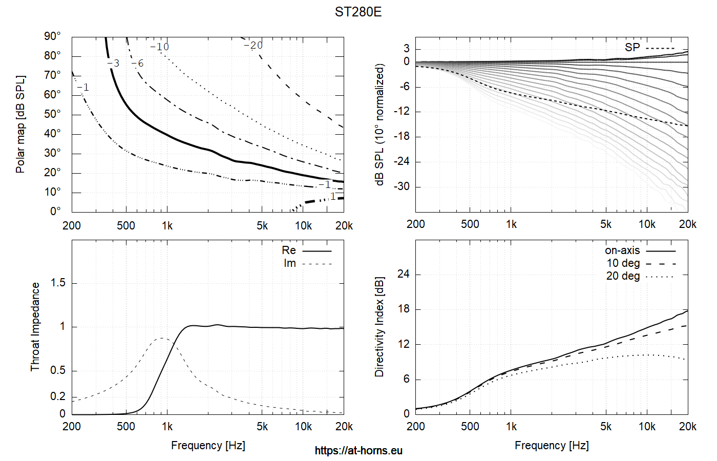

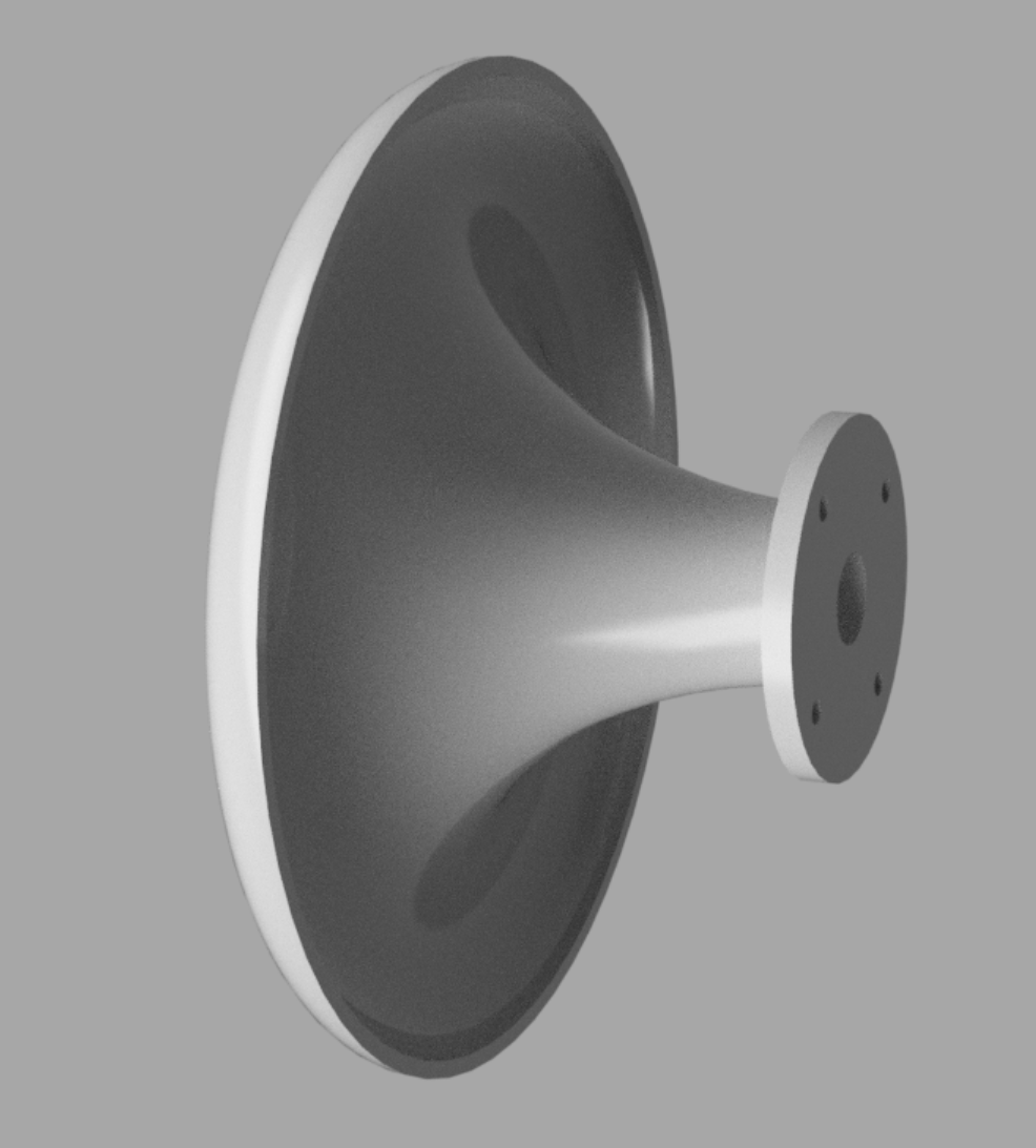

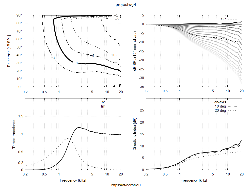

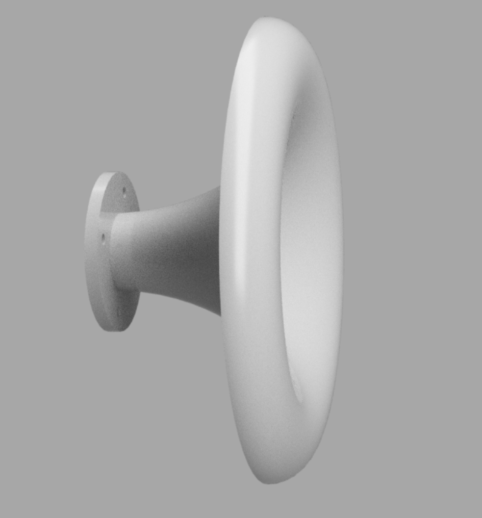

Out of fun I prepared something a little different, for those able to print it cheaply: ST280E (STL+STEP)
Would love to hear some listening impressions one day, especially compared to the ST260.
⌀284 x 130 mm, 1" throat / 13.5° total included angle.

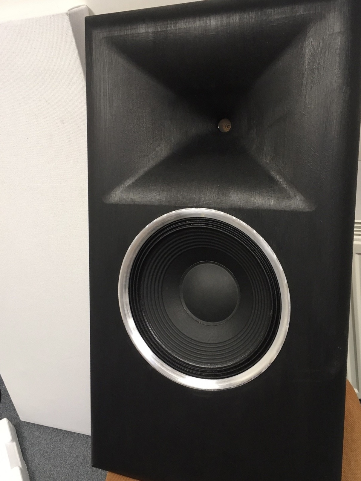

Thanks again mabat!

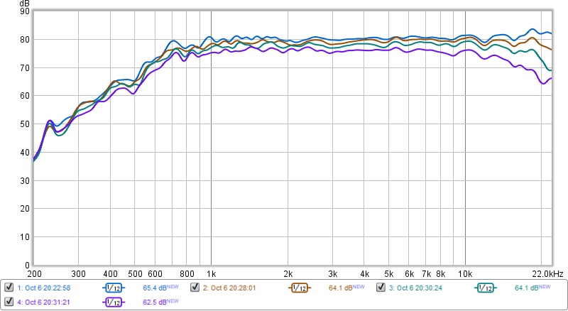

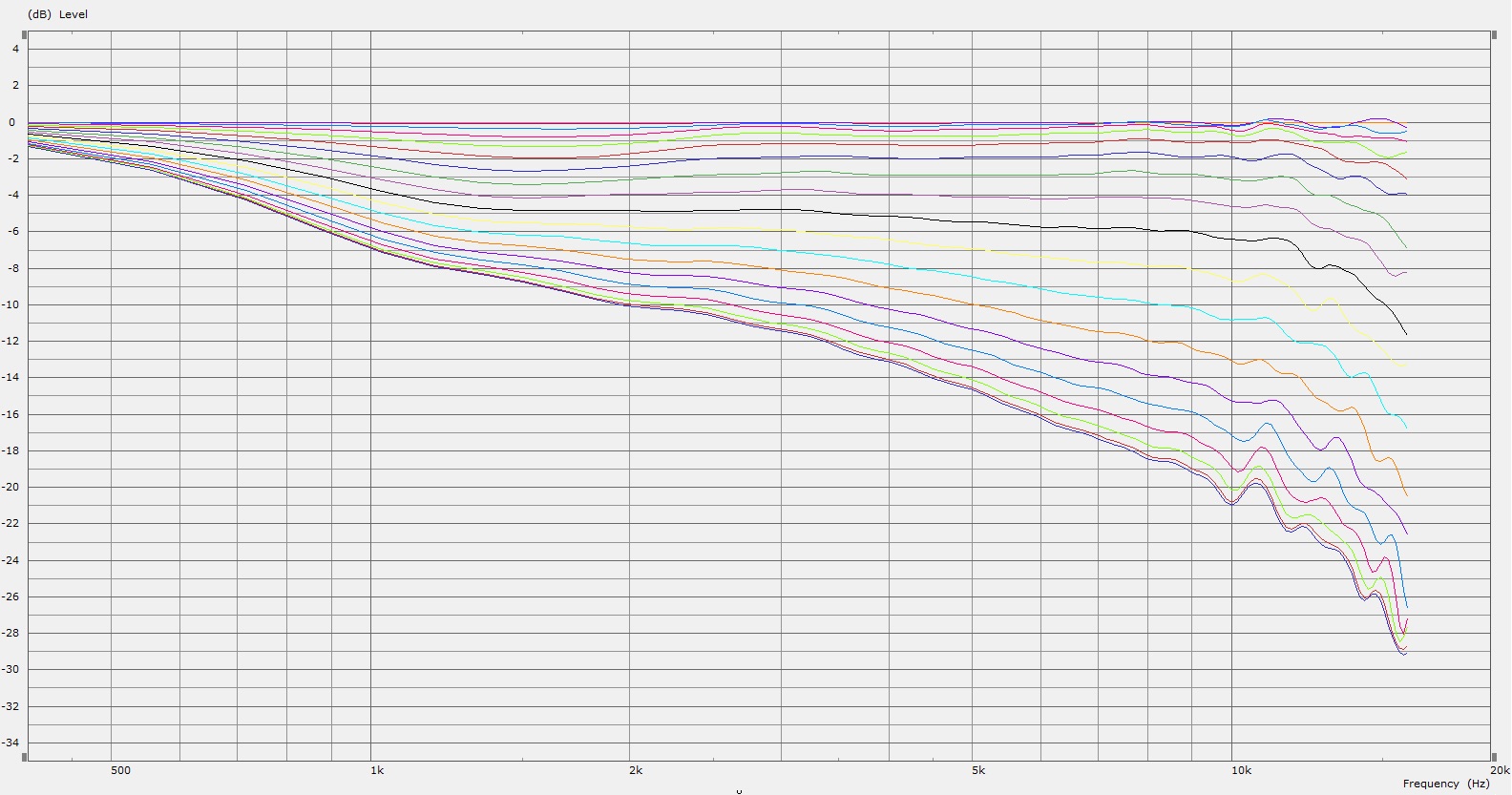

I’ve been listening to my custom waveguide, HF10AK + 12P80ND combo for a few months now.
Off-axis is sublime. I’m overjoyed with the result.

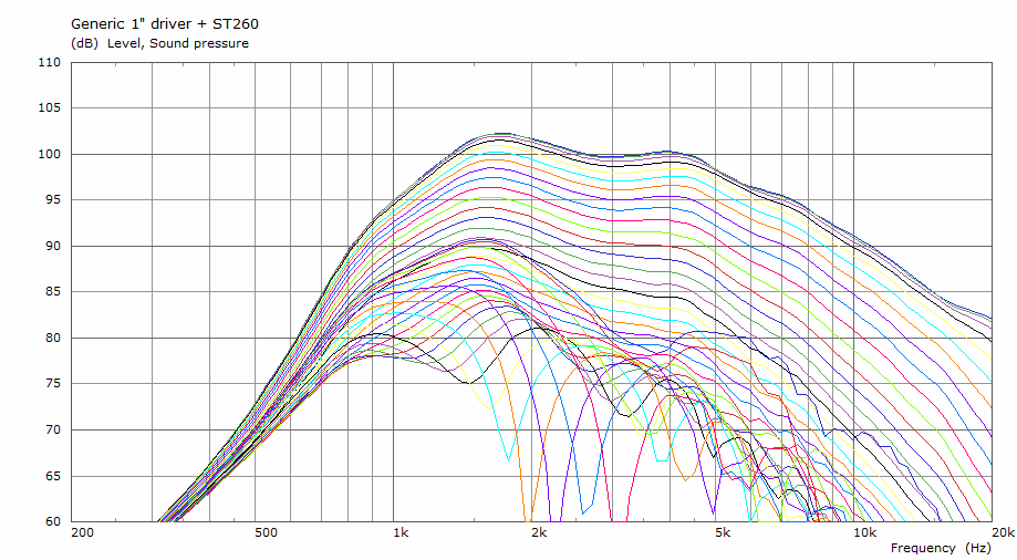

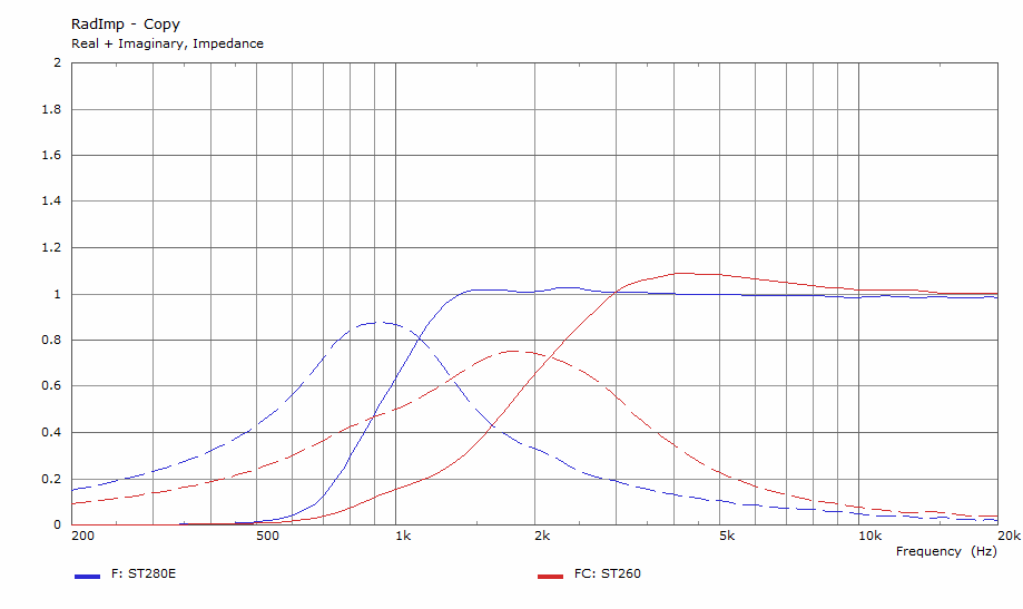

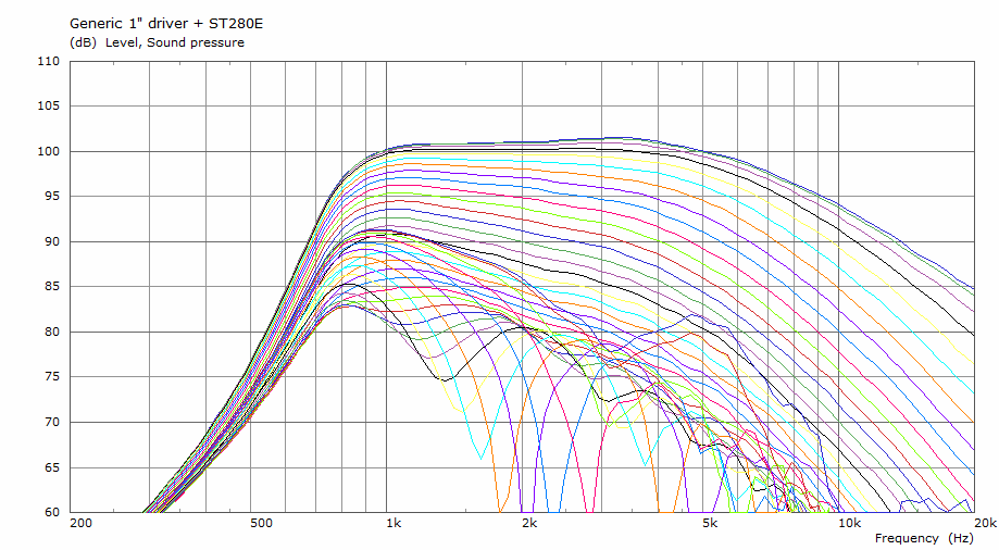

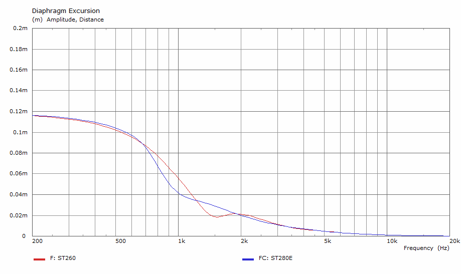

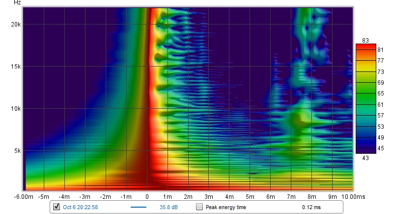

A direct comparison of the ST260 and the ST280E, using a generic 1" driver model.
Here's the driver LE model:
Def_Driving
Value=2.83 IsRms
Def_Driver 'Drv1'
dD=44mm
Mms=0.8g
Cms=30e-6m/N
Rms=3.0Ns/m
Bl=7.5Tm
Re=6.3ohm
fre=35kHz ExpoRe=1
Le=0.1mH ExpoLe=0.618
System 'S1'
Driver 'D1' Def='Drv1' Node=1=0=10=20
// Rear volume
Enclosure 'Eb' Node=20
Vb=50cm3 Qb/fo=0.1
// Front volume
Duct 'D1' Node=10=200
dD=44mm Len=0.5mm
// Phase plug (simplification)
Waveguide 'W1' Node=200=300
STh=1.52cm2 dMo=20mm Len=22mm Conical
// Conical section between phase plug and exit
Waveguide 'W2' Node=300=400
dTh=20mm dMo=25.4mm Len=22mm Conical
RadImp 'Throat' Node=400 DrvGroup=1001
