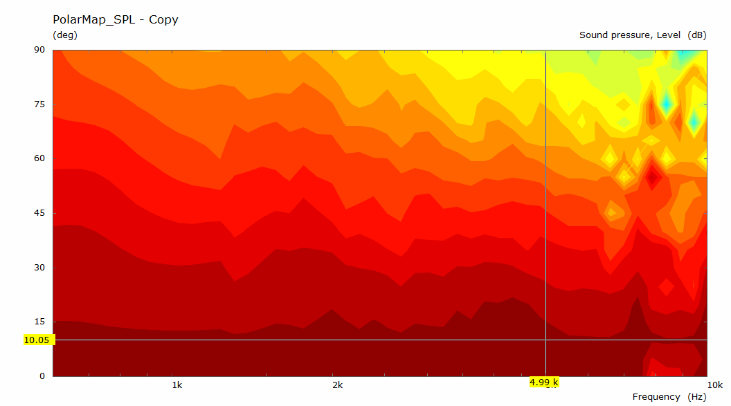

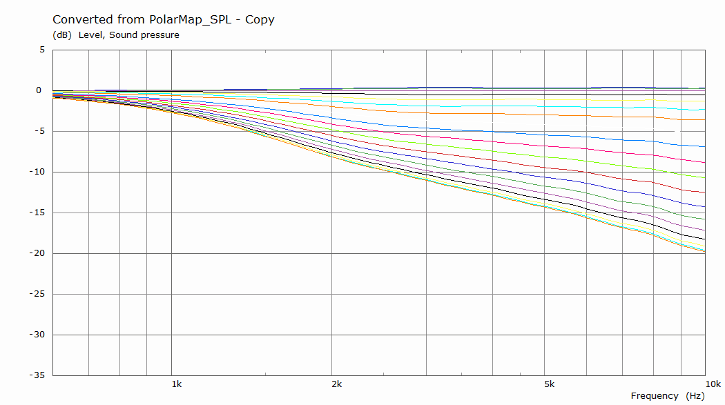

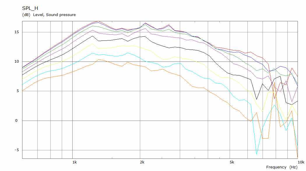

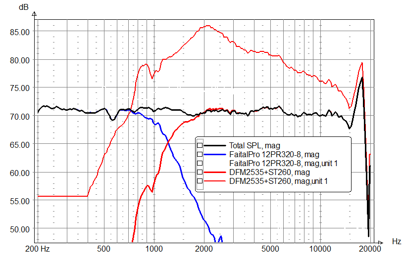

Strange. That's my thought every time i see you post something new with your great piece of freeware. Same thoughts for Kimmo's VituixCad as well. Your waveguide really makes things easy to work with. Here's maybe 1.5 hours worth of sim showing filtered and unfiltered response on axis with passive crossover and optimized for >2m listening distance:
Showing pics from LspCAD since it's easier to see or at least i'm more used to it.
Given how consistent off axis frequency response is to on axis in ST260, this will be a piece of cake once everything is in place.

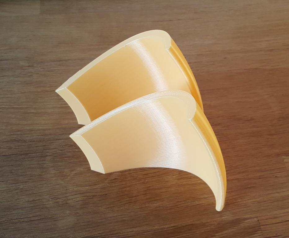

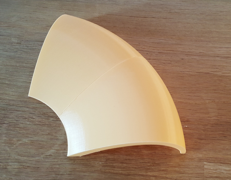

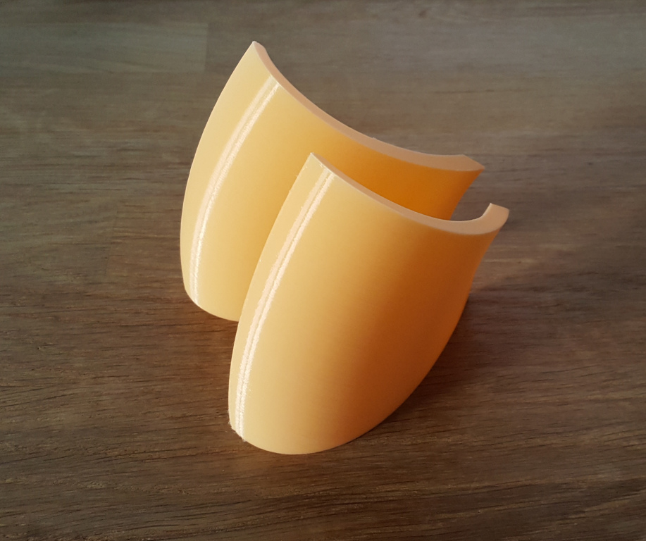

- I've tried the second cheapest filament I have in stock (the cheapest was the gray one I used so far). It's just perfect
(0.2 mm layer, 0.4 mm nozzle, printing two at a time)

Thank you very much for those sims, they were very interesting. It is fascinating to see the resonance from the waveguide cavity. I think that foam just might be a great idea to tame that. And, yes I agree with your main take-aways. What you suggested is what I have always done.
I certainly wish that I had the tools that you have now back in the days when I did simulations. But then the older gents in the business back then said the same things to me. The "art" of loudspeaker design has evolved tremendously over the decades. That's I why I just don't understand the "nostalgia" craze for old designs. Just makes no sense to me.

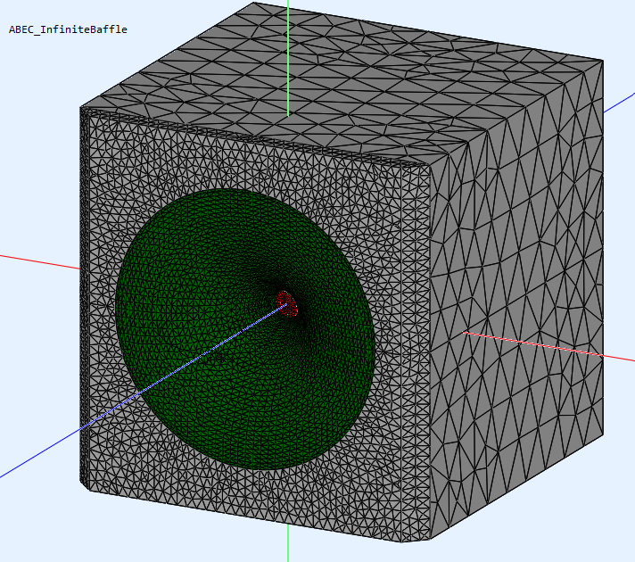

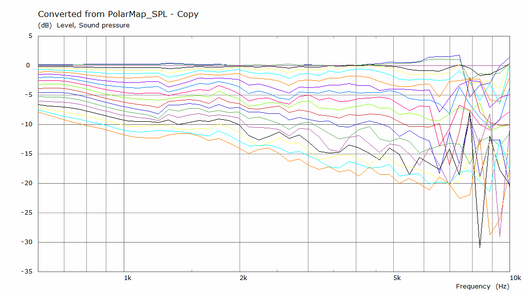

I started before I saw the edit so the enclosure was made 350mm deep. For looking at the horizontal response there is no real need to model the full baffle as it leads to needing half symmetry and a lot more elements which bogs the sim down considerably.Let's do 40cm depth.
So w*h*d-35*100*40.
This is what was simulated. Cutting the waveguide into the baffle was more difficult than usual and I used the interface mabat generated. These 3D combinations are very finicky about all the vertices lining up and above 5K there is too much difference and the sim degenerates into garbage. Below 5K it is much more reliable.

I really should implement a placement into an enclosure as an option into Ath. It's actually pretty easy with Gmsh scripts, including variable mesh density, etc. I know I already prepared the tool for this somehow. The hardest part now is to recall how was the code meant when I wrote it. After maybe a year of not coding Ath regularly, I forgot most of it...
It would be awesome if you could find the time to do it as getting the mesh all in one would solve a lot of the trial and error that results from cutting and slicing things back together Given the performance of freestanding axisymmetric guides I can understand why it has not been a priority.I really should implement a placement into an enclosure as an option into Ath.
This is what was simulated...

Yes, i edited to be able to get to a 100 liters since some midwoofers demand larger volume. I think 5cm difference will make no significant difference for sim.
Even with issues you mention, your sims speak for themselves. Freestanding waveguide proves as the best option - possibly the simplest to implement too.
...It is fascinating to see the resonance from the waveguide cavity. I think that foam just might be a great idea to tame that....
Wouldn't foam, that is thick enough to damp the resonance at 800Hz attenuate everything above that significantly ?
