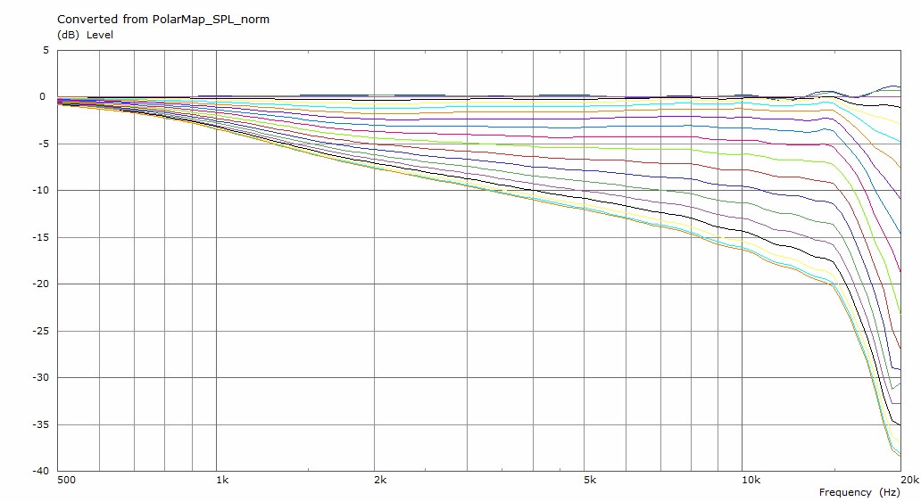

The beamwidth is read off the -6dB line and is half the pattern angle in that graph. The waveguide is about 100 degrees at 1k and 80 degrees at 10K. It will match with a 12" Woofer over a reasonable range of frequencies.

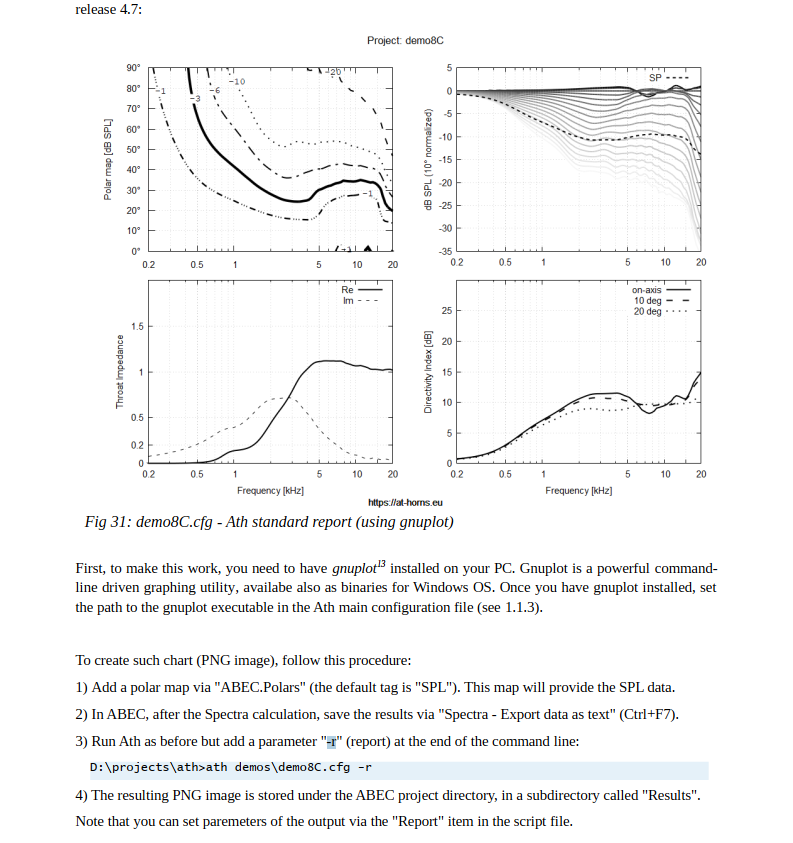

- r when running ath command line after you crunched the viewer data in VACS but this is all in the manual provided. Look at the working example section.
While it's definitely possible what Patrick suggests (i.e. to create a horn with varying length, coverage angle, etc.), I have yet to see one that would perform better than a "simple" axisymmetric waveguide in the end. It seems that the trick is not in the complexity but quite on the contrary. A pure spherical sound wave is pretty simple after all. And that's what we want, right?
You rock, thank you!
For anyone else who missed it, I've attached the instructions.

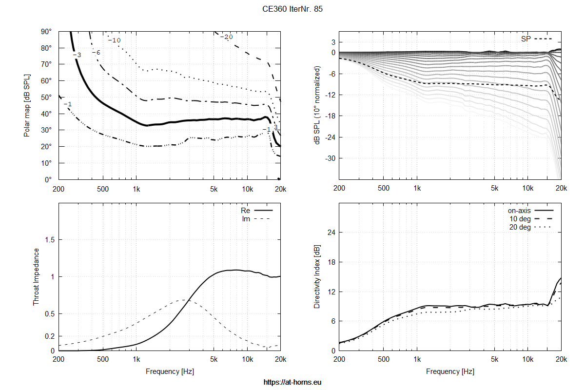

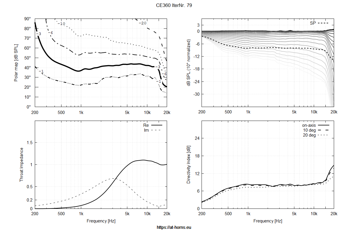

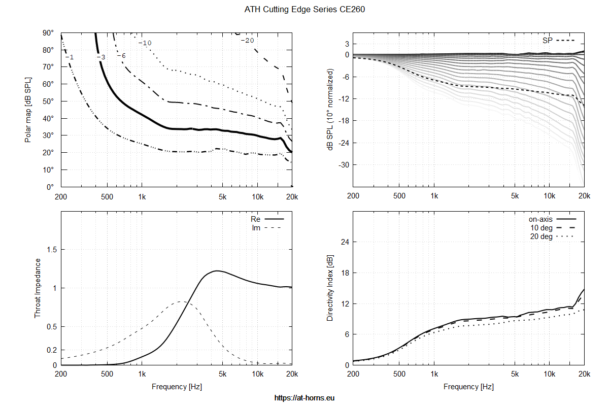

Did you happen to run an optimization on a waveguide like this with the target of a totally flat DI?I realized it doesn't really make sense to me to keep it secret, so here it is - the CE360.
I have only one request - please give credit where credit is due.
That's not how I do optimizations but I've quickly run a batch for what had a potential to result in a "flattish" DI - check it out, there's are some that could be built upon further (see the "Results/img" folder) - https://at-horns.eu/ext/CE360-Iterations.zip
I'm still only not sure it's better.
#79, #85 -
#79, #85 -
What I use is not disclosed anywhere - it's still developmental framework using AutoIt, maybe it even shouldn't be called an optimization but it's quite useful already, as you can see. Perhaps I could also give it away as it is, but without any support or warranty.
Agreed, the jury is still out being as there is only scant evidence either way. I suspect the answer will be highly situation dependent, meaning that there isn't a single correct answer. I can envision situations where it would be better and some where it would be worse.

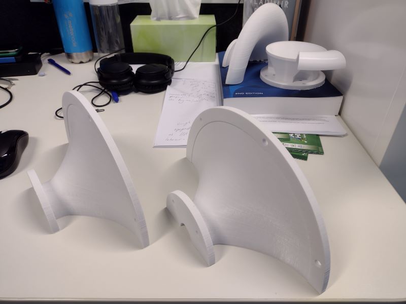

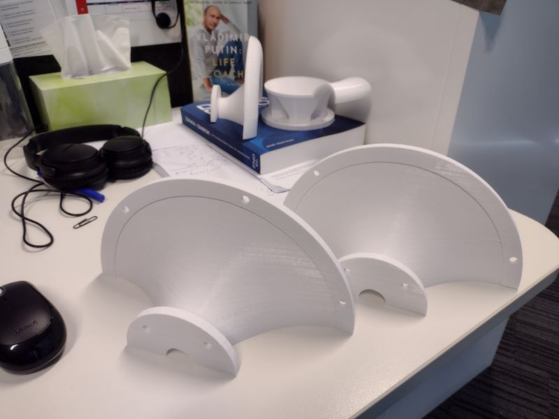

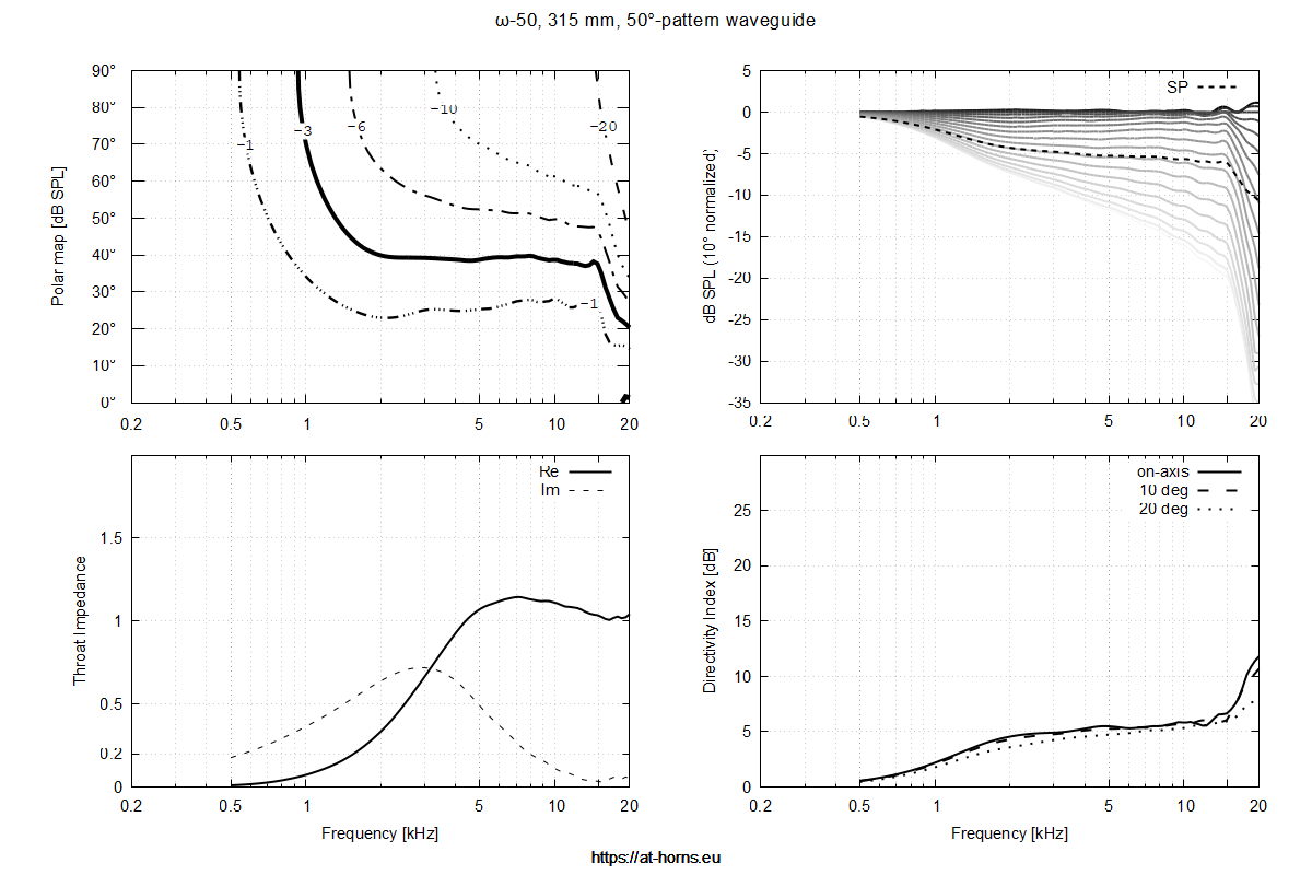

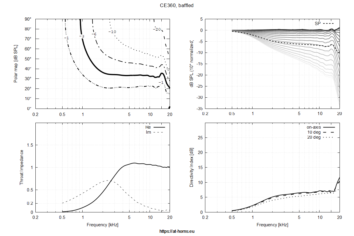

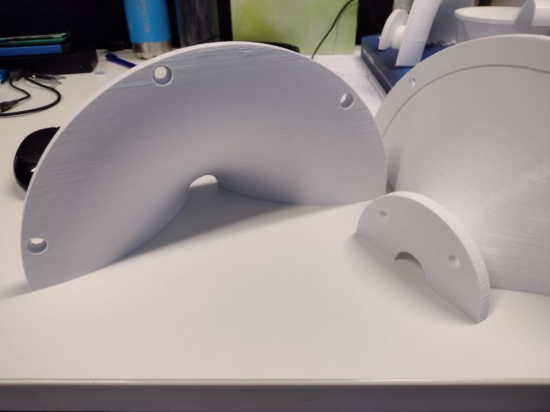

I worked tediously on a 50-degree pattern waveguide, this is the results so far:
I have not reached the smoothness of Marcel's work: Also removed turn-over from CE360 and put it on a baffle, some tweaking and this is what it looks like:
Both where scaled to the same diameter, 315 mm. I think this should be a good size for a waveguide on a 12-inch woofer baffle. Could be interchanged without changing the enclosure.
