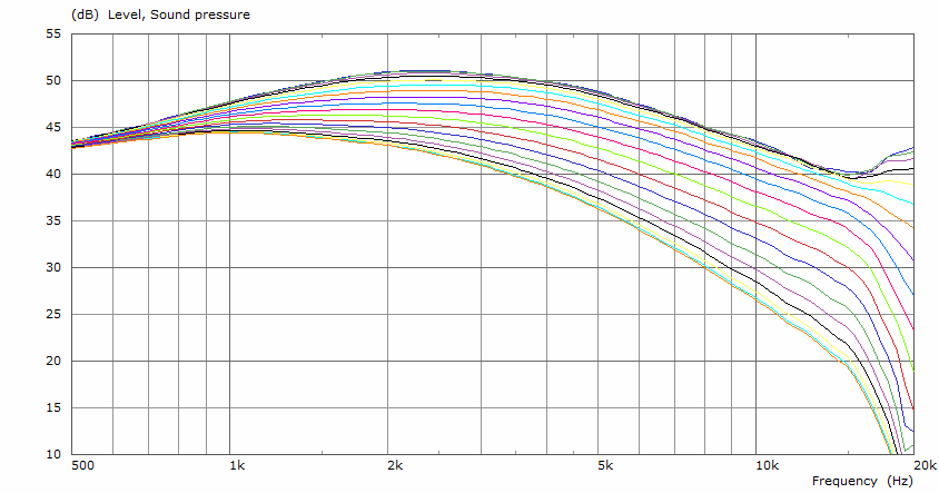

- I still wonder about the quite abrupt onset of the DI rise above 15 kHz in all these axisymmetric waveguides. With a 1" driver this is probably mostly academic but with bigger drivers this still troubles me (and in fact, it may be actually better with a real world driver than with an ideal wavefront). After all, it may not be a bad idea to add some kind "slot" into the throat. If smooth and "random" enough, perhaps it could distribute the higher order stuff to become less obtrusive, I don't know. I already tried someting and it looked promising. Some aspects will be undoubtely worse, someting may improve. Maybe someone could try as well - of course you have to switch to the full 3D mesh calculation.

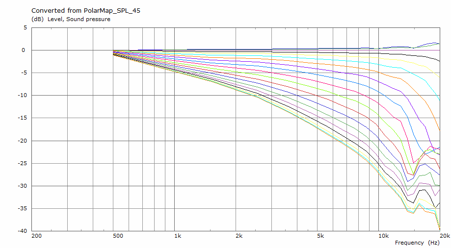

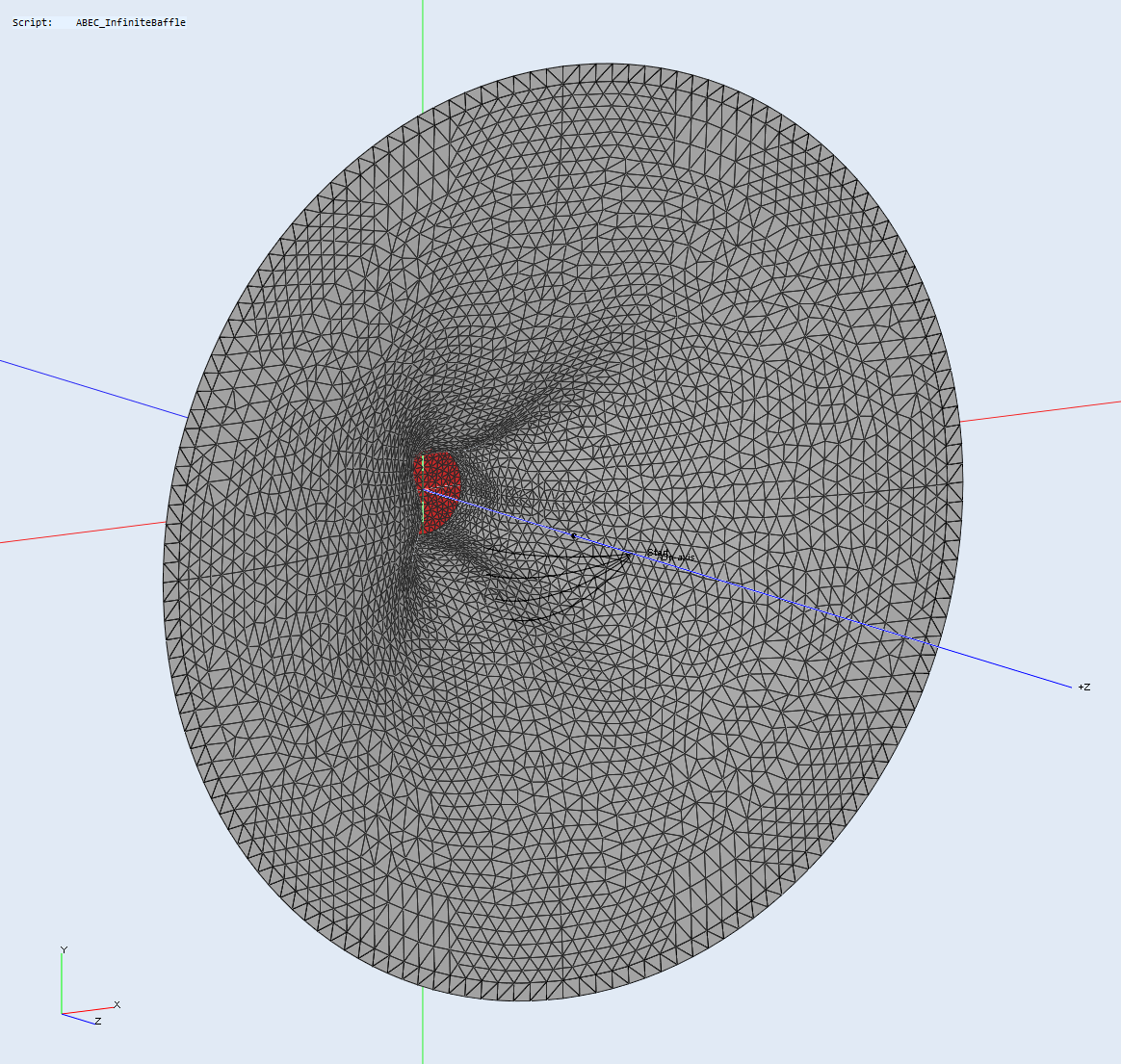

In the latest version of Ath you can easily define a slot, which is just a conical extension of the throat:
; 2 + 25 mm = max. slot length (2 mm minimum)
; 2 slots
Slot.Length = 2 + 25*cos(p)^2
; 3 slots
Slot.Length = 2 + 25*cos(1.5*p)^2
; 4 slots
Slot.Length = 2 + 25*cos(2*p)^2
To keep the mouth circular simply add:
Morph.TargetShape = 2
Unfortunately the tool doesn't properly handle a rollback with non-axisymmetric shapes, so it's better to try it with an infinite baffle.

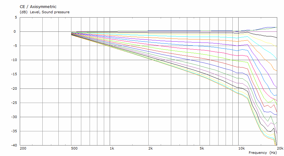

I'm not entirely sure if that is true. If I use any sine/cosine function within circular symmetry mode, ath console tells me different height/width values. Morph.TargetShape = 2 does then lead to a console report that seemingly shows a symmetrical device, but I can still see different axial response if I tell ABEC to show the axes separately in VACS ('hidden' in the ath report). Now I do not know if the results are correct, but the slots still seem to get calculated in a way in cicular symmetry mode. Changing the mode to mesh then shows what is hidden beneath the graphical interface.

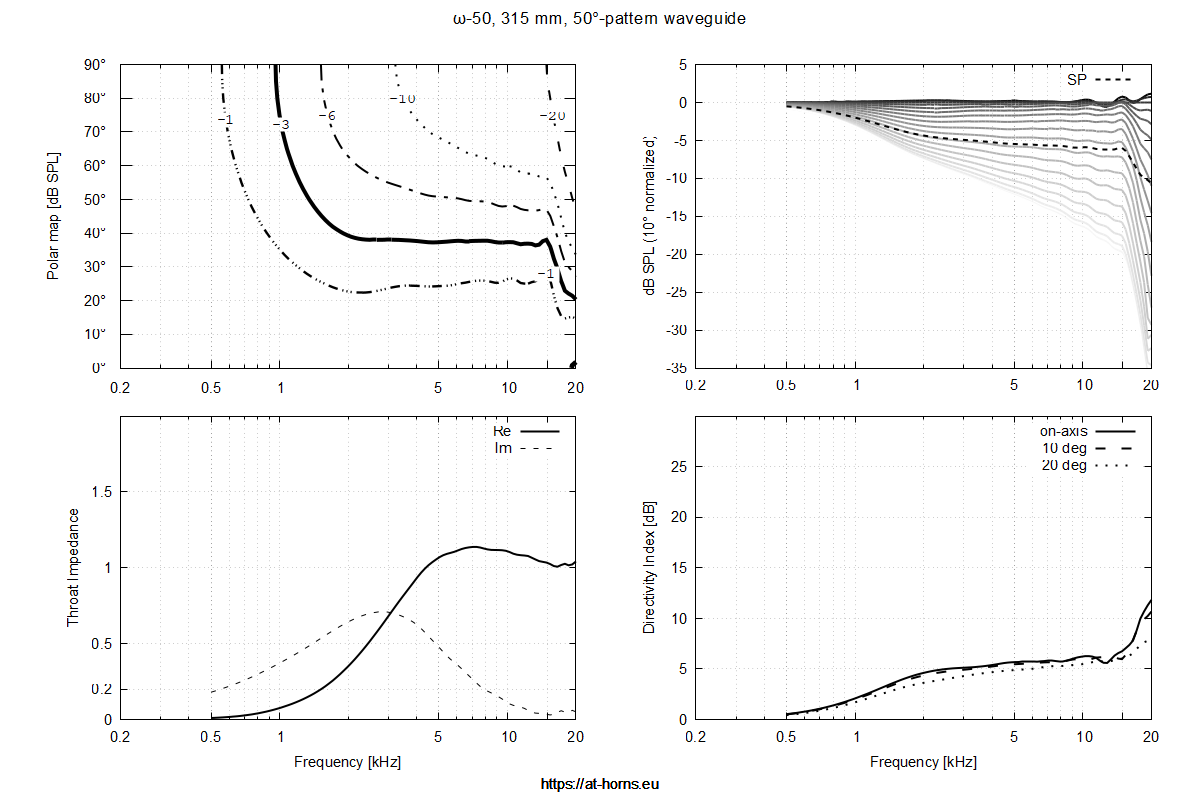

Reports of a rework of the 50-degree device from #7960. Set aside the question, whether or not a wider radiation pattern is actually desireable, I am satisfied with the implementation. With 68 mm length, the device is quite flat, comments welcome.

Circular symmetry uses a single profile, so it might include part of the slot but it would then be calculated the same all the way around. If there is a mesh it is 3D, in circsym there is one profile rotated all the way around in steps.I'm not entirely sure if that is true. If I use any sine/cosine function within circular symmetry mode, ath console tells me different height/width values. Morph.TargetShape = 2 does then lead to a console report that seemingly shows a symmetrical device, but I can still see different axial response if I tell ABEC to show the axes separately in VACS ('hidden' in the ath report). Now I do not know if the results are correct, but the slots still seem to get calculated in a way in cicular symmetry mode. Changing the mode to mesh then shows what is hidden beneath the graphical interface.

As fluid said, in the CircSym mode you explicitly specify one profile (via "ABEC.SimProfile") that is effectively revolved around the axis and that makes an axisymmetric device. For anything non-axisymmetric you have to switch to full 3D simulation (i.e. omit "ABEC.SimProfile" and set the grid/mesh properly).I'm not entirely sure if that is true. If I use any sine/cosine function within circular symmetry mode, ath console tells me different height/width values. Morph.TargetShape = 2 does then lead to a console report that seemingly shows a symmetrical device, but I can still see different axial response if I tell ABEC to show the axes separately in VACS ('hidden' in the ath report). Now I do not know if the results are correct, but the slots still seem to get calculated in a way in cicular symmetry mode. Changing the mode to mesh then shows what is hidden beneath the graphical interface.

If that's what you want I think you couldn't do better.Reports of a rework of the 50-degree device from #7960. Set aside the question, whether or not a wider radiation pattern is actually desireable, I am satisfied with the implementation. With 68 mm length, the device is quite flat, comments welcome. ...

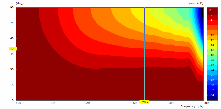

What can be done to have a better judgement of the -6 dB pattern at low frequencies? I find it hard to understand how fast it is rising and to what degree. An unbaffled device like CE360 seems to fall by 10 degree from 20 to 1 kHz, but they seem to tighten up a bit more in the HF than a baffled device.
edit: The DI report is sound power DI, correct? Does the fact that a baffled device is simulated only up to 90 degrees lateral change the graph? Or is it generally comparable with spin data from other speakers?
Sorry, I don't fully understand the first question.
As for the DI, it will be around 3 dB (?) lower in an infinite baffle than full space. I'm sure there's some explanation for this, I'm just too lazy to think about it at the moment (provided my calculation is correct for the half space, I never checked, actually). It's not directly comparable to a finite baffle situation.

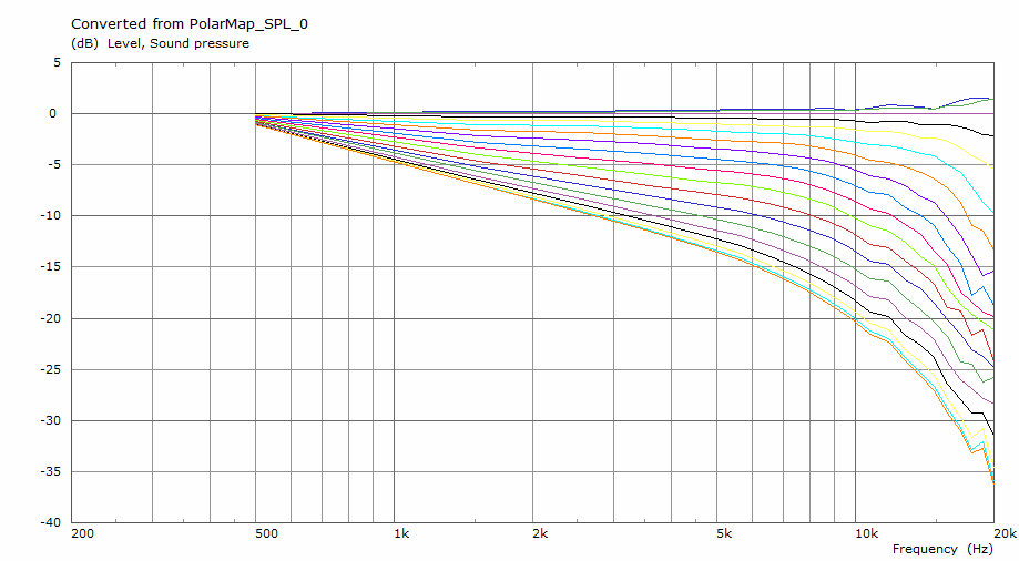

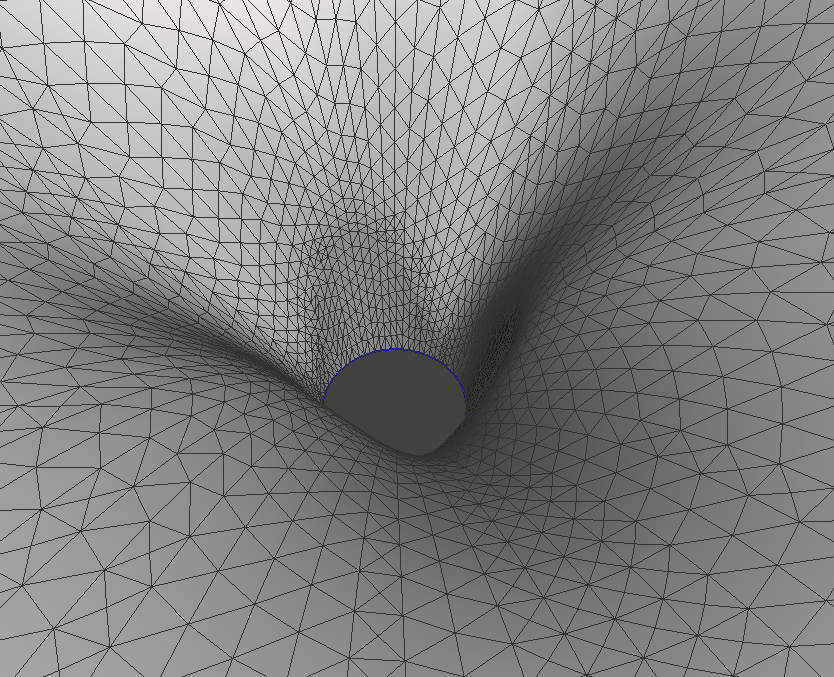

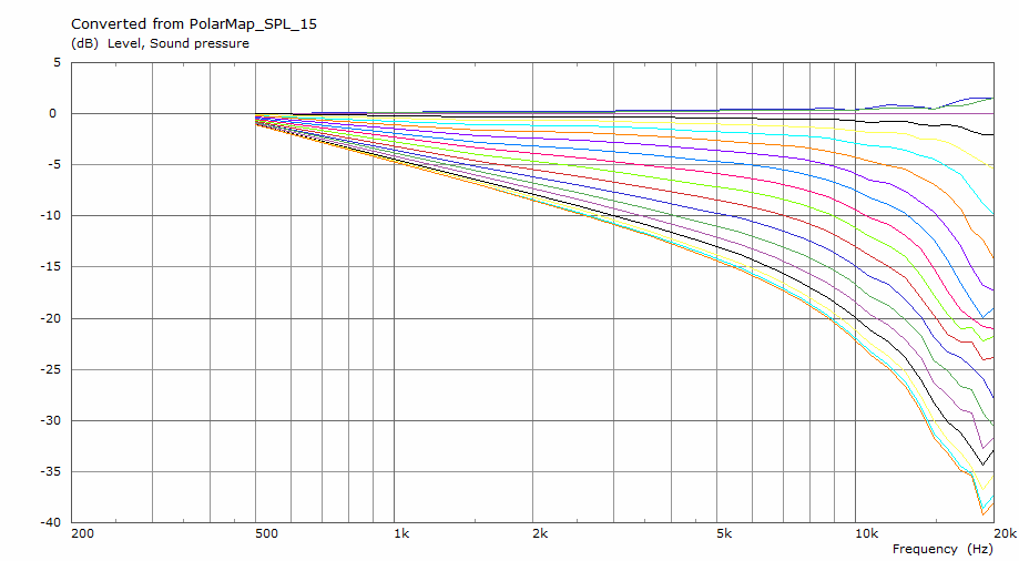

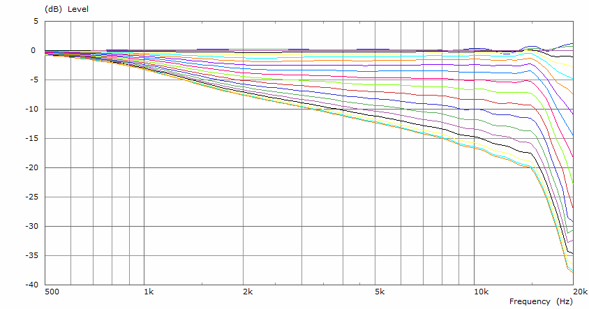

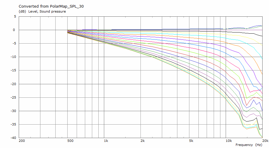

This is an example: CE360 modified for 1.4" throat (36 mm), mounted in an infinite baffle (i.e. no rollback). For the modified (non-axisymmetric) throat four polar sets are shown, for different inclination angles: 0 (=horizontal), 15, 30, 45 (=diagonal), the rest is symmetrical. If anything, it doesn't do any harm it seems. The throat impedance is also a little higher (not shown).I still wonder about the quite abrupt onset of the DI rise above 15 kHz in all these axisymmetric waveguides. With a 1" driver this is probably mostly academic but with bigger drivers this still troubles me [...] I already tried someting and it looked promising.
Maybe "slots" is not the right term, that's just how a named the functionality in the software. The throat is not narrowed anywhere. Basically, the exit section of the driver doesn't stop at one plane but in a "crown" shape. Then a usual waveguide profle starts from there.
