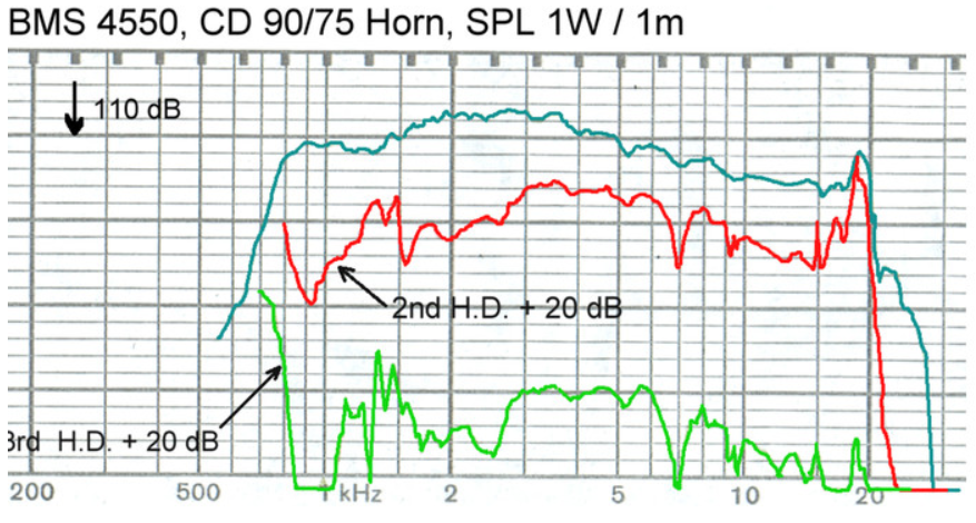

Based on the IR plot it's a resonance around 17 - 18 kHz, it's hardly the waveguide. It comes from the driver, IMHO.
If you correct this with a simple passive RLC (or a DSP biquad, doesn't matter) you should get rid of it to a large degree. (I'm not sure I would bother this high in frequency but you can always test audibility of this easily.)

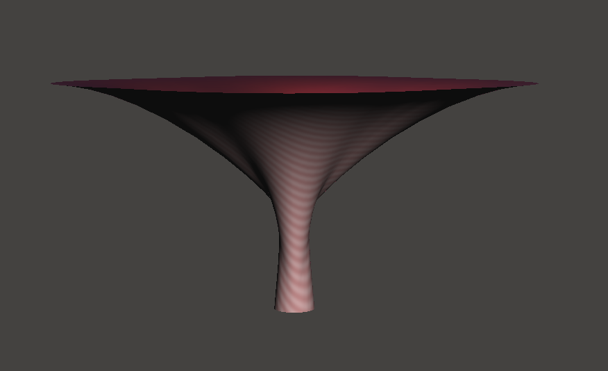

For the next release of Ath I implemented a new parameter/feature: Slot.Length
It basically adds a flat segment before the actual OS-SE profile, of which the length can be continuously variable (along with all the other parameters). It will be fun watchig what people come up with 🙂

The wobble is definitely a resonance - stored energy, not a reflection or diffraction. You can recognize resonance by a constant oscillation period in the impulse response. The other effects don't behave like that.
That makes sense as the BMS4550 has a pretty nasty breakup at 18K, there looked to be diffractive ripple in the FR which is what my comment was based on.

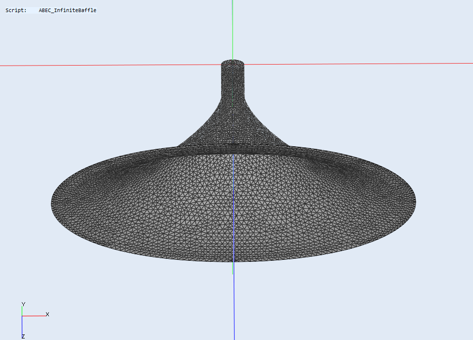

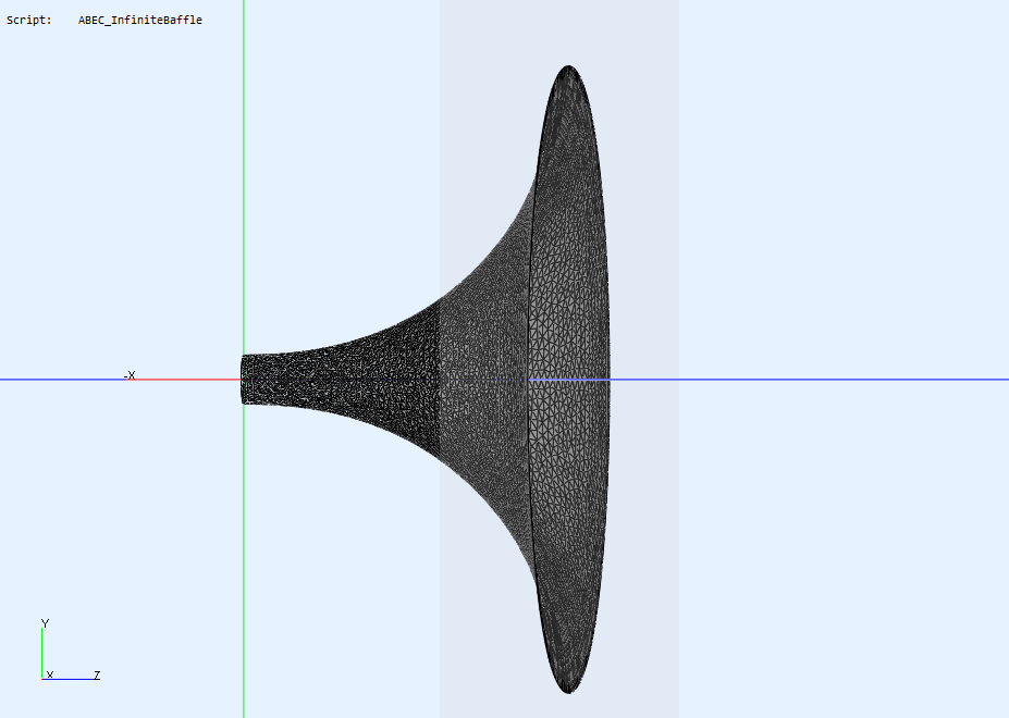

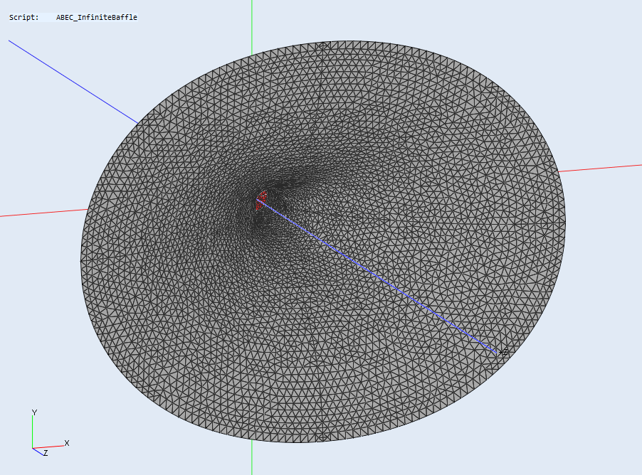

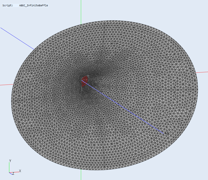

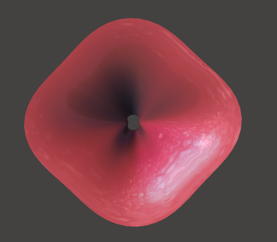

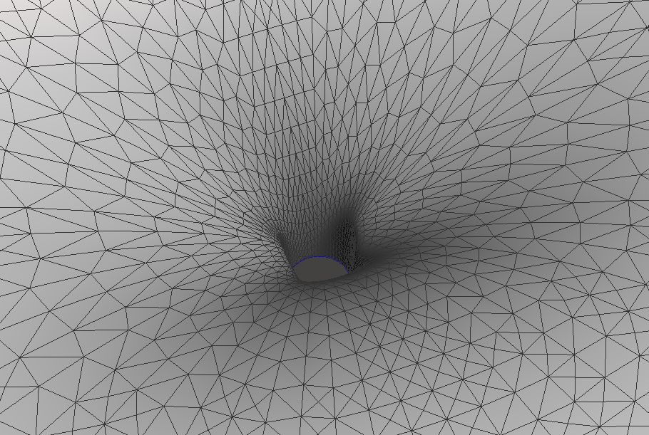

And a bit larger - 578 x 464 x 240 mm (W x H x D).
attachment.php
Those minor wobbles indeed correspond to break-up resonances, typical of all 455.. drivers. Nothing to worry about imo.
I bet many people even appreciate the added sparkle, even though it isn't true to the original signal.

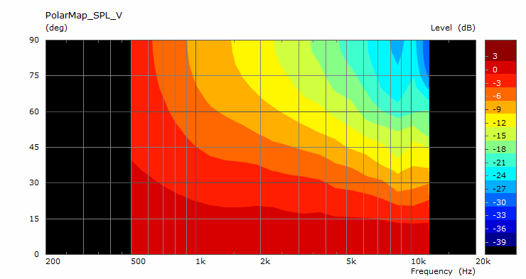

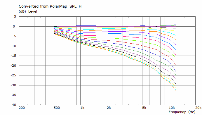

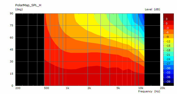

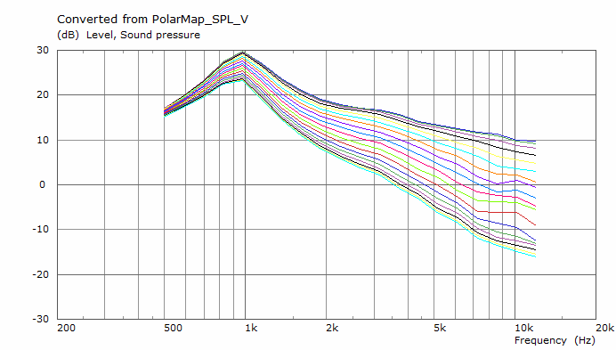

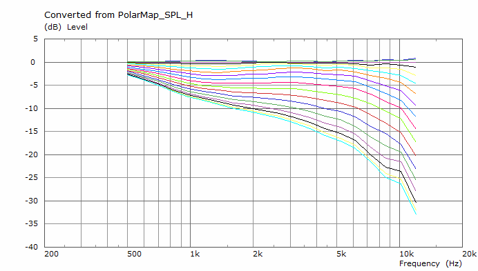

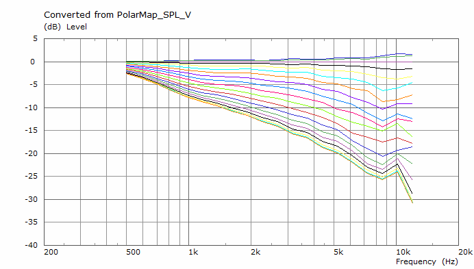

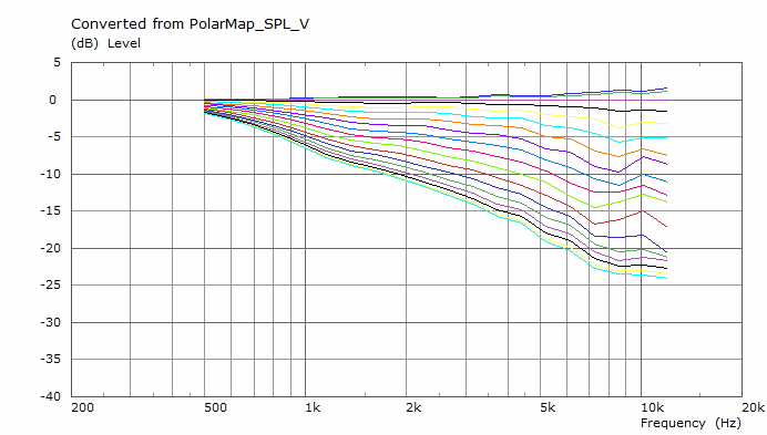

and unless i can't interpret polar charts well how is it that a fifteen degree window across the bandwidth is acceptable....
The nominal beam width is usually given at the -6dB point which on these charts is the outer edge of the orange band, on the Horizontal graph above at 5K the beam width is wider than 90 degrees as the graph is only half the beam width. The slope of the beam as it moves above the on axis rises showing the directivity rising with frequency.
