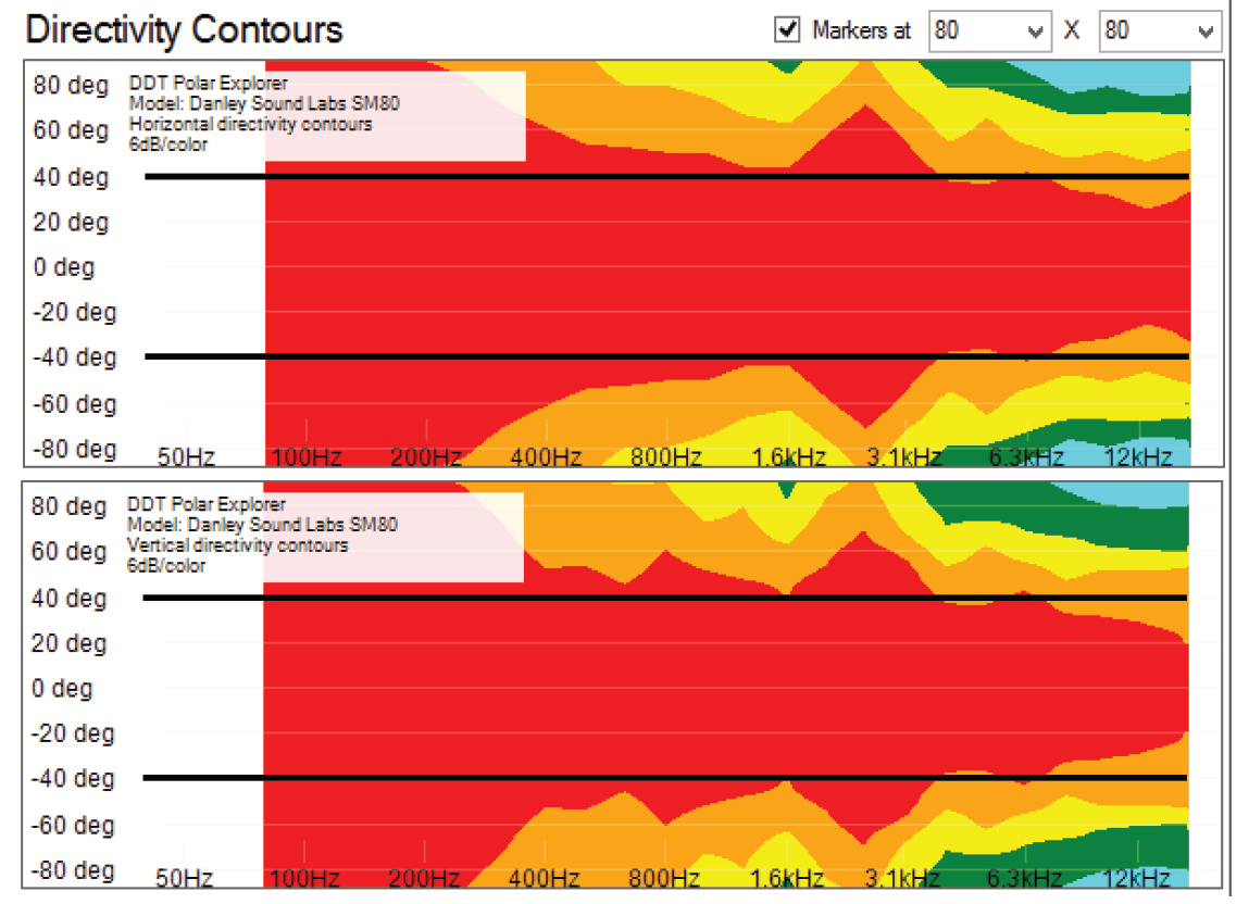

I'd prefer that horn to something like this:

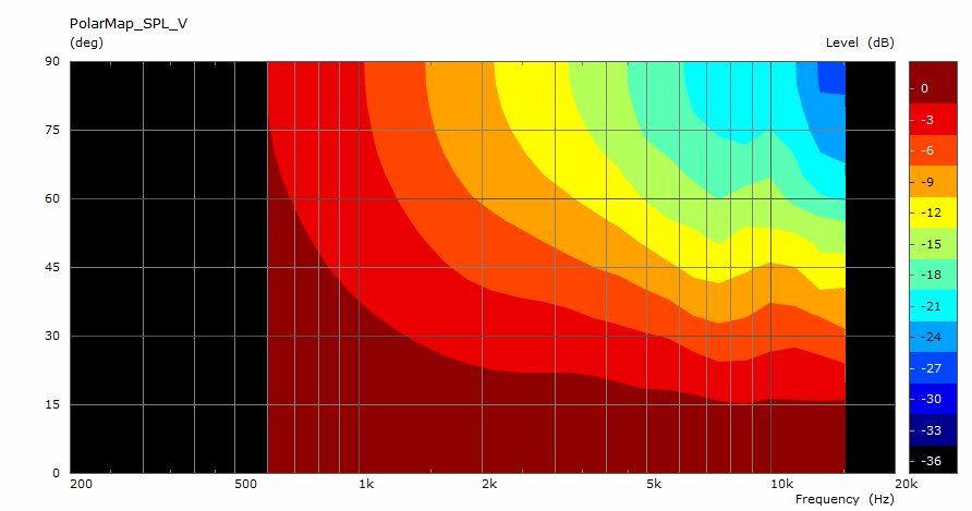

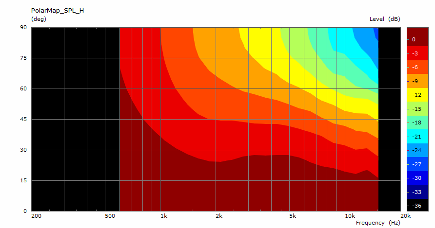

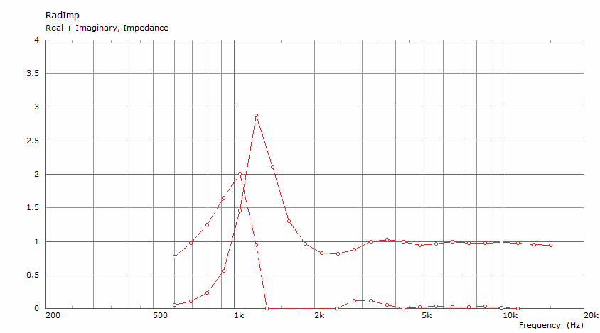

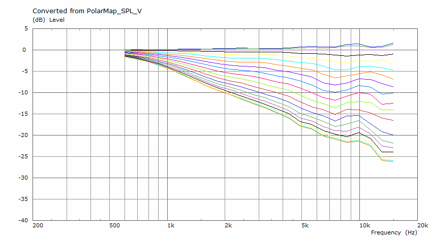

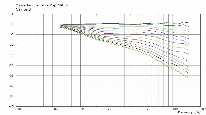

1" throat, 318 x 302 x 150 mm (could be made with a circular outline easily).
I have to say it's not totally bad and the throat acoustic impedance is considerably higher than usual.
Now I need to implement general 3D DI/radiated sound power calculations too see it better.
Also note that this is for an infinite baffle so the beamwidth is higher for lower frequencies than it would be in an enclosure or free standing.

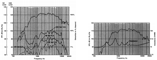

Just remember that it will make the beam at the lower end wider than you thought too. At 400Hz it takes a pretty large device to have any real directivity so the woofer and horn can be crossed there as they are both pretty wide.
Its not narrow/wider than I thought...I subscribe to -3db not -6db....really should be -2db. My comment about my doubts of the Strauss crossing over stems from my own experience crossing the AXi over at 400hz with a 350hz (~330hz) tuned horn....Neglecting group delay....I simulated in horn resp, the highest tuning I could get to draw a straight line to 400hz with no issue (350hz)
The builder knew my goal and provided a slightly lower tuning than I paid for...combined with the Axi...AND I probably found the rare horn builder whos tunings are modest/honest (unlike AutoTech)....my measurements reach to 330hz before falling....
The thing that stopped me from going smaller at the time was the inability to take a steep roll off, like the average horn has past cutoff...and bending the curve straight to use it properly...its just not practical or possible though according to hornresp and my mock up of the Axi specs I had the Xmax for it...So looking at the measurements of the jbl horn....though the driver is different in the Strauss....a horn is a horn right?....and theres no way they bent that curve flat to 400hz....
attachment.php
its actually more feasible that they crossed the woofer over at 400hz but the Horn is crossed higher with a low order slope...I can't say I understand how much a compression driver can influence the cutoff...is there something there>?

I explained myself....the cutoff of the horn is too steep....take a look at that curve....look at the impedance...figure out a tuning.... model a horn tuned to that note in hornresp....I've already been down that road....you'll never bend the curve to play flat to 400hz....so, rather, I feel they may have ran the 15" to 400hz but the horn is likely cutoff higher orrrrr they really did place the crossover at 400hz...on the horn...and ran the woofer up higher to make up for the area in between 700hz and 400hz that the horn cannot carry....I forget about that trick....either way....I find it sceptical that that horn is crossed at 400hz....in the traditional sense, ie, the horn in the Strauss is very unlikely playing flat, 0db, down into into a 400hz XO
Any comments on this TNT?
When speaking of crossovers, one should always consider the final acoustical reponses (i.e. with all the electrical filtering in the crossover). There's absolutely no reason why should be the horn flat by itself down to the crossover frequency (or even below).
Everyones talking but aint no one walking....
Group Delay? The want to not have to use an extreme amount of eq to achieve an acceptable Fr?
Instead of making comments I'd love to see a crossover at X where the cutoff of the horn+driver was actually 300hz above the X....since its not an issue I'm sure someone can easily demonstrate, we are talking horns...end result is a flat FR in combination with the woofer...and the horn plays Flat down to X, with the help of EQ I presume...
Wouldn't be the first time I was wrong.
This group delay on the lower end of the passband of the device itself you often hear about is totally irrelevant. It is tied to the amplitude response of the device and the final group delay is given by the final acoustical response (and the crossover as a whole). I don't know who originated this notion but it's a complete nonsense.
