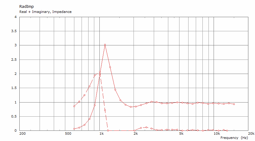

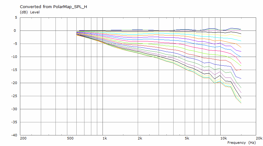

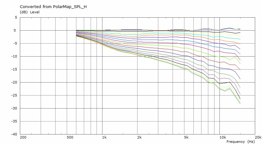

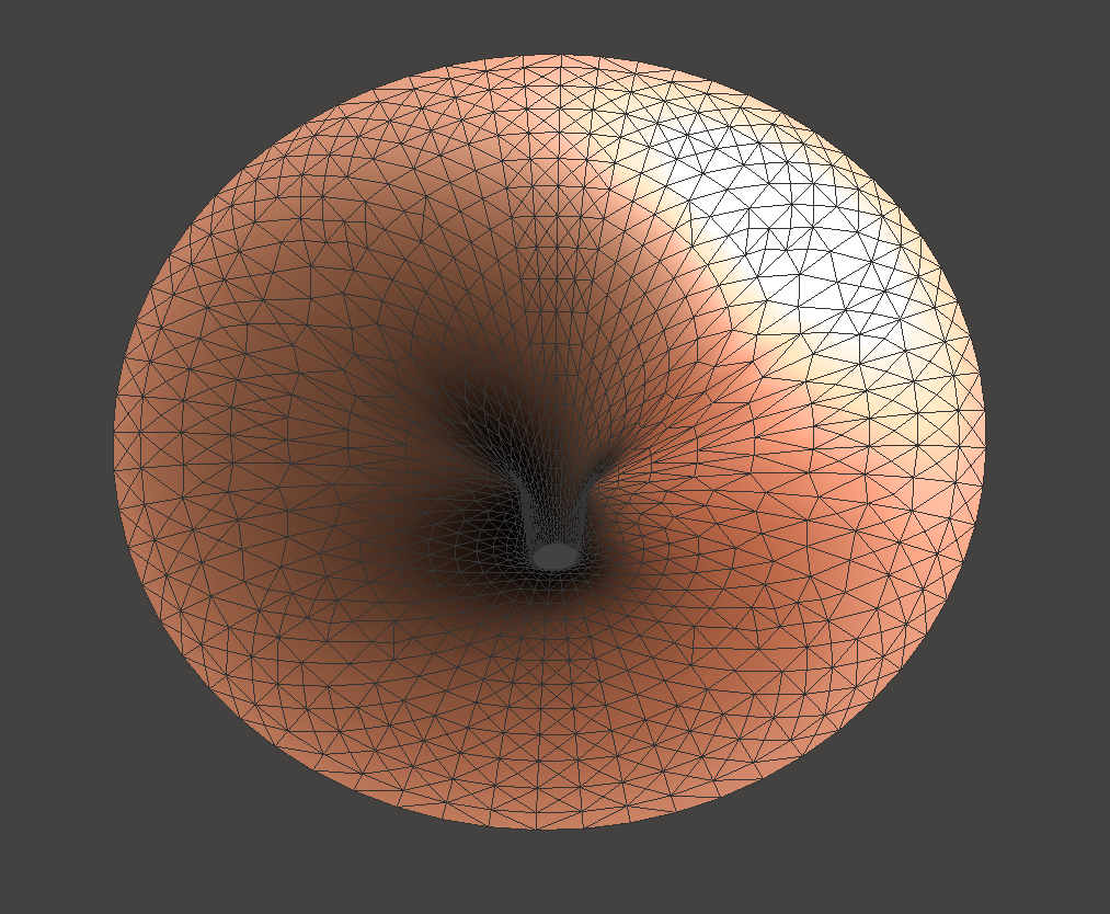

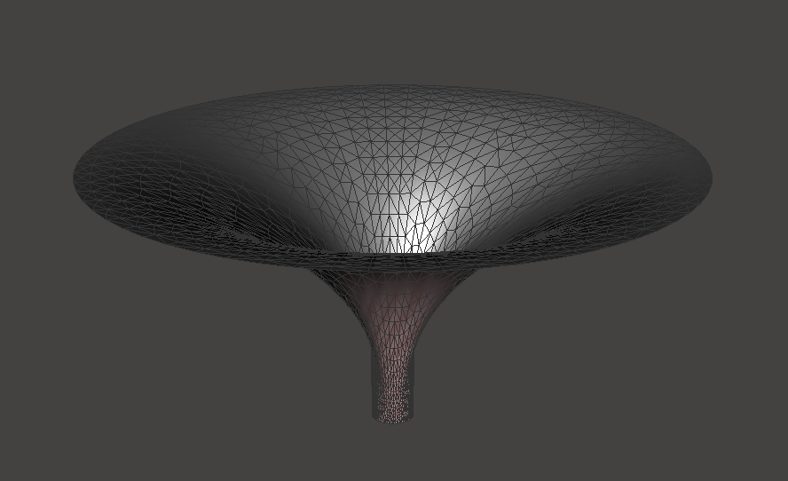

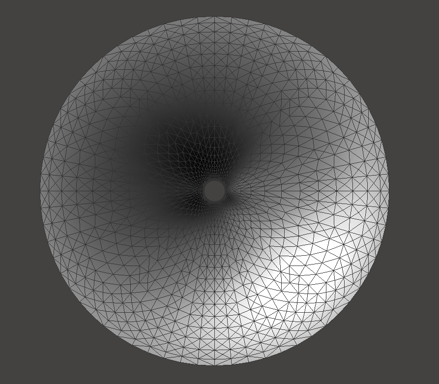

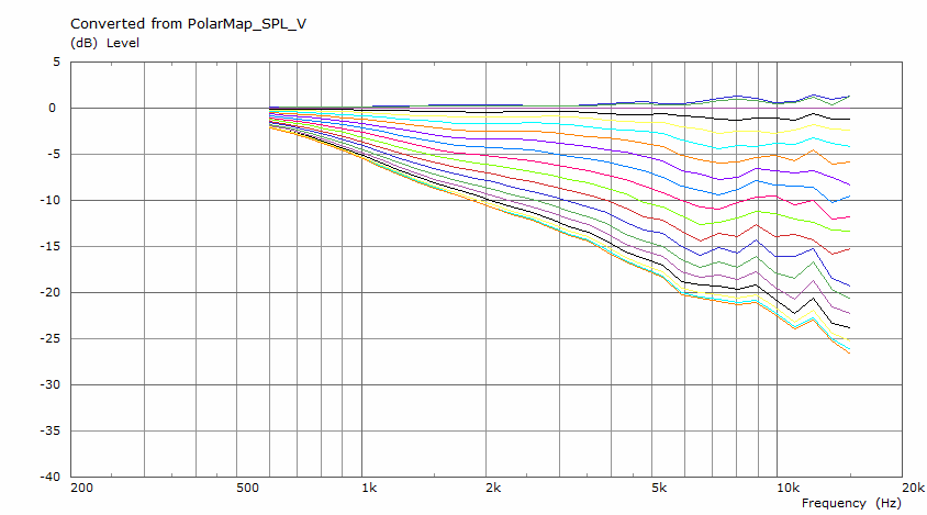

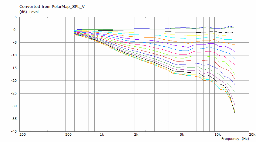

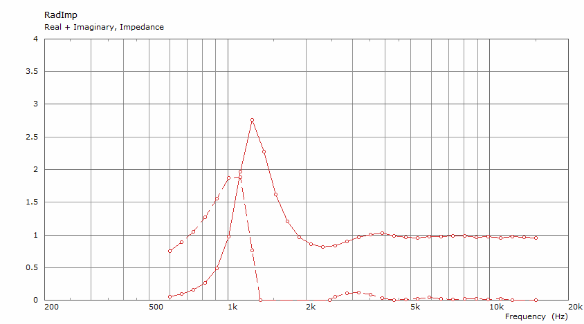

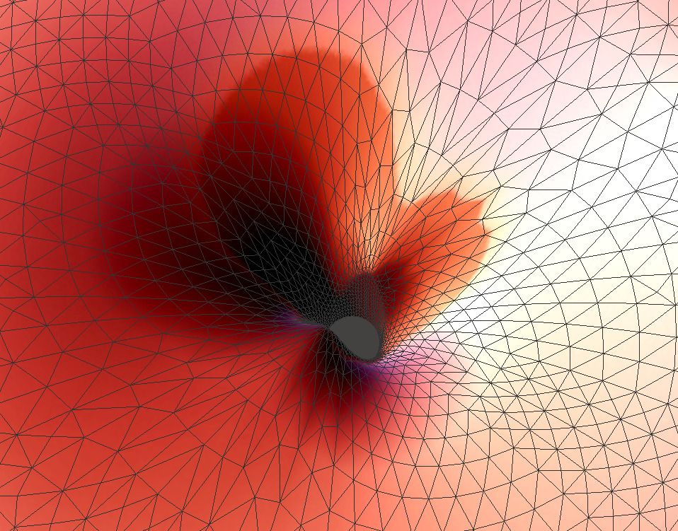

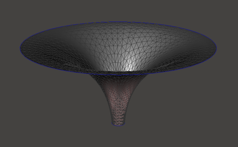

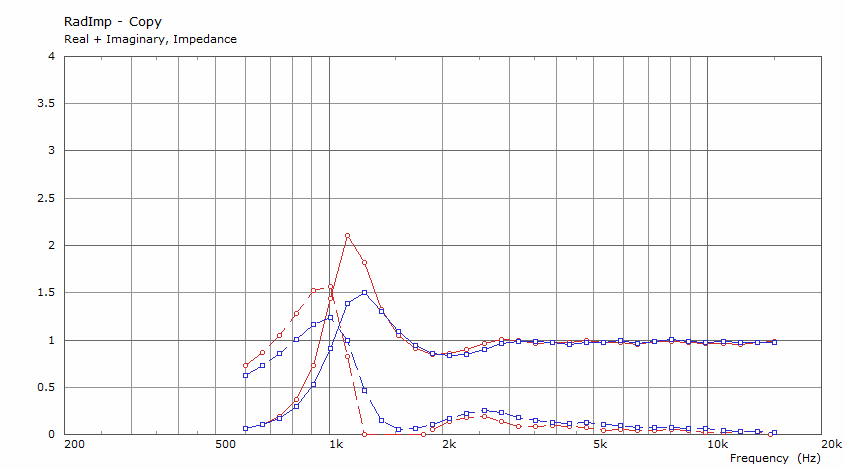

Something slightly bigger perhaps?
Total length: 18 cm, slot length: 6 cm, mouth Ø: 36 cm.
Ø36 cm is reached for 162 mm of length, slot 60 mm (the same as before), 1" throat, infinite baffle -
(Well this is just a first quick try, no optimization whatsoever.)

How to evaluate that? Measure distortion with and without the cone drivers?
Can you messure pressure at the throat in the simulation? only mid playing. In real world you could measure with the driver, use it as microphone.
Tried to google up how pressure changes in pipes, no idea if it goes to horns but narrow part of narrowing pipe has less pressure since the speed increases so pressure should be less in the throat than in the mouth. How much less and does it matter, got no idea. Mouth is just atmospheric pressure? Just thinking while writing. Maybe distortion measurement is the right way.
