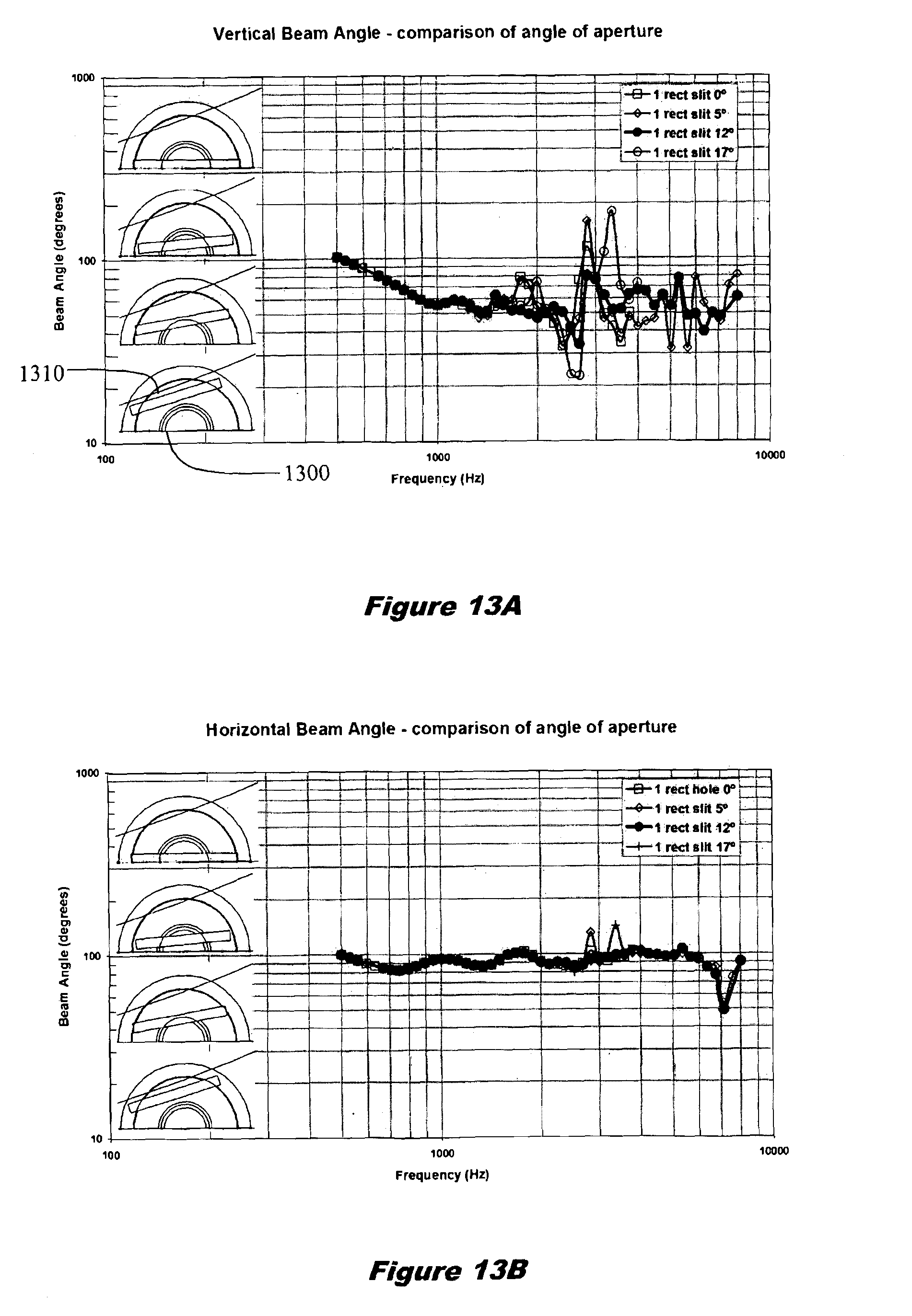

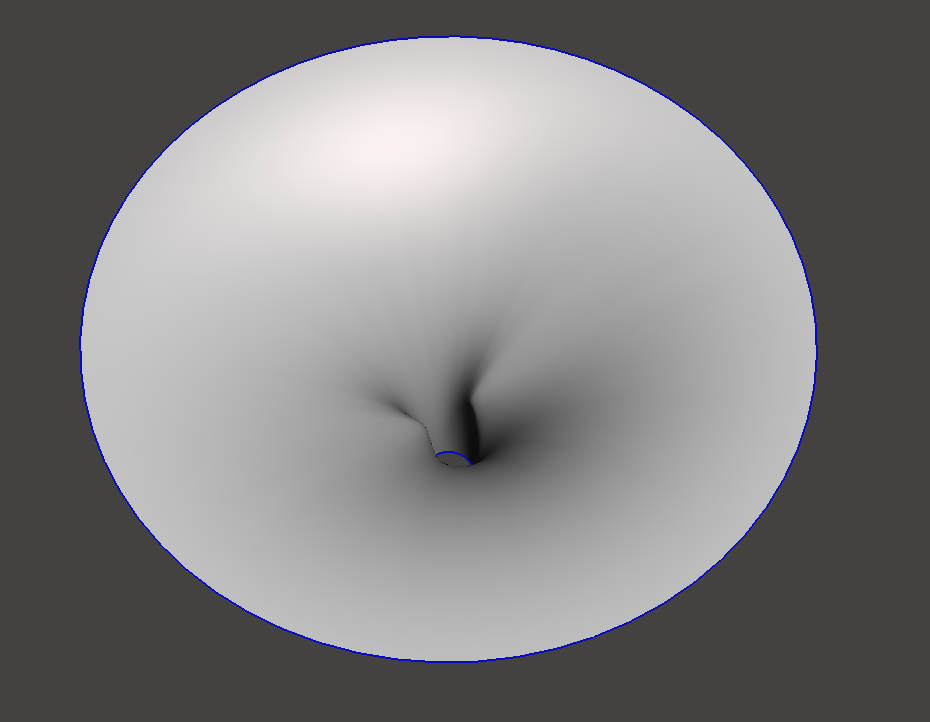

An Ath generated waveguide can have excellent termination if the right parameters are used and so the issues the ports present are much more noticeable than they are in horn that already has bigger problems. I've run enough simulations of both to be confident in that part.
Whether that matters or not from an audibility perspective has not been tested enough to know for sure.
It seems worthwhile to try and find a way to minimize their impact without losing anything else.

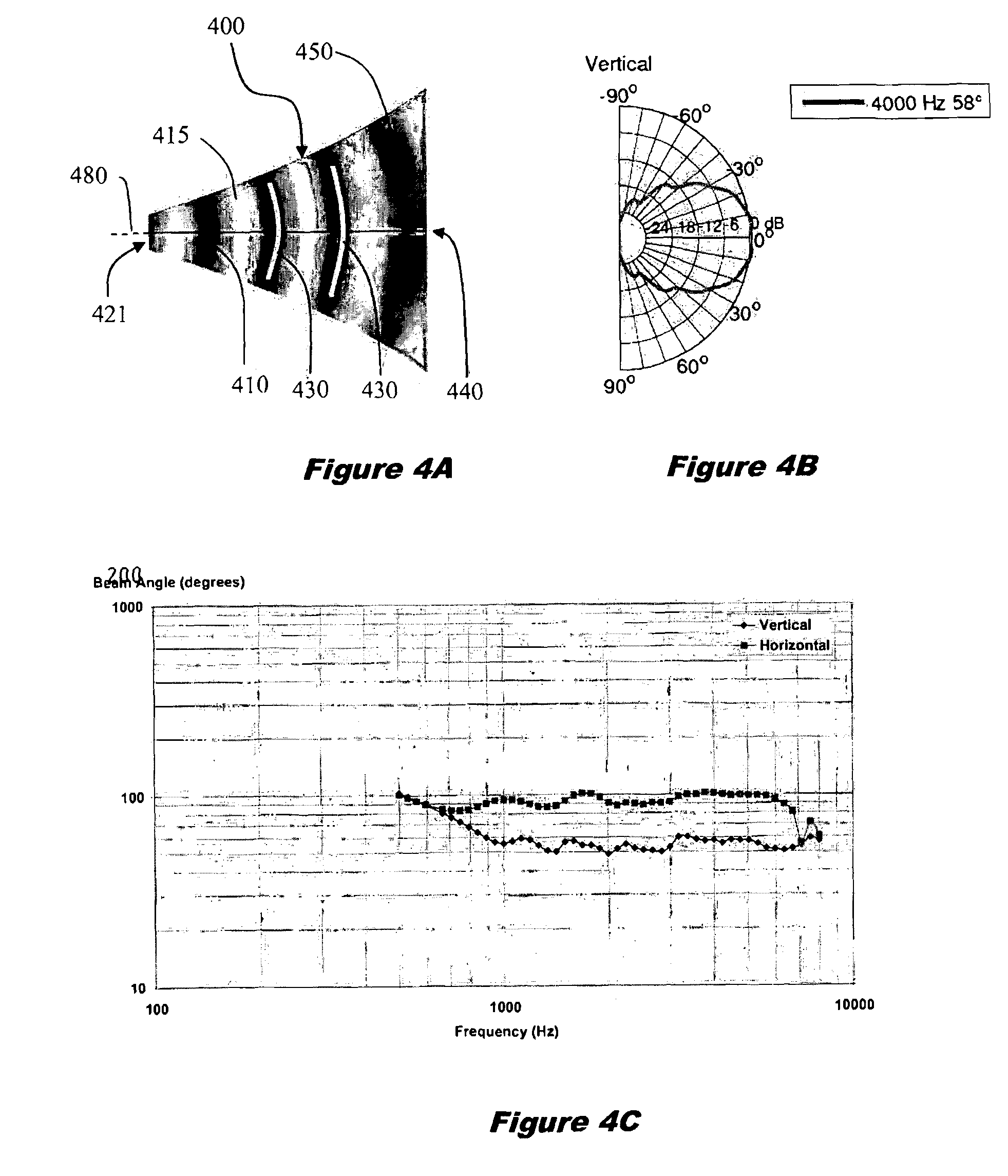

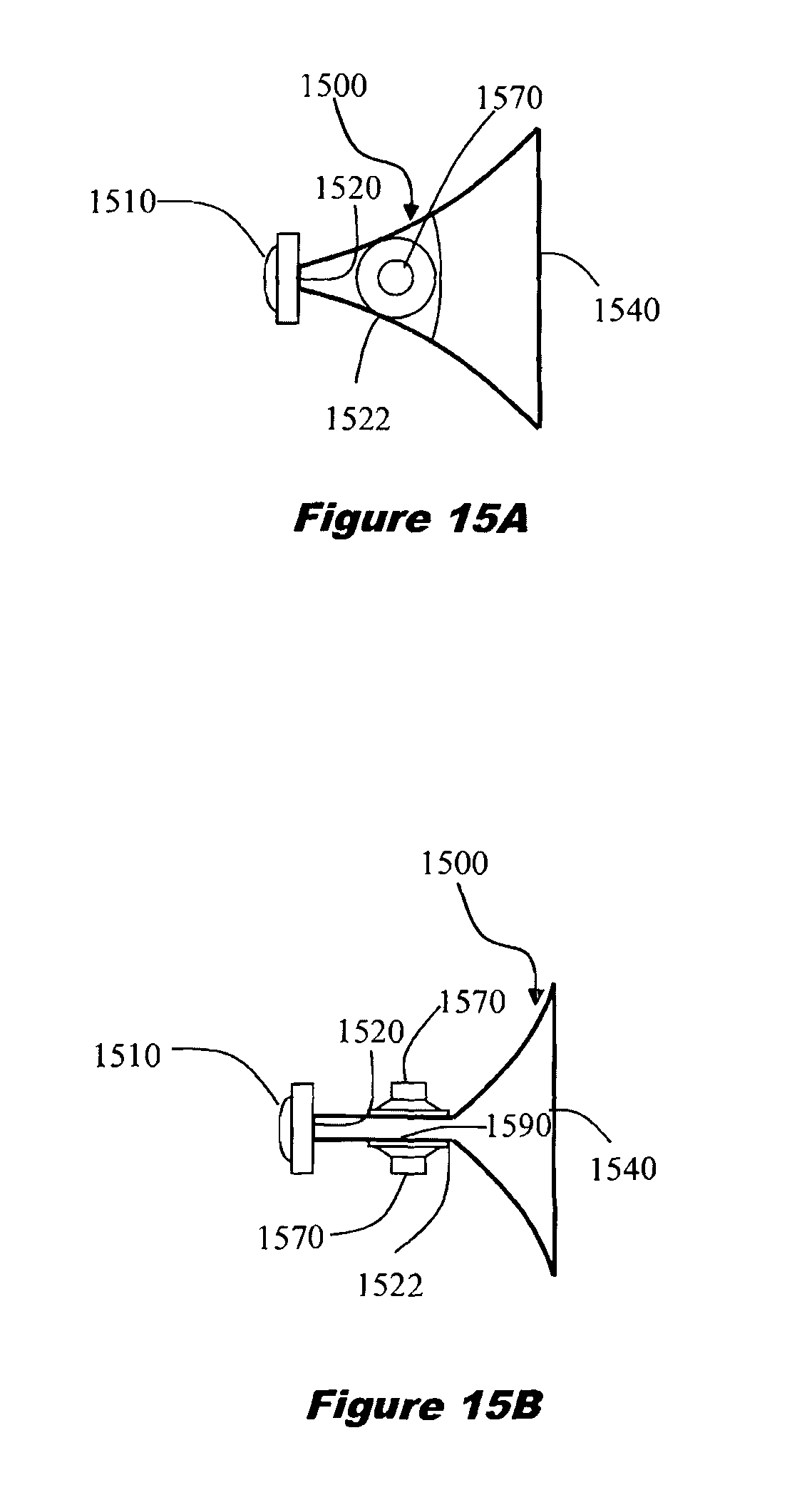

So trapezoidal ports resulted in the most consistent beamwidth. I find it surprising how many patents can be given out for what seems to me the same idea.

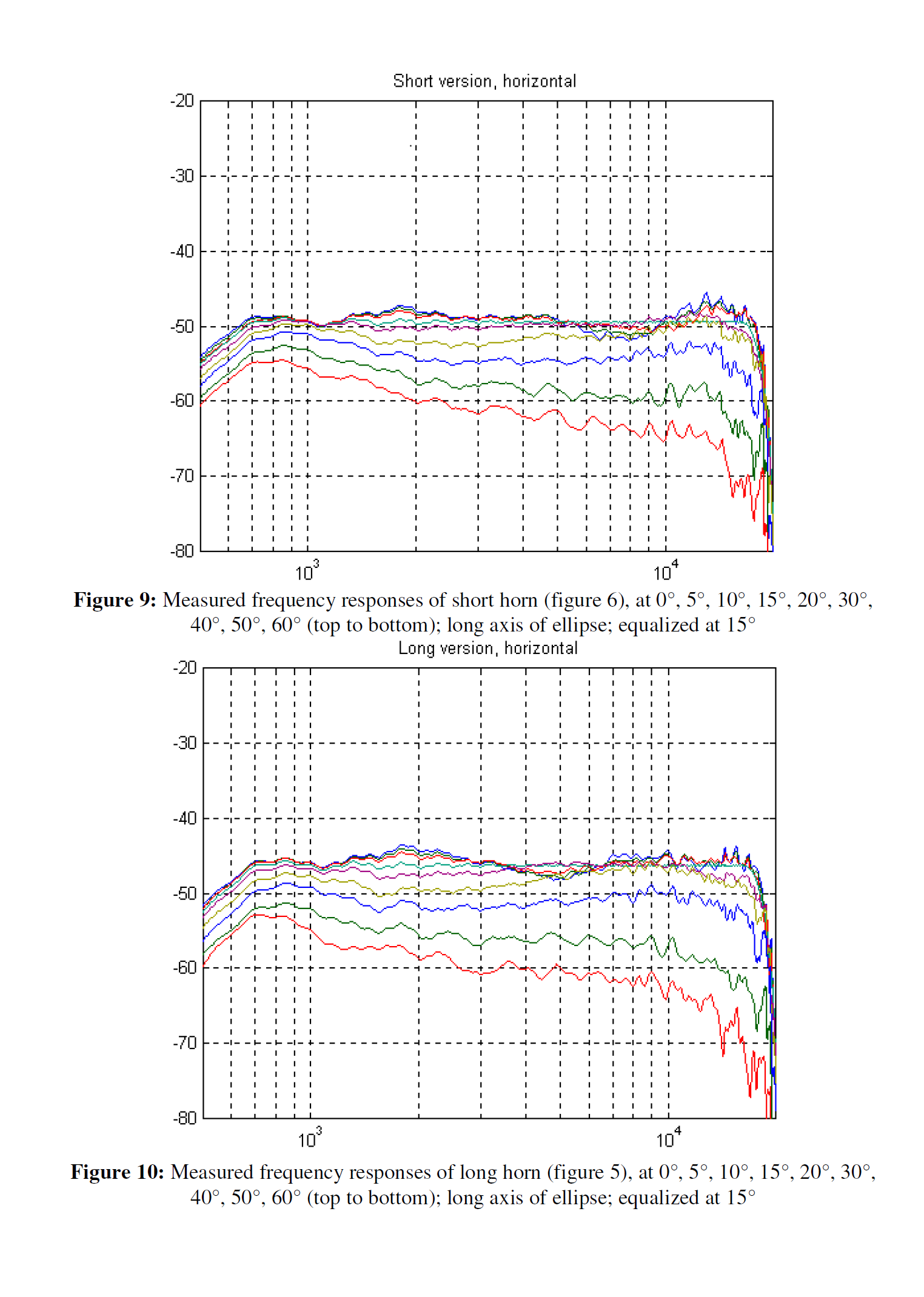

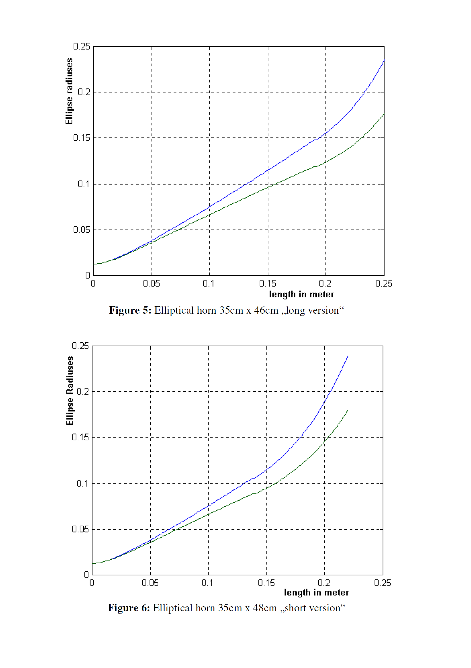

20 years ago, someone managed to cross a big OS waveguide at 450 Hz by using a high quality compression driver and primitive FIR techniques.
Design of High-Quality Studio Loudspeakers using Digital Correction by Ulrich Horbach.pdf354.4 KB · Views: 151
Design of High-Quality Studio Loudspeakers using Digital Correction by Ulrich Horbach_2.png273 KB · Views: 332
Design of High-Quality Studio Loudspeakers using Digital Correction by Ulrich Horbach_1.png134.4 KB · Views: 344

For those who would already like to start playing with this, here's a beta release: ATH - Advanced Transition Horns
What's new is the "Slot.Length" parameter. Attached is a sample project script. Don't try to make it free standing, that doesn't work yet, as some other things. But it can be simulated in an infinite baffle without any problems, as shown before. This feature allows to create some crazy stuff, be careful.

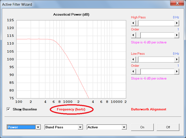

HornResp filter Wizard wont let me see above 1000hz anyway
Double-click on the "Frequency (hertz)" label to change the frequency range from 10-2000Hz to 100-20000Hz.
