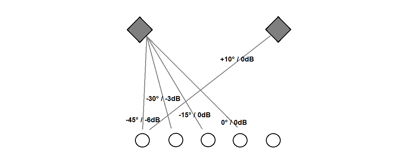

Geddes' interesting approach is to actually utilise the narrower directivity of constant directivity horns to try to widen the sweet spot by pointing the mains across each other, so that they are aimed at a point in front of the listening plane.
This way, the response from each speaker is flat in the centre of the listening plane i.e. the prime listening position. As one moves to either side of the centre listening position, the response from the closer speaker starts to drop off, as the listener is now further off-axis from it, while the response from the further speaker remains flat. This tends to compensate for the difference in relative SPLs resulting from the listener being closer to one speaker.
As the off-centre listener is further from the speaker which is producing higher SPL on that axis, and closer to the speaker producing lower SPL, the inter-channel level balance is closer to equal.
Just whipped this up in MS Paint, it's obviously not to scale, but you can see how, for the listener in the far left position for example, the drop in SPL from the R speaker resulting from it being further away will be somewhat mitigated by the drop in SPL from the L speaker resulting from the listener being off-axis to it. For listeners closer to the centre position, the SPL from both speakers will be roughly the same. Such a setup can actually create a wider sweet spot than if both speakers were very wide directivity.

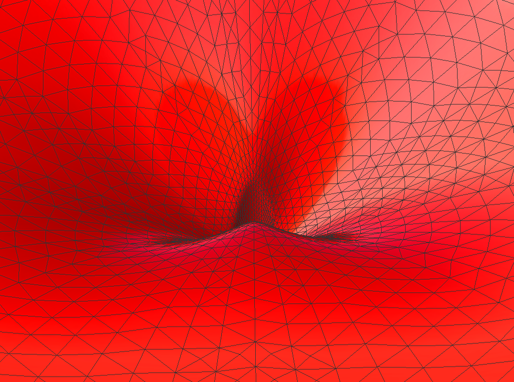

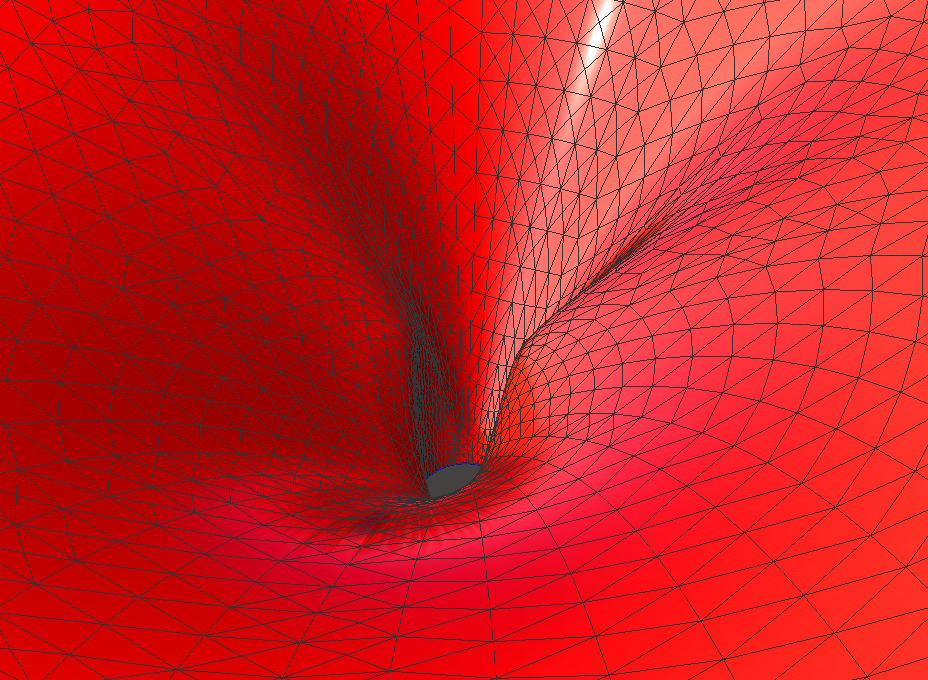

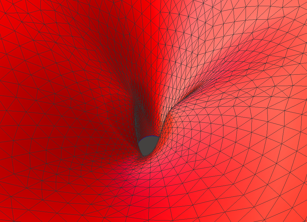

The JBL Image Control Waveguides, and their numerous variants, they're simply two narrow waveguides superimposed on top of each other, and arranged in an "X" shape. From everything that I can see, based on years of tinkering with them, they're designed to do what you're looking to do. Basically it's a waveguide that offers beamwidth control, but it also has more output ON AXIS than an OS waveguide of comparable size. Note that there's no free lunch; the reason that the Image Control Waveguides are able to achieve this trick is because they're 'robbing' some output from the diagonal angles of the waveguide.
From my various experiments, I'd generally argue that it comes at a price, which is a lumpier response curve. Here's some data:
This is the big 10" x 14" QSC waveguide, which is basically oblate spheroidal. Note how the frequency response is exceptionally smooth and the polars are consistent.
This is one of my recent projects, and it's shape is inspired by the JBL Image Control waveguides. Note how the frequency response and polars aren't quite as good as the QSC. I wish I'd calibrated the voltage and SPL, because I *think* this one is louder than the QSC. And theory predicts it should be. But I can't be certain until I calibrate the SPL and re-measure both waveguides.
One thing about the JBL Image Control Waveguides, which might not be obvious, is why the slot is "X-Shaped." This is because 'pinching' one axis narrows the output on that axis.
For instance, if you 'pinch' the throat of a horn on it's vertical axis, you narrow the beamwidth on the vertical axis.
Looking at the JBL Image Control Waveguides, it might seem that they should be shaped like a cross instead of an "X" shape. But that would yield the OPPOSITE of what we want: if you pinched the waveguide on the horizontal and vertical axis, you would NARROW the beamwidth on the horizontal and vertical axis. What we want is to narrow the beamwidth on the diagonals.

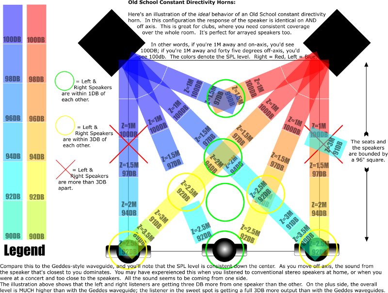

Actually, that way of pointing speakers was mentioned decades ago, I have been doing that for probably at least 30 years, I don’t recall his own setup is like that, but I may be wrong.
Mine is like that.
And yes it was suggested some time ago, but it is only doable with a CD loudspeaker systems. CD loudspeaker systems were very rare back then, almost non-existent for Hi-Fi, so while the idea was there, the practicalities weren't. And the system needs a near flat DI or the timbre will change with location. Better than head-in-a-vice, but not as good as a flat DI can achieve. Another reason that I prefer a flatter DI.
Mine is like that.

I made the illustration, published it on a car audio forum twelve years ago and credited you :)
Creating The Perfect Soundstage | DiyMobileAudio.com Car Stereo Forum

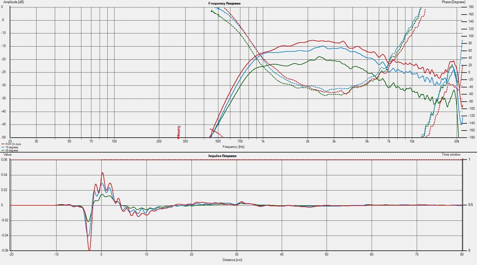

The impulse does not look ideal.
I would love to have a 3D printer that prints so large. Used to just send it out for milling a prototype
Yeah, the impulse is home how wobbly, which I think has to do with the back wave, since I don't have the rollback.
The previous picture is a bit confusing, since the measurements weren't properly time aligned to each other. I think it's better to see here.
Is there anything else you think is wrong with the impulse response?
Here is a time aligned version:

Yeah, the impulse is home how wobbly, which I think has to do with the back wave...
The ripple in the impulse can also come from the other side of the measurement mic too, a mic holder, stand etc. can cause those sort of diffractions.

Looks like the polarity is inverted somewhere in the chain, on a single driver in phase the peak should go up first :)
