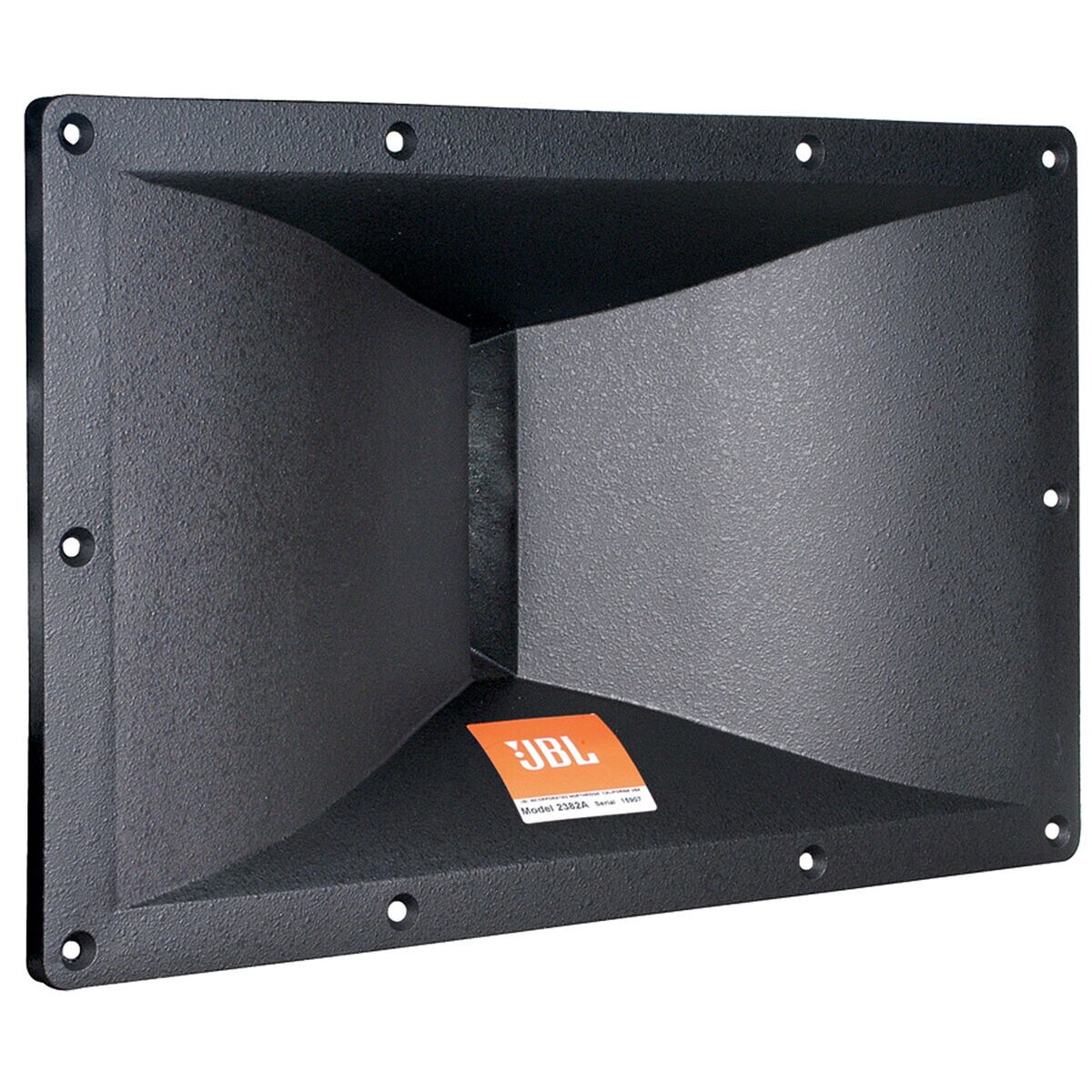

The JBL Image Control Waveguides, and their numerous variants, they're simply two narrow waveguides superimposed on top of each other, and arranged in an "X" shape. From everything that I can see, based on years of tinkering with them, they're designed to do what you're looking to do. Basically it's a waveguide that offers beamwidth control, but it also has more output ON AXIS than an OS waveguide of comparable size. Note that there's no free lunch; the reason that the Image Control Waveguides are able to achieve this trick is because they're 'robbing' some output from the diagonal angles of the waveguide.
From my various experiments, I'd generally argue that it comes at a price, which is a lumpier response curve. Here's some data:
This is the big 10" x 14" QSC waveguide, which is basically oblate spheroidal. Note how the frequency response is exceptionally smooth and the polars are consistent.
This is one of my recent projects, and it's shape is inspired by the JBL Image Control waveguides. Note how the frequency response and polars aren't quite as good as the QSC. I wish I'd calibrated the voltage and SPL, because I *think* this one is louder than the QSC. And theory predicts it should be. But I can't be certain until I calibrate the SPL and re-measure both waveguides.
One thing about the JBL Image Control Waveguides, which might not be obvious, is why the slot is "X-Shaped." This is because 'pinching' one axis narrows the output on that axis.
For instance, if you 'pinch' the throat of a horn on it's vertical axis, you narrow the beamwidth on the vertical axis.
Looking at the JBL Image Control Waveguides, it might seem that they should be shaped like a cross instead of an "X" shape. But that would yield the OPPOSITE of what we want: if you pinched the waveguide on the horizontal and vertical axis, you would NARROW the beamwidth on the horizontal and vertical axis. What we want is to narrow the beamwidth on the diagonals.
