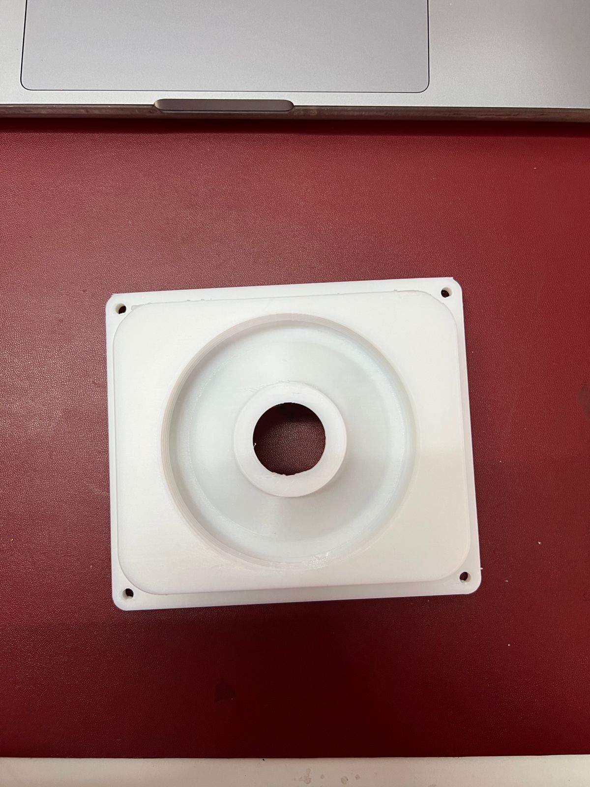

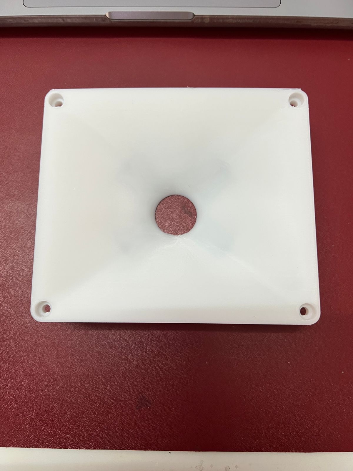

Hi, first time here. I've bought the Triotini_XS files for a DFM2535 build. The Horn has been printed, but I'm confused about choosing the flange type. I'm using FreecAD to view the files but can't make out how it fits.
Can someone help, please?
As the description says:
Compression driver mounting options with the provided flanges:
Flange type1:
  • 4x M6 / ⌀76 mm
  • 3x M6 / ⌀57 mm
  • 2x M5 / ⌀57 mm
  • 2x M3 / ⌀50 mm
Flange type2:
- 2xM4 / ⌀53 mm
There's also a "lower" version of the type1 flange, just in case that the tall flange would be too tight to fit into the thread (this is a bit difficult to control in advance with 3D printing). The lower one should fit more easily. At first I was a bit worried about the thread and the tolerances, but I think it turned out pretty well, I like this mounting method. You need a decent quality printer, of course, but that's already more a rule than exception these days.
Your prints look quite nice, BTW.
