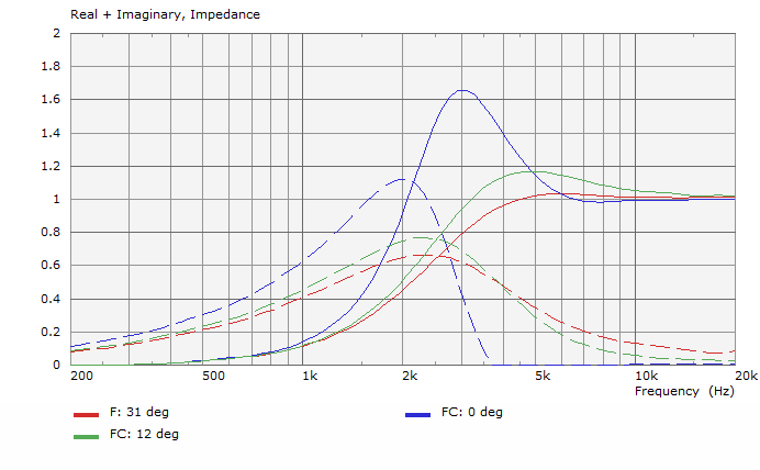

FWIW, I see similar wiggles with my 15 inch OS-clothoid waveguides, though the effect is less pronounced than what you measured. I've also seen this when measuring high efficiency woofers in sealed enclosures.I can also imagine that you've never seen this in the impedances of your waveguides

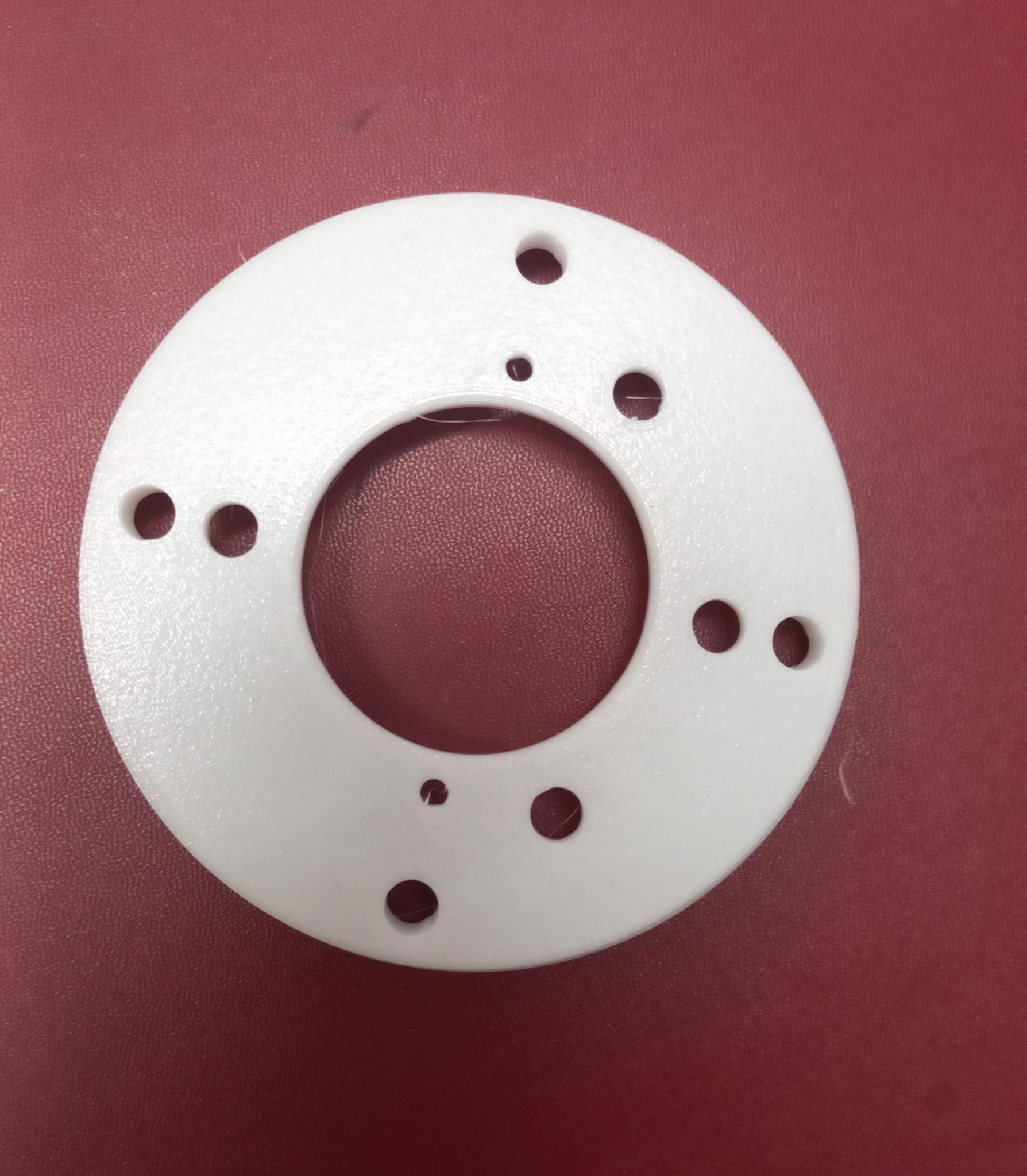

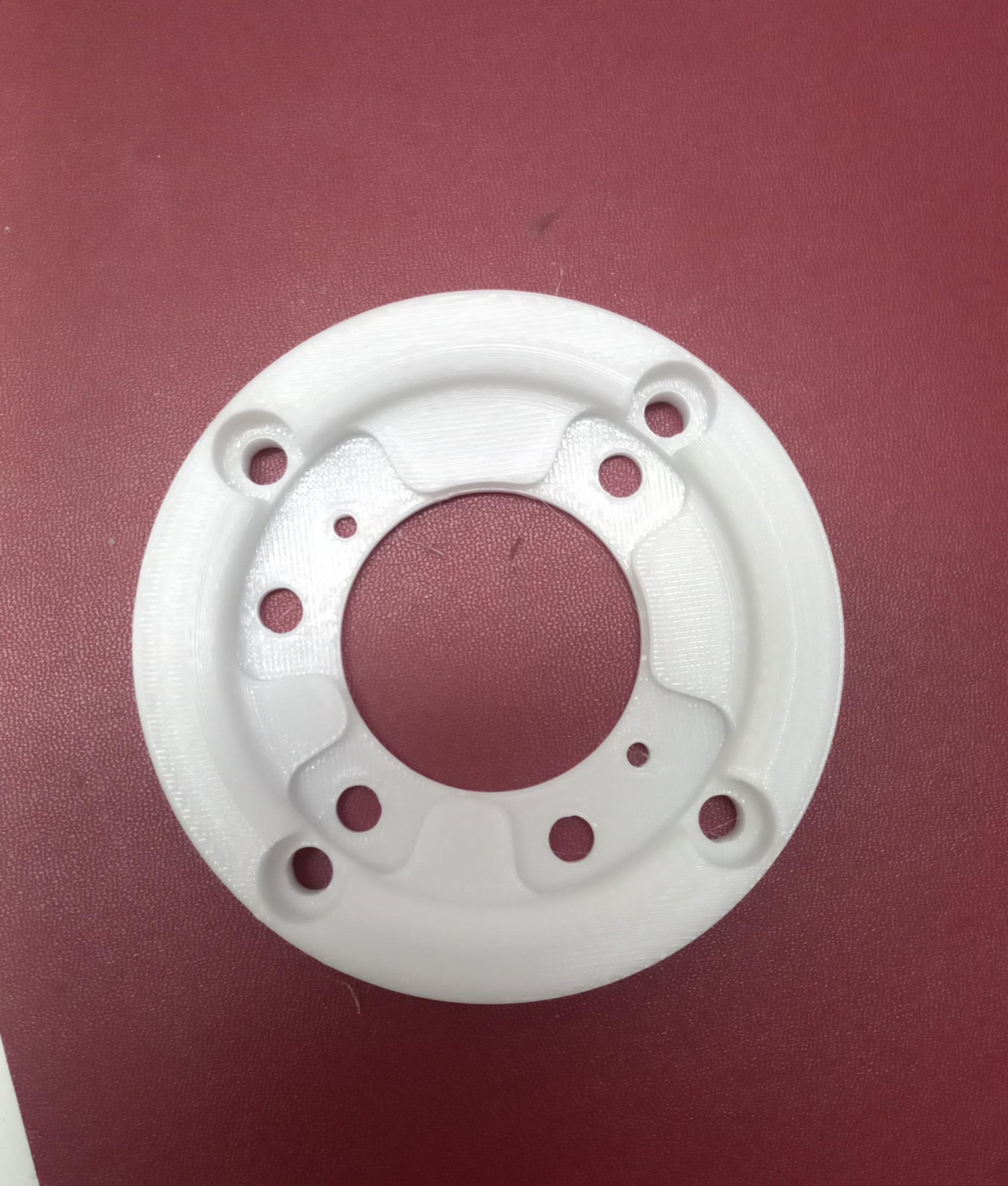

Here's the flange that goes with the Tritonia-XS.Hi, first time here. I've bought the Triotini_XS files for a DFM2535 build. The Horn has been printed, but I'm confused about choosing the flange type. I'm using FreecAD to view the files but can't make out how it fits.
Can someone help, please?
I've ever seen this only with longish-throat ("high loading") horns. Never in a rapidly opening waveguide -FWIW, I see similar wiggles with my 15 inch OS-clothoid waveguides, though the effect is less pronounced than what you measured. I've also seen this when measuring high efficiency woofers in sealed enclosures.
(We are talking about a possible audible distortion here, on the levels even tens of dB under the source signal. This is always highly dependent on the form of the distortion - from inaudible to annoying).
What about the A460D + DH450 measurement in your next post? The noise is much more subtle but still seems to be present in the ~600Hz-2.5kHz range.I've ever seen this only with longish-throat ("high loading") horns. Never in a rapidly opening waveguide
Yes, that's for a bit more slower opening throat. The difference between low and high acoustic impedance devices is just striking.
Ah. I had assumed that the throat section was the same as for the CDX1-1425 measurement.Yes, that's for a bit more slower opening throat.
That WG has replaceable throat parts - the last inch or so, for matching different driver openings.
But this can be also a difference between different drivers. CDX1-1425 is probably the least sensitive.
