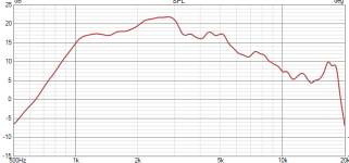

Squeeze86: what driver was used? Looks like xo around 700Hz?
Midrange: Thomann 12-280/8-A
Tweeter: RCF CD 350
XO is 1200 at the moment. But I will prefer 1000Hz
This is the tweeter with my Tritonia. I don´t think I can go deeper than 1000Hz.
True that!
But still really good results.

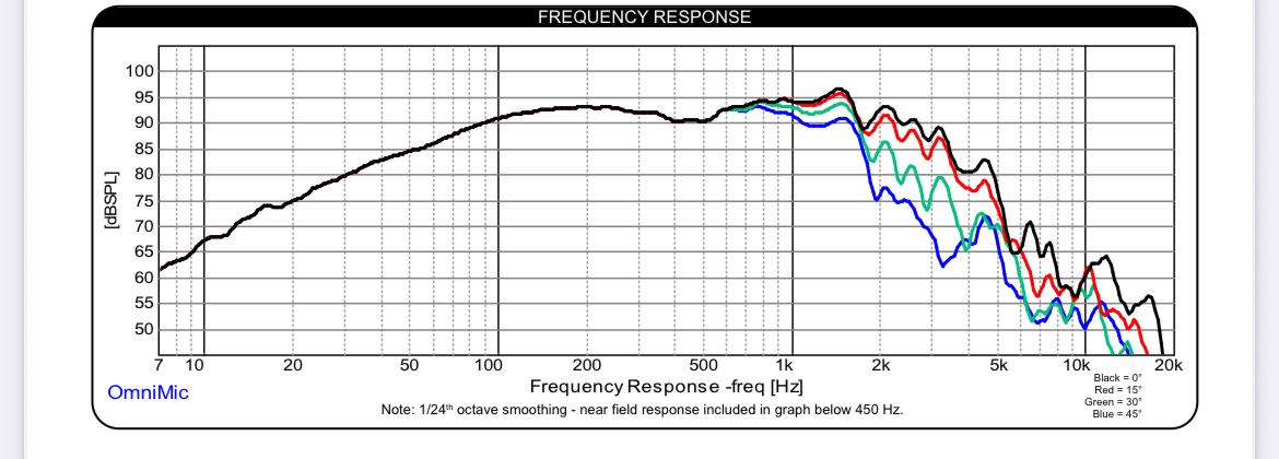

The bump at 600 Hz looks like it might be caused by the ground reflection since it's persistant on the horizontal and vertical measurements.
By all means it's an amazing speaker. Congrats @squeeze86 !
Thank you. The bump is because of my insulation on the sides. I have to experiment a bit more with this. Perhaps i will use Basotect like in my D&D clones.

I’m guessing everything beyond 600hz is riddled with breakup on that response. I’ll have to do some distortion measurements.

How do you figure that out? Any 12" speaker should perform well up to 600 Hz. Above all, the directivity from the horn to the woofer has to be right.I’m guessing everything beyond 600hz is riddled with breakup on that response. I’ll have to do some distortion measurements.
I’m making an educated guess based off the point at which the response and directivity suffer. This could indicate cone breakup and increased levels of distortion. People often cross at 1 octave below the problem as a general rule. That’s why I was thinking I would be better off with an extended throat and larger waveguide to bring the fb of the compression driver down.
Each 12" driver radiates directional sound starting at approximately 750Hz. This is completely normal and not unique to your model.I’m making an educated guess based off the point at which the response and directivity suffer. This could indicate cone breakup and increased levels of distortion. People often cross at 1 octave below the problem as a general rule. That’s why I was thinking I would be better off with an extended throat and larger waveguide to bring the fb of the compression driver down.

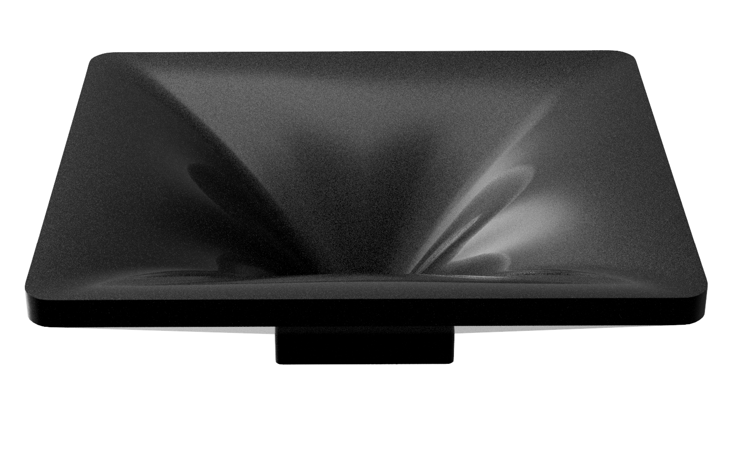

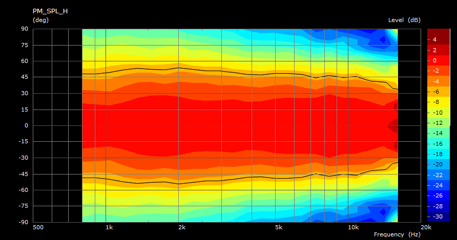

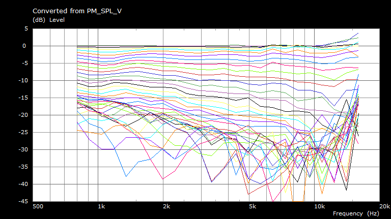

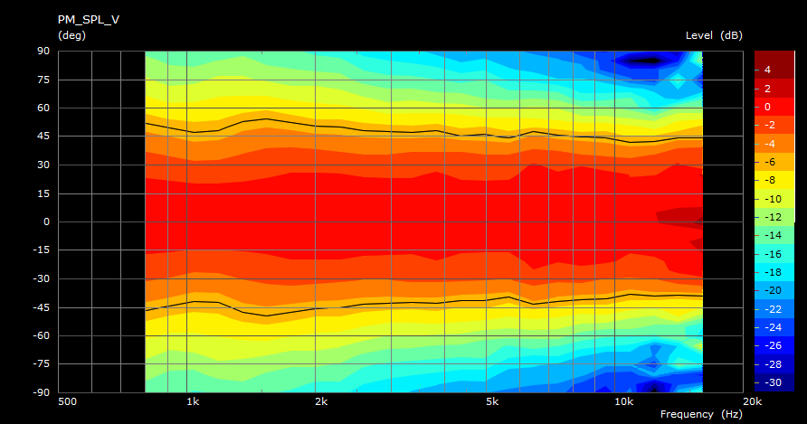

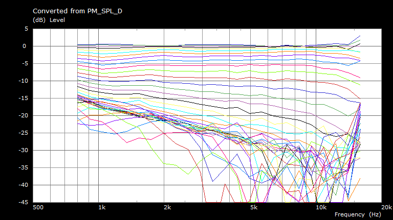

So, this is a full-scale Tritonia (422 x 364 mm ~ 16.6 x 14.3") with a 1" throat -

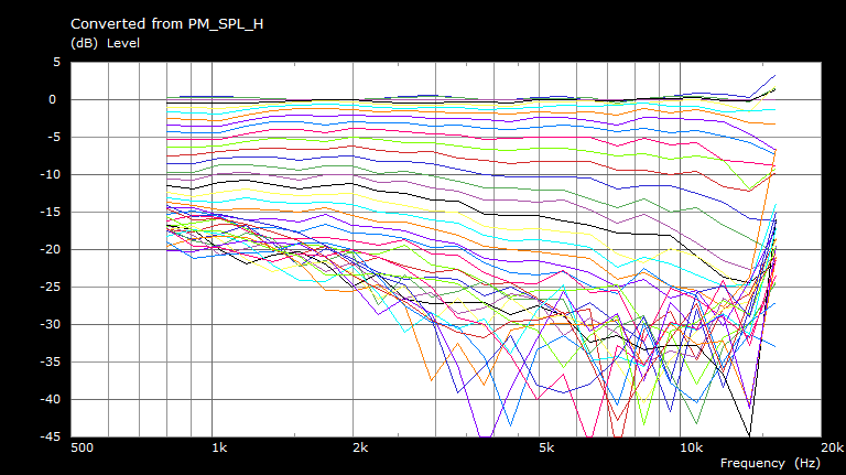

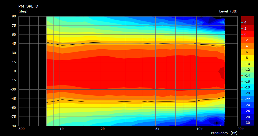

Horizontal, vertical, diagonal polars (0-180 / 5 deg):
It will be a completely different game to print it this large, but you asked for it...
Nice. That polar map looks perfect. I read that good off axis behavior indicates low horn coloration. What do you think?
What is horn coloration? 🙂
Good off axis means that there is low diffraction (or spread enough), that's certainly a good thing but not limited to horns, so...
But sure, you get extremely low diffractions and resonances with any of these devices. There's certainly no horn coloration whatsoever.
(At least unless you cut holes in the walls and make additional resonance and diffraction chambers. Then I can no longer guarantee that quality.)
