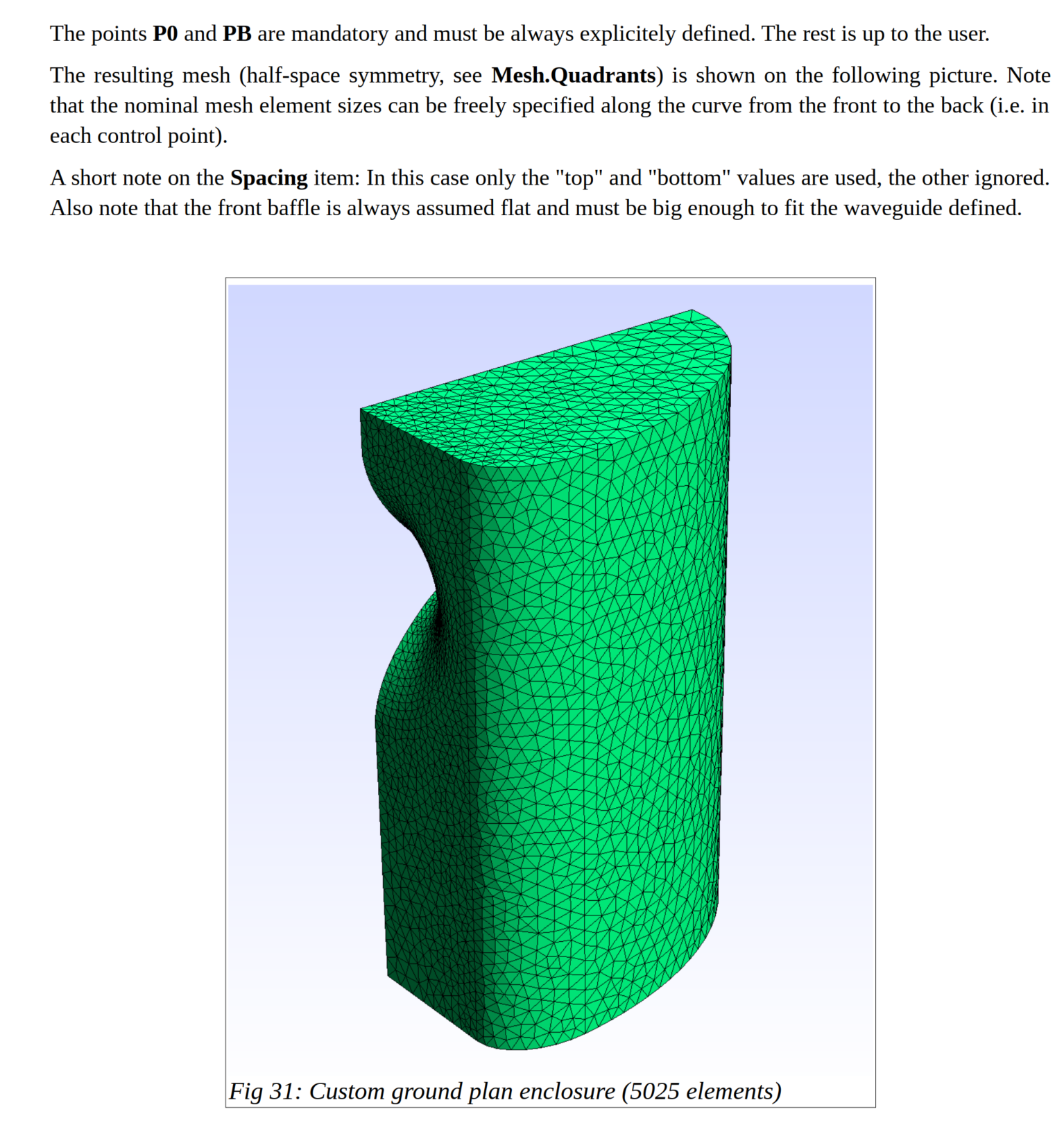

I believe there's an error in the documentation.
It states that "A short note on the Spacing item: In this case only the "top" and "bottom" values are used, the other ignored."
I have not found this to be the case. In my experiments with User Defined Enclosure Plans, the "spacing" parameter works the same way as it does when you DON'T have a User Defined Enclosure Plan.
In other words, you have to define the spacing for left, right, top, and bottom.
It's possible that Marcel may have been referring to the fact that the design in the manual is defined by two quadrants (not one) and in that case, the spacing WOULD be defined by the "top" and "bottom" and the left and right wouldn't matter.
But that's kinda confusing.
Just posting this in case anyone else runs into it, it took me some to figure out why my enclosures kept erroring out like this:

I don't see how could be the width of the flat front baffle given by anything else than the x coordinate of P0.

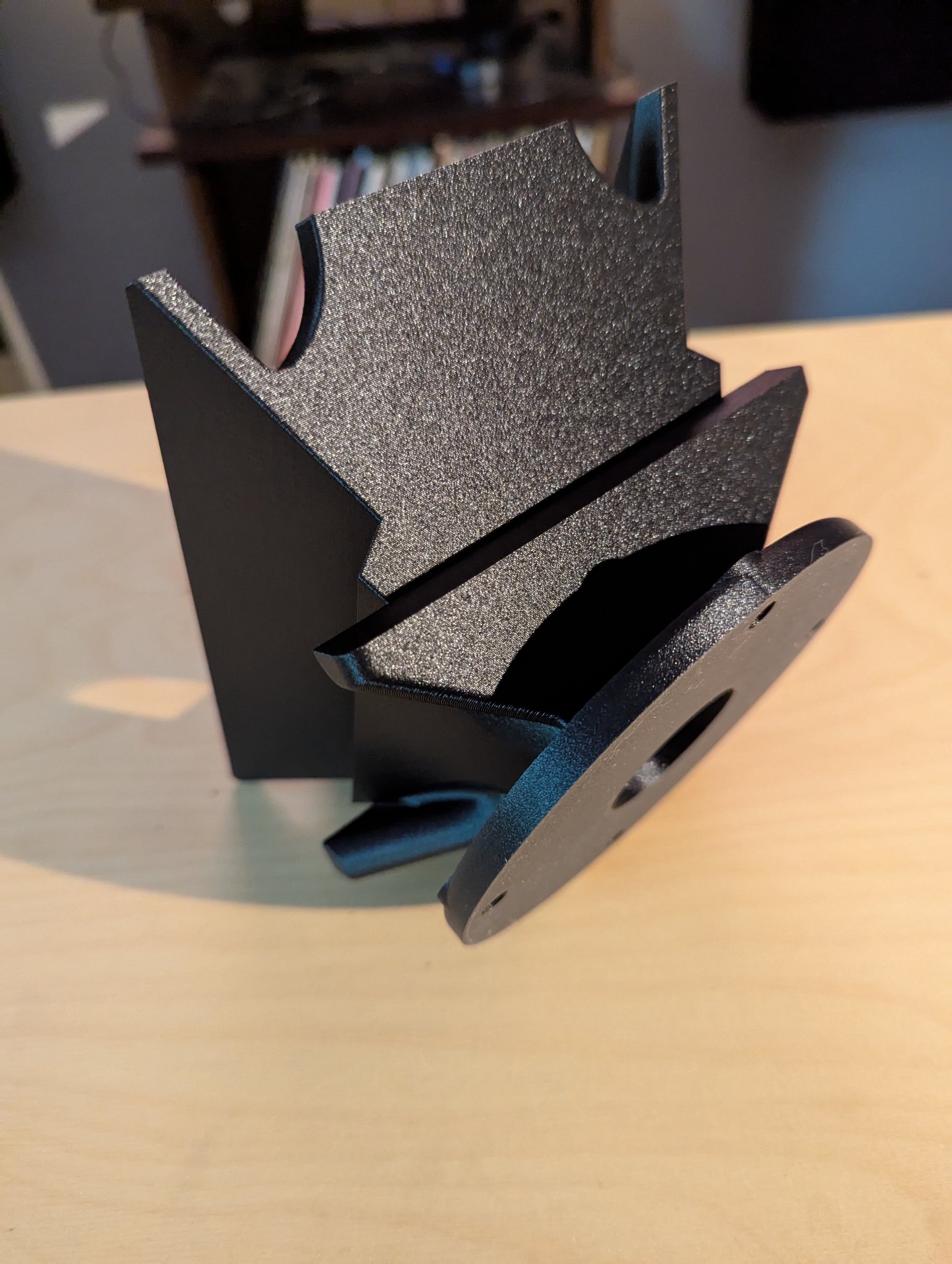

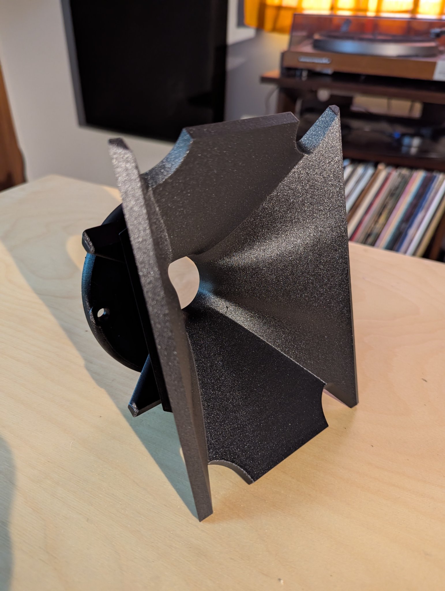

- BTW, just today, I moved all my prototype waveguides to another place, and again noticed how better are the lighter ones (at least they "feel" that way). This is again my recommendation - make the printed parts as lightweight as possible (i.e. with just a very sparse infill) and put some coating. As for the surface, I used two 0.6mm perimeters even on the largest ones and it seems enough. The overall thickness of the petals alone does wonders. (Just to be clear, this is for the freestanding horns. For the baffle mounted this could be different.)
It's all good, just took me a bit to figure it out, so thought I'd share. Things that are obvious to most people aren't always obvious to me 🙂I don't see how could be the width of the flat front baffle given by anything else than the x coordinate of P0.
Did you ever get around to printing one in PCTG? If so, thoughts?This is again my recommendation - make the printed parts as lightweight as possible
The curve P0 -- PB (the "side" shape of the enclosure) is fixed by the absolute coordinates set by the user, there should be no additional (automatic) arithmetics involved, as far as I remember. You only need to ensure that the flat baffle part (given by x_P0) is large enough to accommodate the waveguide.It's all good, just took me a bit to figure it out, so thought I'd share. Things that are obvious to most people aren't always obvious to me 🙂

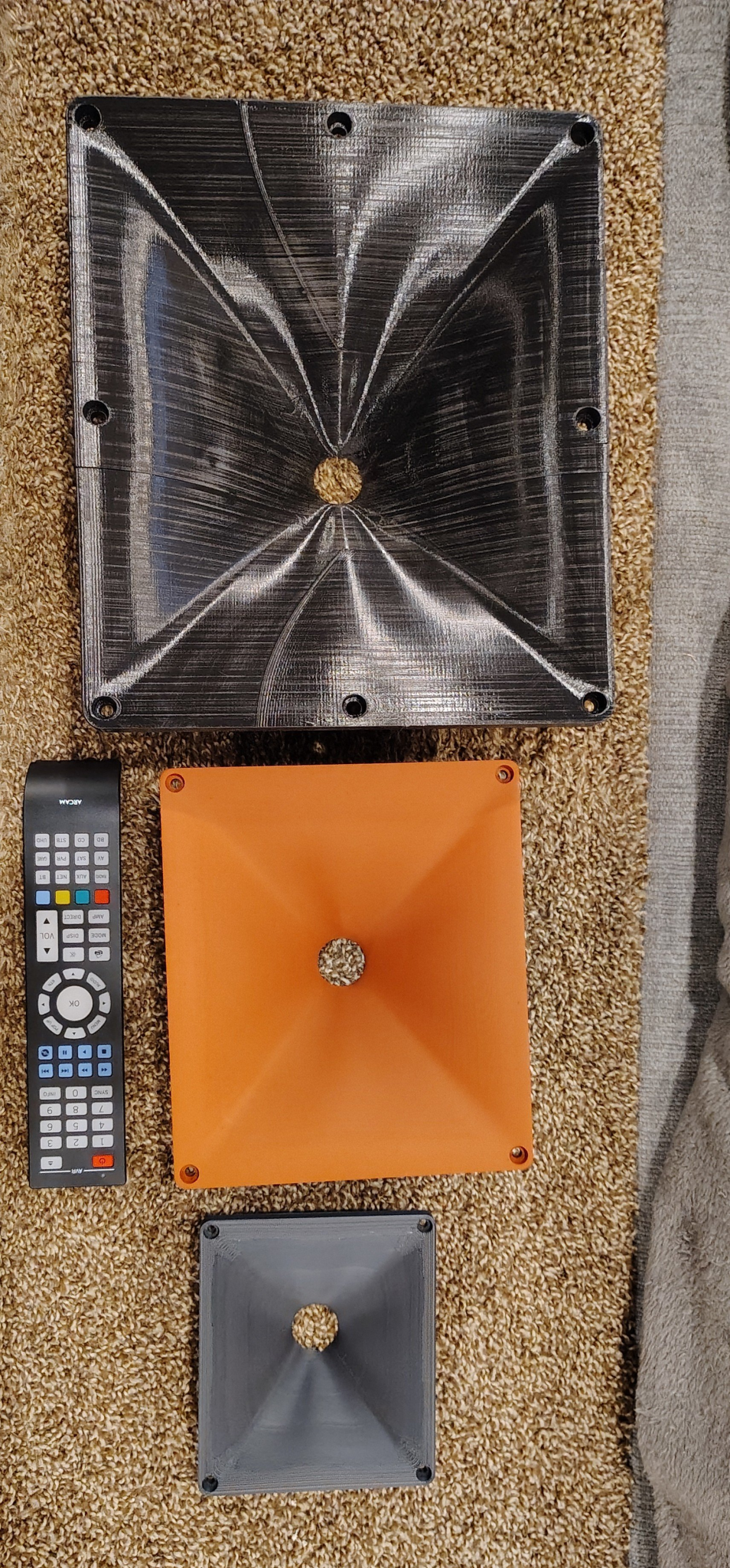

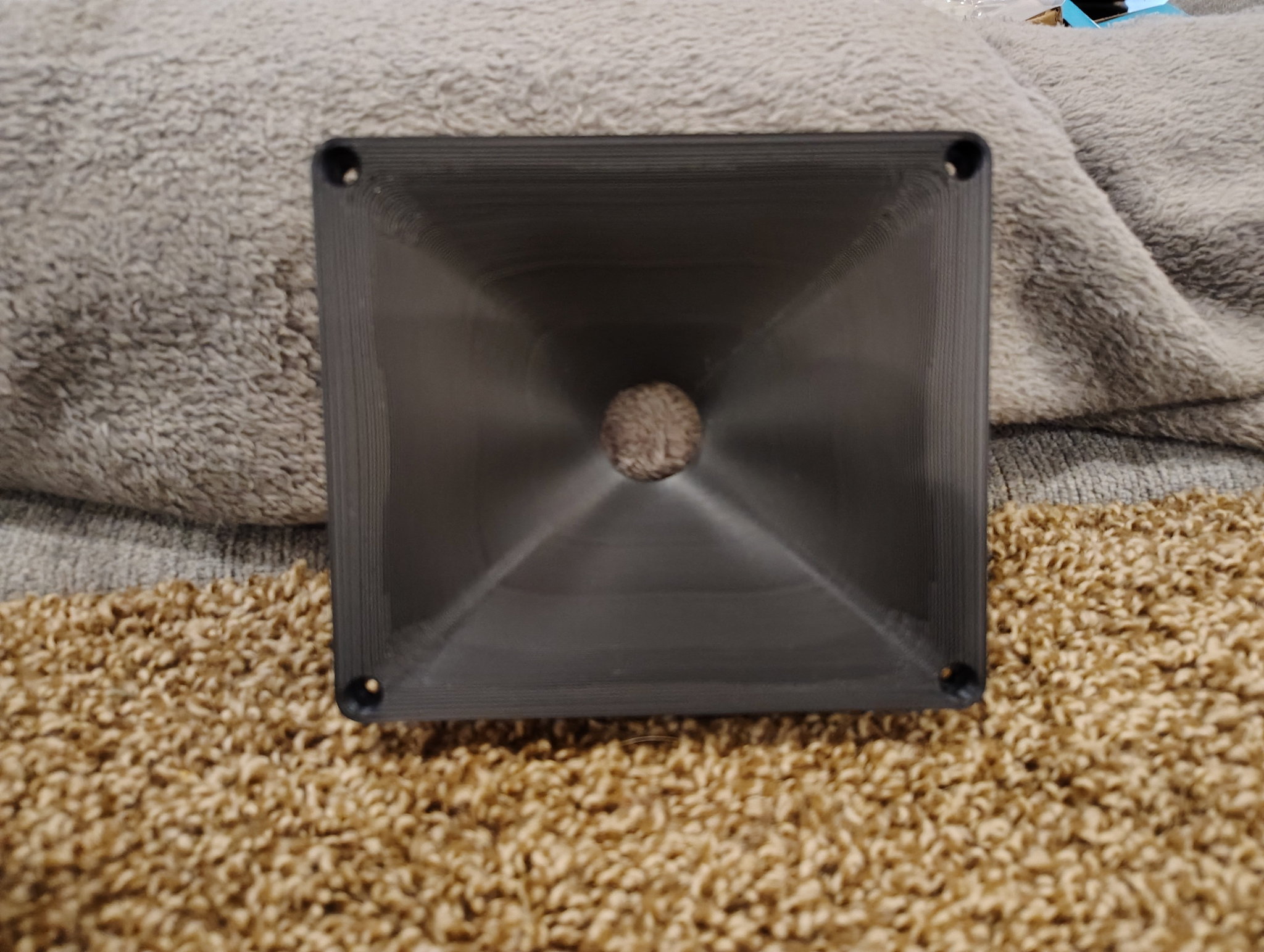

Just printed the Tritonia XS. Here it is with the -S and -M for size comparison.
Mickey
Mickey
The -S was printed with a Bambu X1C in Sunlu PLA+ 2.0. The -XS was printed with my new Bambu H2D in Sunlu silk PLA+. The -M was printed in PETG from a printing service. It did not turn out well, which drove me to purchase the H2D printer. I have a new -M printing as I type this. I will post pictures when it is done and I return from a work trip.

So X1C prints better than the new H2D? The S one in orange looks like it has been sanded already!Just printed the Tritonia XS. Here it is with the -S and -M for size comparison.
Mickey
Yeah I've had some good luck with polymaker PETG-rCF08. Seems pretty strong too. Needs a hardened nozzle though.On his Instagram, @galucha shared some incredible results with PETG, with a long print time of 14 hours for a throat-piece of a MEH.
