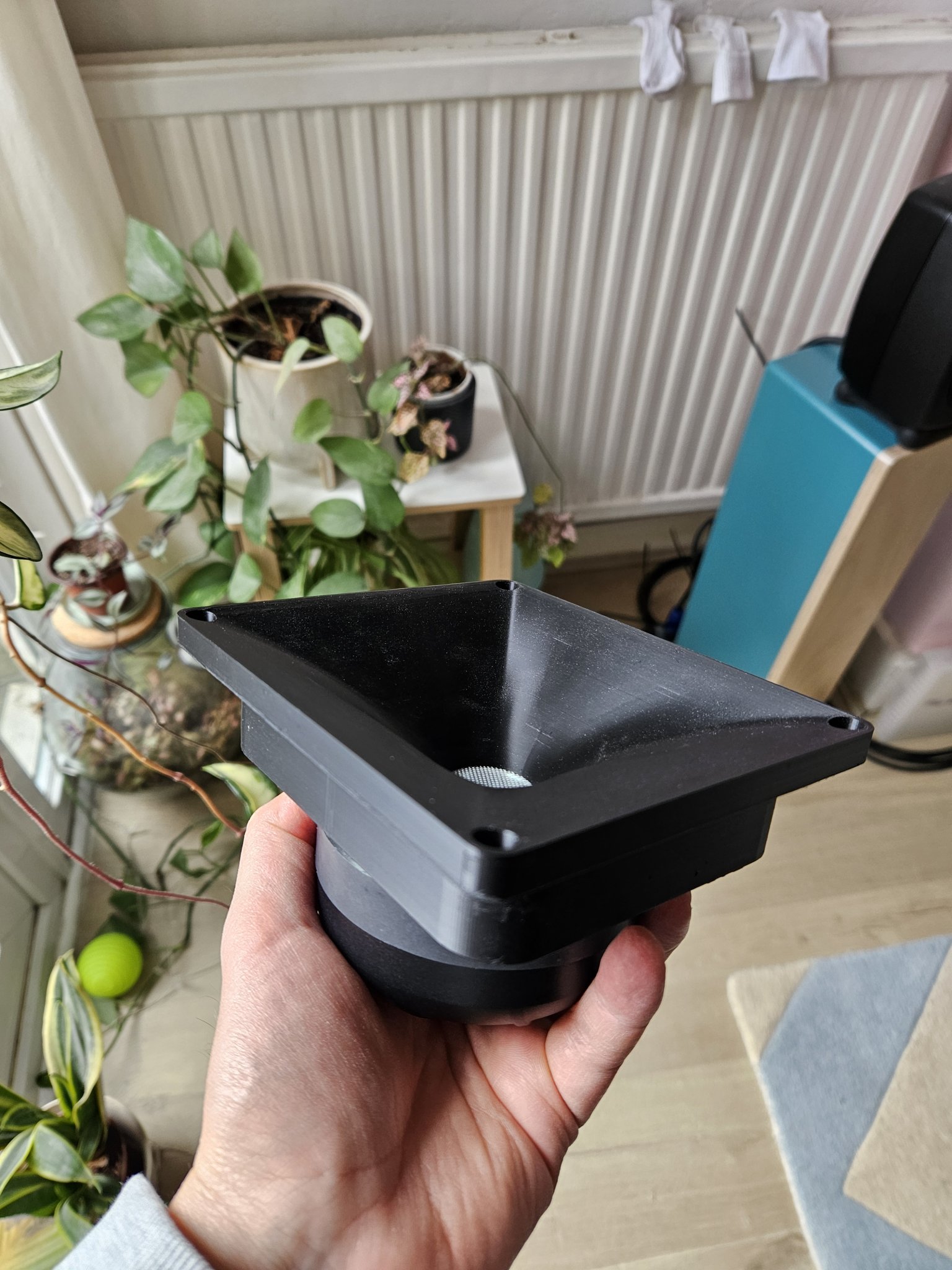

My impression after reading way too many Synergy/Unity/MEH threads is that a lot of builders find that putting the ports in the corners doesn't offer as much advantage as expected, and in some cases it makes construction harder. I don't have direct evidence one way or the other, because I've only gone the "in the corners" route. I'm in the process of printing a cylindrically symmetric horn where the corners question is moot so I'll soon find out if I'd be better off with corners to hide midrange ports in. Even the rule that ports shouldn't be closer to the compression driver than lambda/4, where lambda is the wavelength of sound at the midrange's upper frequency limit, seems to have lost some of its Holy Commandment status.

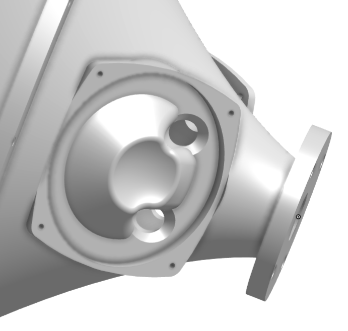

I'm going to try the blend of volume filling and "frustrumizing" shown in the attached image (midrange driver: B&C 4NDF34). The wavelength at my target crossover frequency of 1250 Hz is ~27 cm so my guess is that some of the fine details of the frustrum shape don't matter unless they cause noisy turbulence of some sort. But no frustrum may yield a Helmholtz resonator with a frequency that's lower than intended. Again, I can't prove any of this; they're just working assumptions that I may come to regret! The Helmholtz part seems pretty well established by others, though.

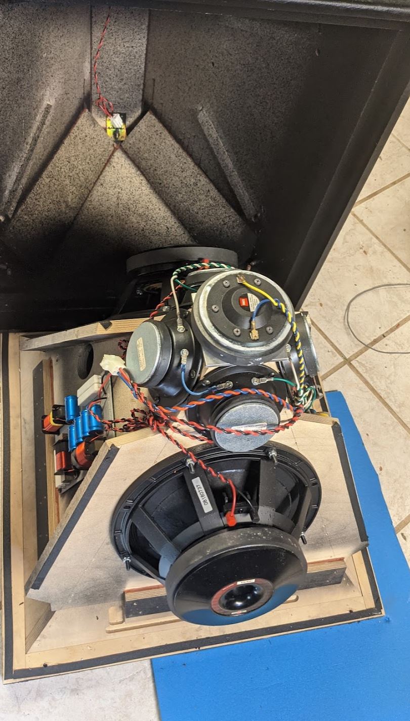

It's the real deal.... A guy put up a good disassembly thread...lots of pics. Wish I had the link to give...

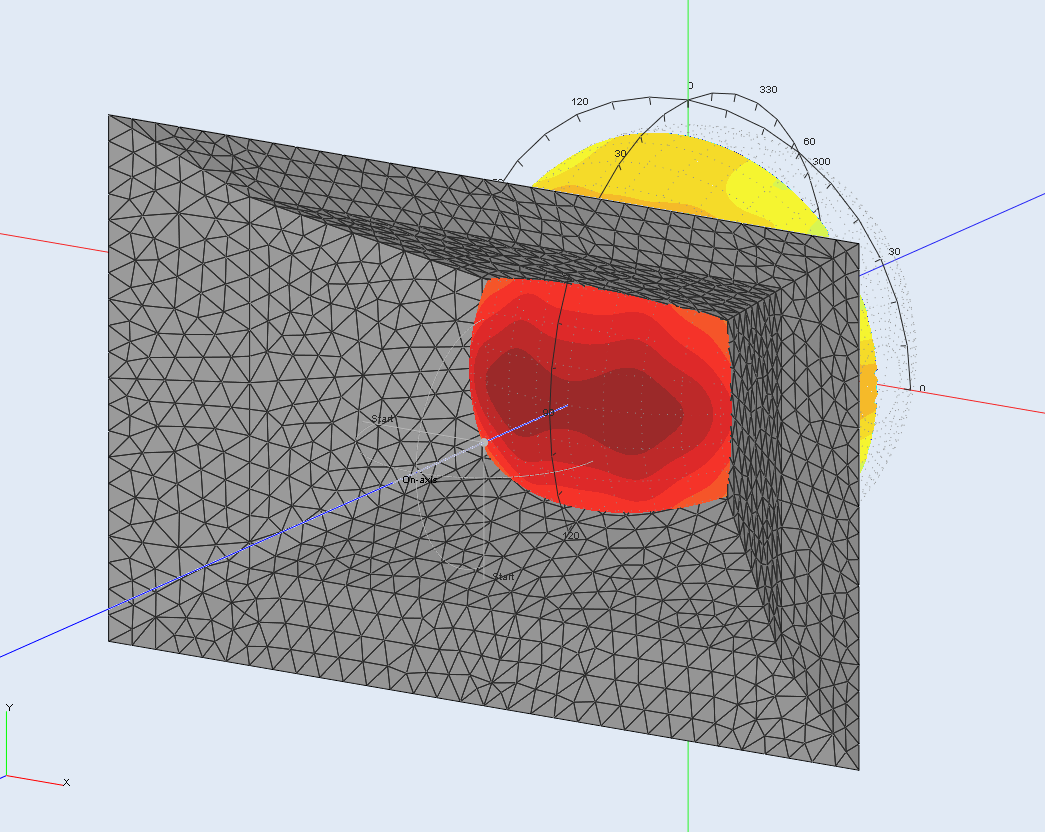

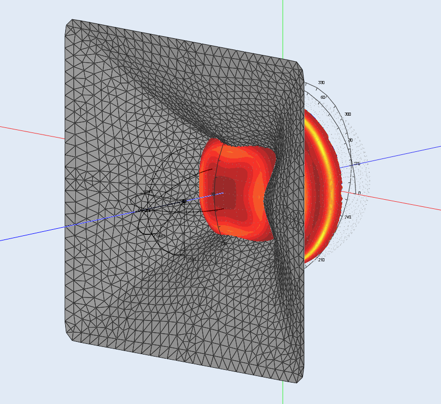

I've started a new habit of setting up an observation field (sphere) in akabak with every new MEH where the radius of the sphere equals the 1/4 wavelength @ crossover frequency to approximate where the ports will be. Wherever the sound energy is lowest (generally in the 3-8kHz frequency region) is where I'll place the ports. So in the below example of a profile generated in Ath, you can see that the corners may actually not be the most ideal spot, and the middle of the walls would be better.
Whereas the below example shows a pyramid shaped conical horn where the opposite might be true:
Right now the challenge is figuring out exactly what frequencies are important to look at in the observation field as there can be some variation, but in theory you can calculate where the lobes/cancellations from diffraction would occur, and use that to inform some more decisions around port placement. I'm working on a more thorough writeup with data/physical prototypes to back up these claims, but figured I'd share since there's a lot of interest lately in 3d printing MEHs and depart from the traditional conical shapes.

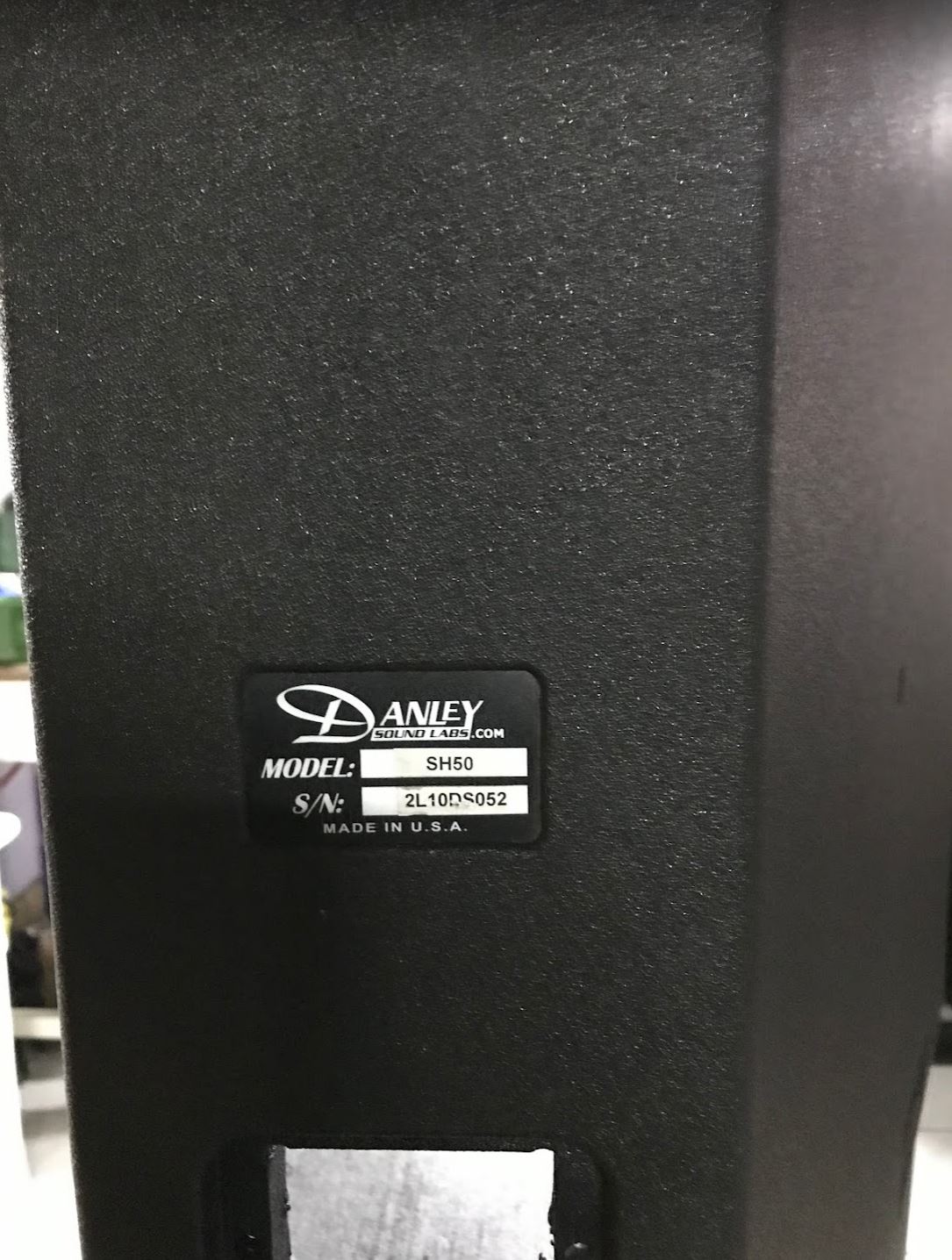

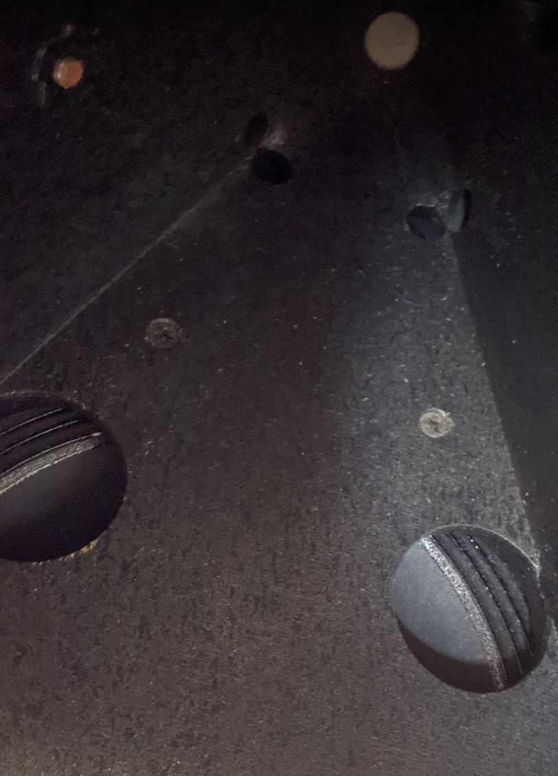

If the pic with the MF driver removed and the ones @mark100 posted are both from SH50s, could it be the taps are drilled at an angle, thus appearing more central on the outside, and in the corners on the inside?
Added: excellent close ups btw..
I've no complaints on both my SH50 and SH60 alikes where it comes to HF horn sound (with the taps firmly in the corners) - but I've never heard them any other way.

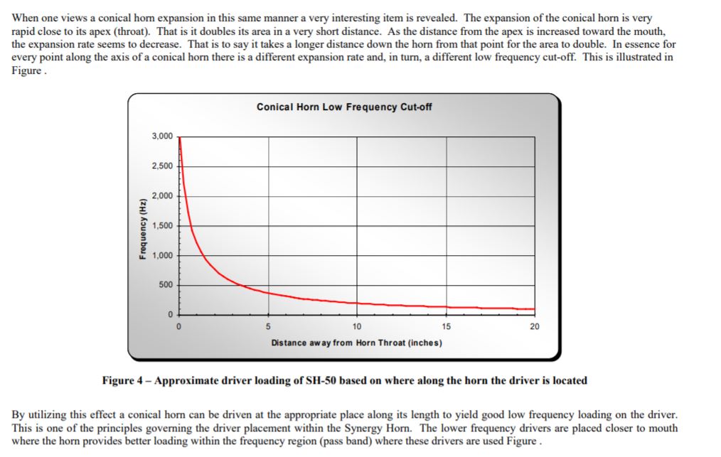

Last is low frequency cut-off and efficiency gain, along the lines of this chart from DSL website ago.
