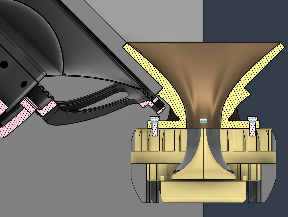

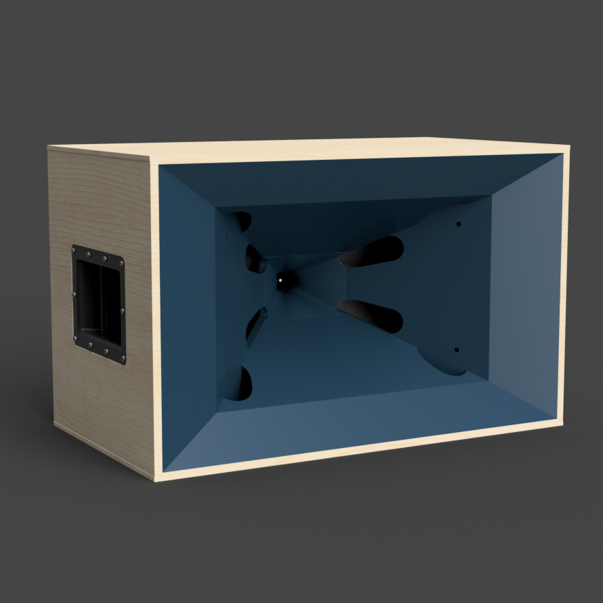

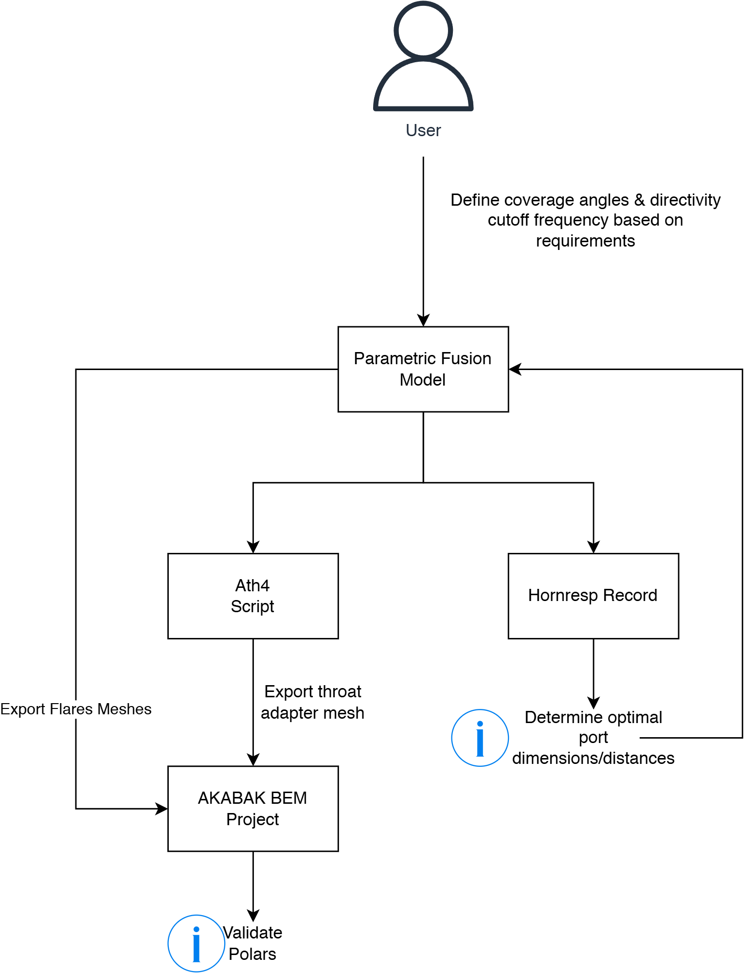

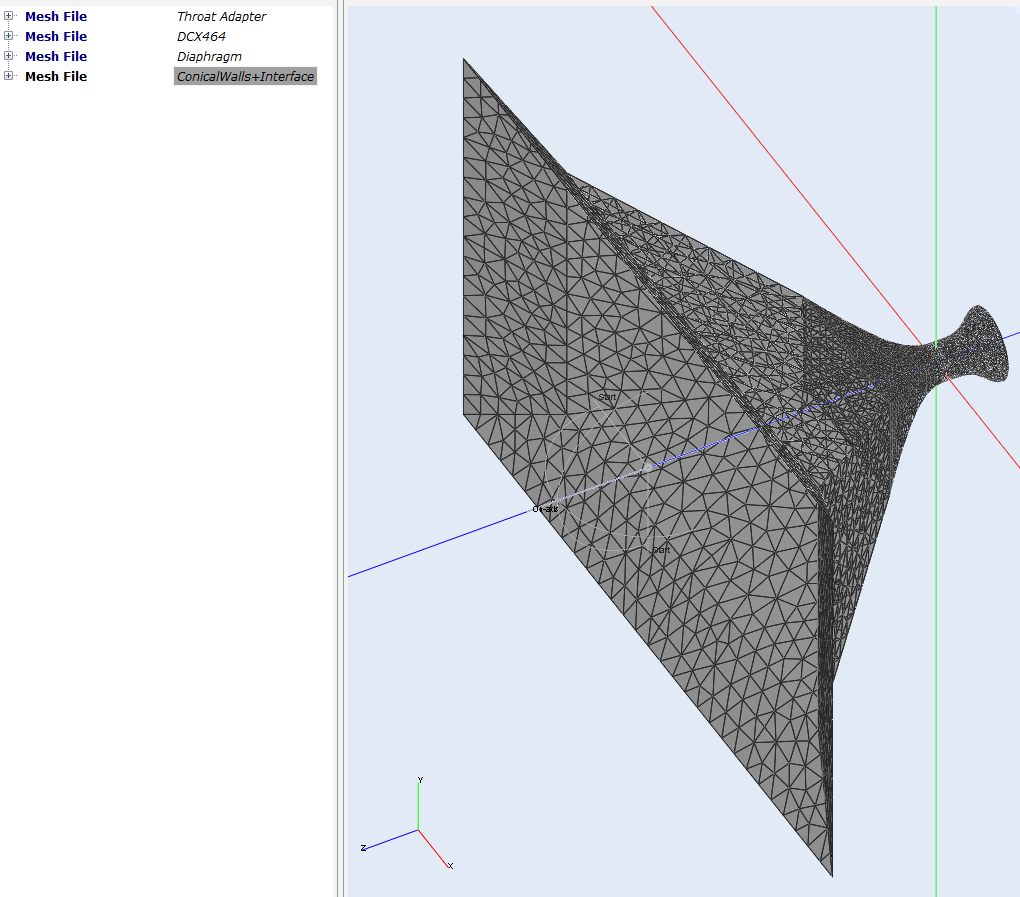

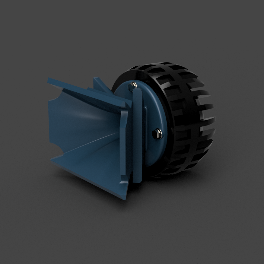

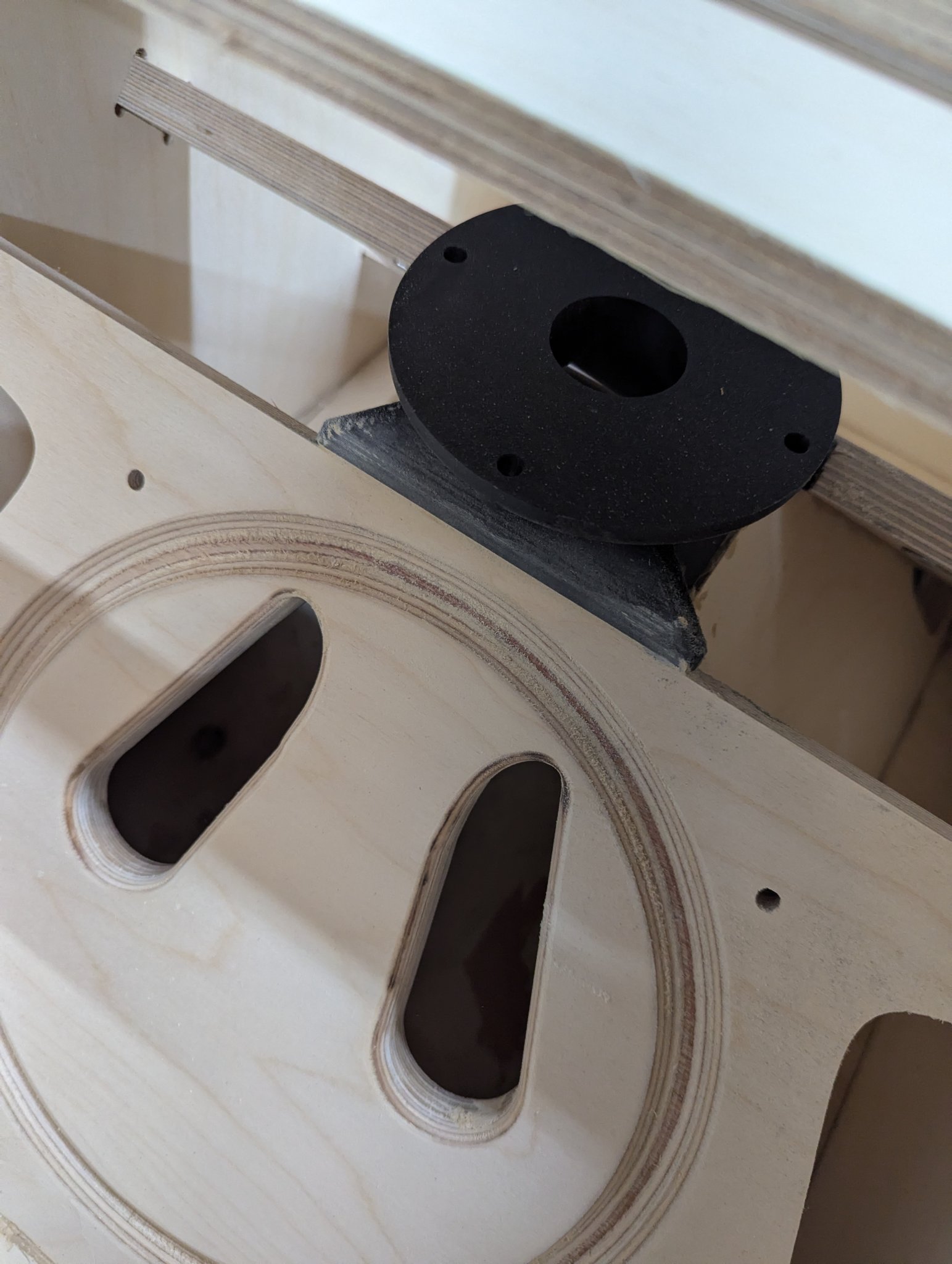

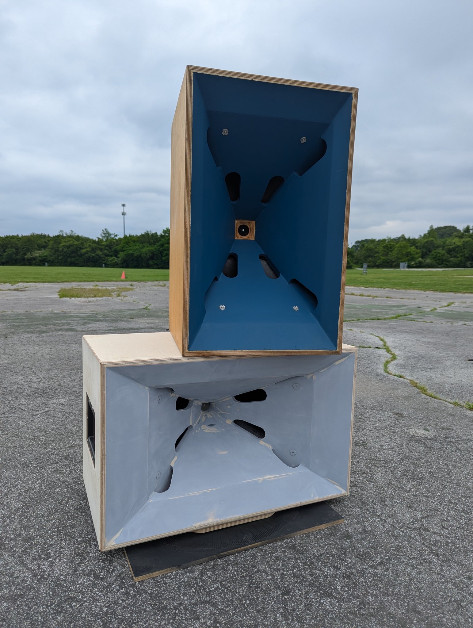

Another use-case I've been leveraging Ath for - brute force optimization of a conical MEH throat adapter. Working to create a project package so that it can be scaled for various coverage patterns, but the basic workflow was to use a parametric Fusion model to generate the straight walled conical parts of the horn as well as gather the exit width/height for the throat adapter, which is then plugged into an Ath script to create the throat adapter mesh. Those meshes are then linked to an AKABAK project so that updating pieces of it can be done by re-opening the files. The fusion file also gives the needed information to plug LEM values into hornresp. This allows for quick iteration to get the desired coverage pattern dialed in - especially helpful is being able to adjust the secondary flare ratio/length/angles and knowing exactly how that is affecting midrange dispersion.

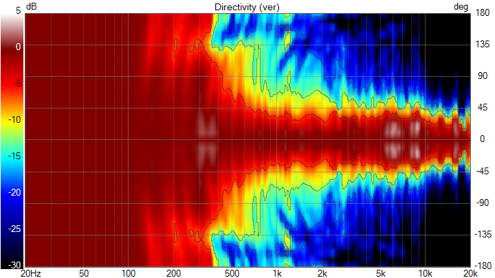

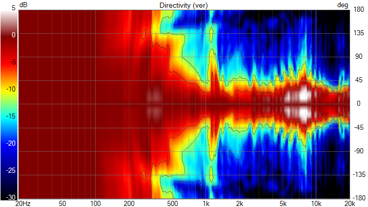

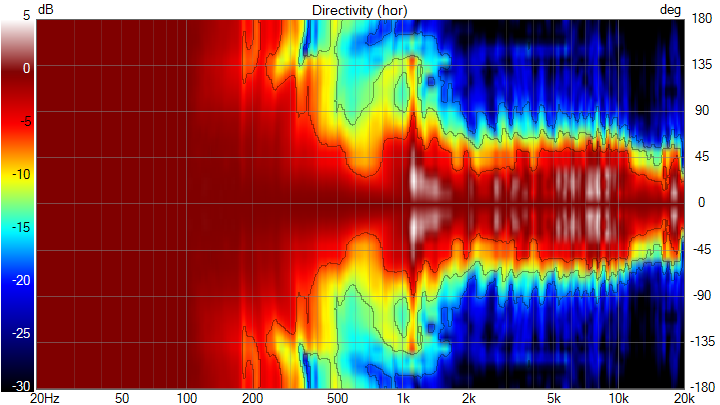

I measured the polars of this new design (pictured above in gray) against the prior version (pictured above in blue) which used a simpler lofted throat adapter to make the round-square throat transition and there were some nice improvements.
1.0 (6dB contours)
2.0
The horizontal lobe at 1.3kHz I'm pretty sure is due to diffraction from the woofer taps. But other than that, I think the results are decent given that this is a conical horn.

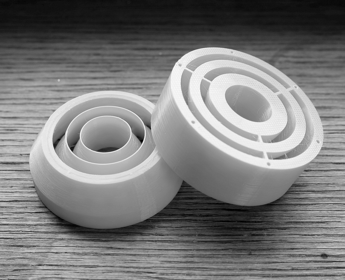

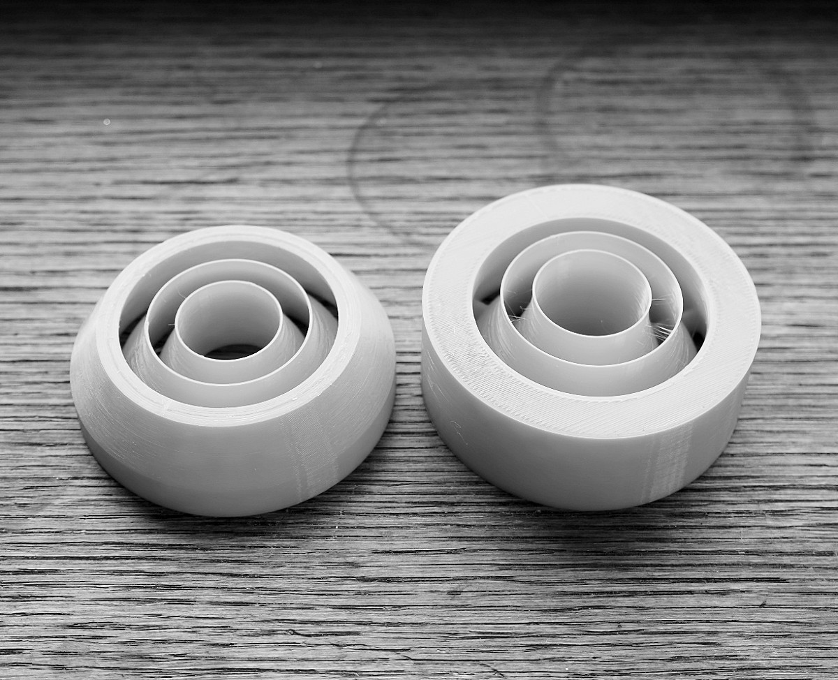

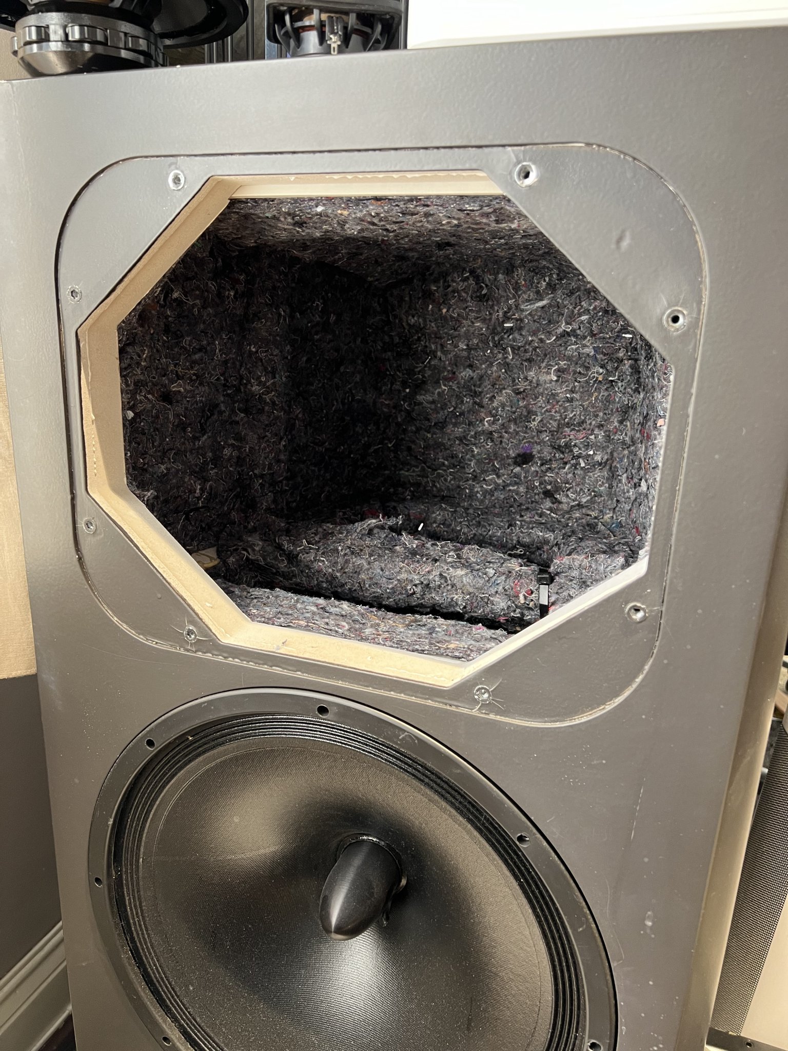

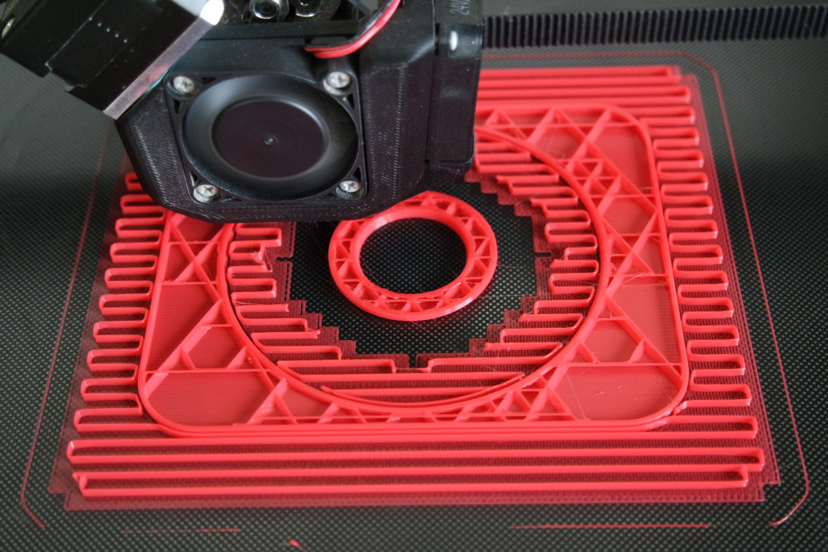

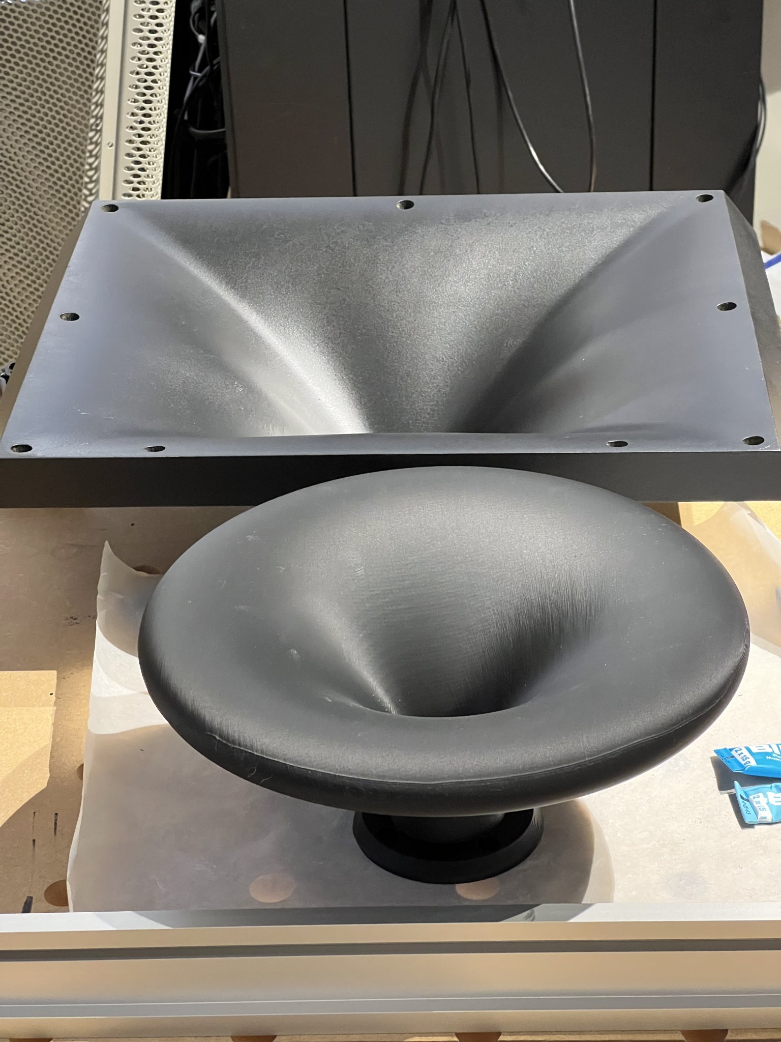

I have to give you compliments, this AXI ESP/Plug is some great work, fits like a glove.
Nicely done Marcel, thank you!
Now it's time to print/cut the A620G2 horns, measure it and maybe drill some holes for MEH.
Hopefully it does not screw up the performance to much.
(I might have to reprint, I think the random seams is too rough)
@galucha impressive work, hopefully you will create a thread of your process.
