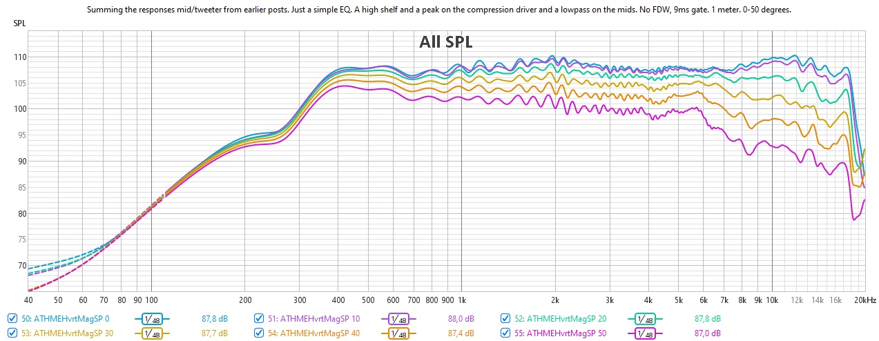

Did a simple EQ to sum the mids and the compression driver. Used 20 degrees as reference. A high shelf and a peak EQ on the compression driver and two low shelfs in series on the mids. Using the room EQ funktion in RME Totalmix.
Here is 0-50 degrees 1 meter. 9 ms gate. No FDW.

No HP filter on the compression driver its the natural roll off beeing close to 24 dB/oct.
The mids got two lowpass Q 0.7, one at 800Hz and one at 1000Hz. This resultet in a close to 24 dB/oct roll off.

This was just to see if the drivers sum off axis. Which is the beauty of a MEH.
Will optimize later, there is no delays and the compression driver needs more protection I guess.

so basically the dip in the CD results from tube resonance of the mid entry ports. also, you lost quite some sensitivity at the bottom ~ 4 dB

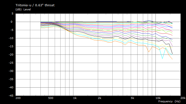

Tritonia-μ
140 x 122 mm, 110° nominal coverage
This is for 1" throat. I will also make a few more versions for smaller drivers than this (0.63", 0.5"?).
