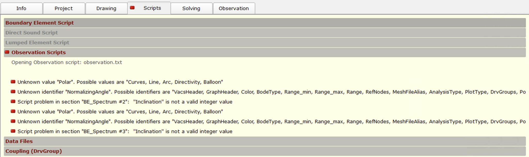

I’m running into issues, every ABEC project has errors in the observation script.
I’ve found a workaround by editing the observation.txt file: changing Polar to Directivity and removing the NormalizingAngle.
Any idea what might be causing this?
I’m using ATH-latest-231015 and ABEC 3.6.0 b07.
Here is a screenshot from ABEC, using the tritonia-s script.
It looks like you have a typo in your config file. Note the error "'Inclination' is not a valid integer value."
That error tends to indicate that ABEC is trying to interpret the word "inclination" instead of the numerical value that should follow.

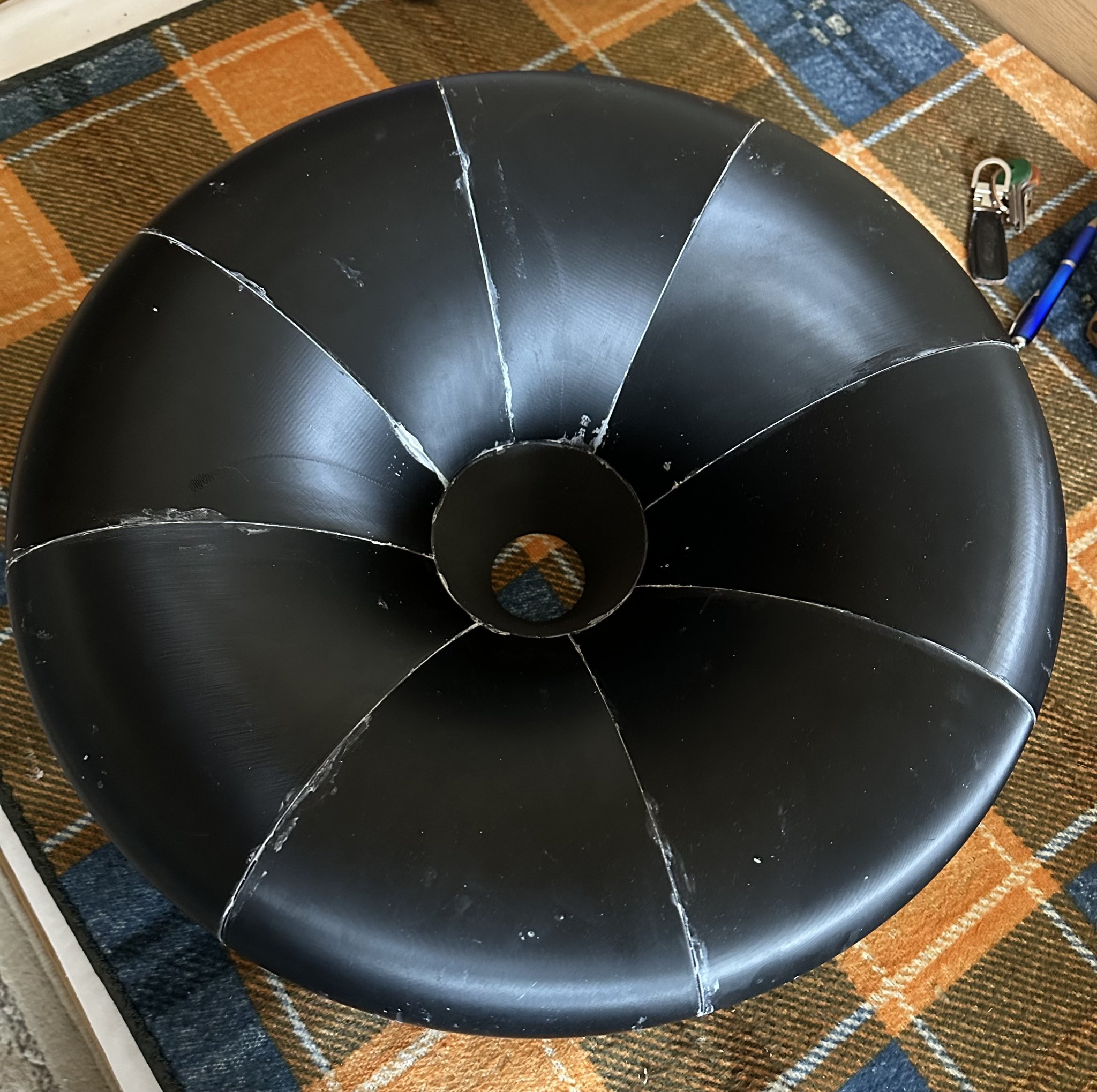

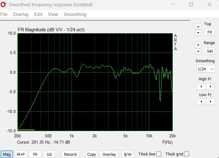

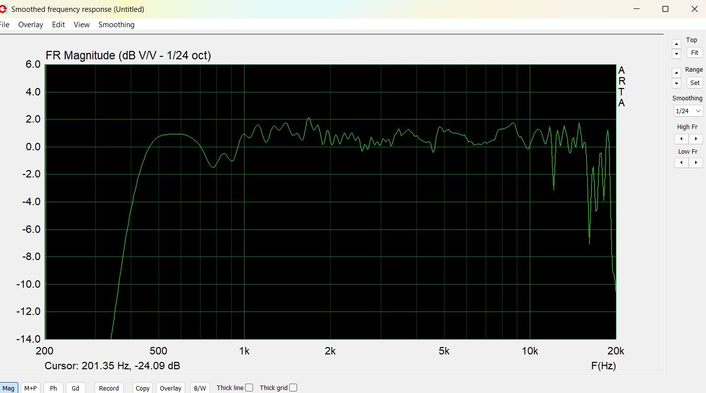

It printed fine. I've sprayed it with epoxy primer - perfect for the job. Looks cool.
So, how does it perform? 🙂

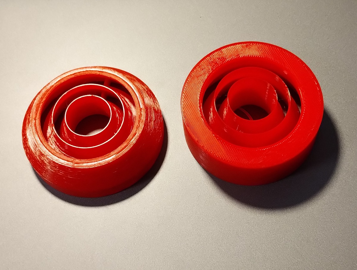

I printed mine, it went surprisingly easily (0.6mm nozzle) -

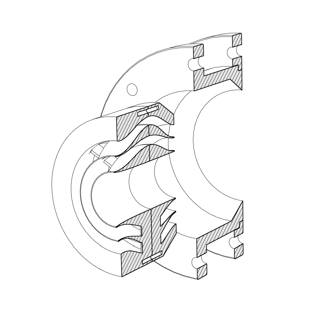

BTW, a 3-channel 80mm long ESP for the 760Neo looks also very good on paper. I'm going to try that as well, there's even a possibility to continue with the existing phase plug channels (i.e. to make the vanes at the same positions). I've no idea if it can be beneficial (Axi2050 also offers this option directly, I would only have to modify the existing plug).
I think the shorter it is, the bigger chance it will work as predicted. The above one (2") is only 50 mm long.

I'm wondering if it's ABEC that's not reading the observation script correctly. How does a typical observation script look like? Here is the one I get when I run the tritonia-m script through ath and produces the errors mentioned before.
Are the previous versions ATH available somewhere?
Code:
Driving_Values
  DrvType=Acceleration; Value=1.0
  401  DrvGroup=1001  Weight=1 Delay=0ms  // 0.00 dB
Radiation_Impedance
  BodeType=Complex; GraphHeader="RadImp"
  Range_min=0; Range_max=2; RadImpType=Normalized
  402   1001 1001   ID=8001
BE_Spectrum
  PlotType=Polar; GraphHeader="PM_SPL_H"
  BodeType=LeveldB; Range_max=5; Range_min=-45
  PolarRange=0,180,37
  BasePlane=zx
  Distance=2m
  NormalizingAngle=10
  501  Inclination=0  ID=5001
BE_Spectrum
  PlotType=Polar; GraphHeader="PM_SPL_V"
  PolarRange=0,180,37
  BasePlane=zx
  Distance=2m
  NormalizingAngle=10
  502  Inclination=270  ID=5002
It seems that you're actually using some old version of ABEC, as "Polar" replaced "Directivity" in the ABEC scripts at some point.
The Tritonia scripts should definitely work flawlessly with both the latest ABEC (3.6.0 b7) and Ath.
That was the issue! I thought I was using the latest version, but the ABEC files opened on an older version of abec that was hiding somewhere on the PC. There are no errors when using ABEC (3.6.0 b7). Thanks for your help!

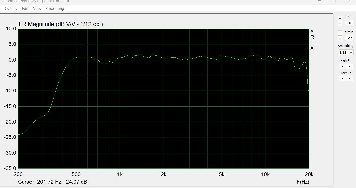

I have been working on my long term project of the unitized image waveguide from Patrick Bateman’s design thread. I measure the horn down to about 500hz, but need to transition it to a midbass horn. I was thinking of a hybrid approach to control directivity to 200hz. Basically put the waveguide (about 10” wide) into a phase plug in the center of the midbass waveguide. The “phase plug” would be abruptly terminated at the exit so it basically a horn with a rectangular obstruction in the middle - I.e. a rectangular ring radiator. The length and width or the ring would be 0.4-0.6x the wavelength of 350hz and thus have destructive interference in the horn to narrow directivity similar to the Gorbachev and Merle perhaps in filters and woofer spacing to achieve narrower directivity. Can this be done? Thanks!

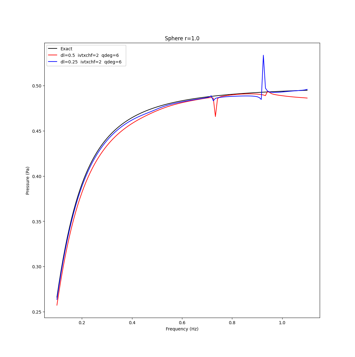

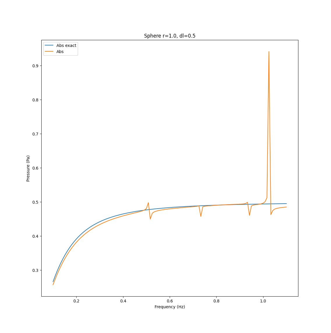

In fact, I haven't seen any spurious solutions even though I'm just using a basic null field formulation (i.e. no NUC scheme).
There are wiggles in your first plot that look like small unresolved spurious modes which will likely get more noticeable if you move closer to the body and/or resolve the frequency.
Below is the frequency sweep for a pulsating sphere using a fairly coarse grid of 540 elements. The first plot shows the first few spurious modes arising from the basic approach. The second shows the result of combining the governing equation with it's normal derivative. This shows that bempp-cl can run without spurious modes. The deviation from the exact solution is due to the low order approximation and not using enough elements.
The biggest problem I am having is that it is just too slow. The basic approach took 506 seconds for a frequency sweep on my machine and the enhanced took 1324 seconds. During the sweep all threads were in use but with the load varying between 25-75%. In contrast the basic C code I was using as a check took 5.2 seconds for a sweep with all threads used at 100%. Bempp-cl is a hundred times slower than I would expect (on my machine and my installation).

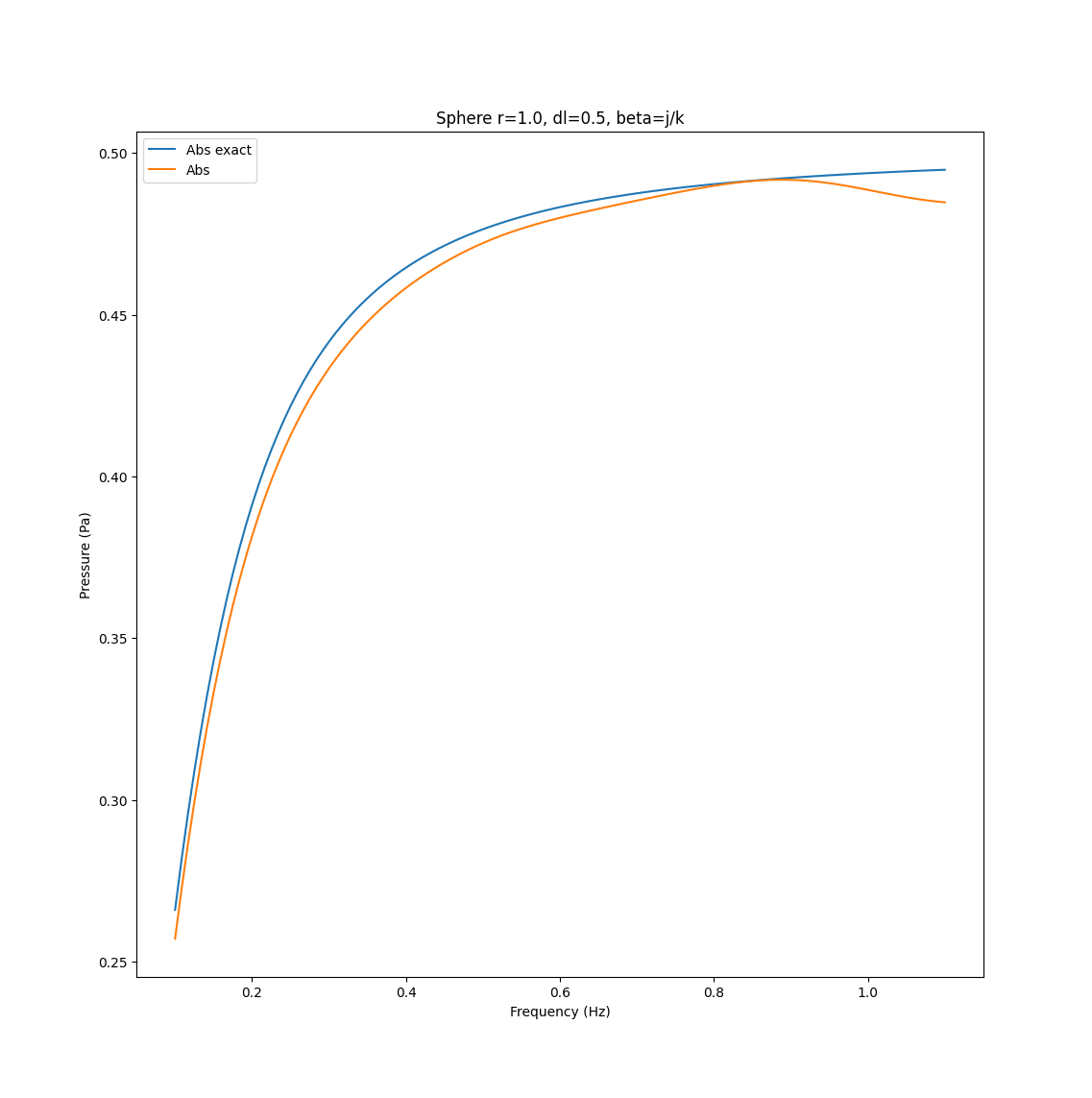

Here is an equivalent result from the basic code I am messing about with. Note that halving the mesh size brings the prediction a lot closer to the exact solution. The simulation includes an old simple fix for spurious modes but, interestingly, it has only removed 2 of the 4. The two it removed are the internal resonances of the sphere at frequencies around 0.5 and 1.0. Whatever, just including it to support that bempp-cl is producing the expected results (just very slowly).
