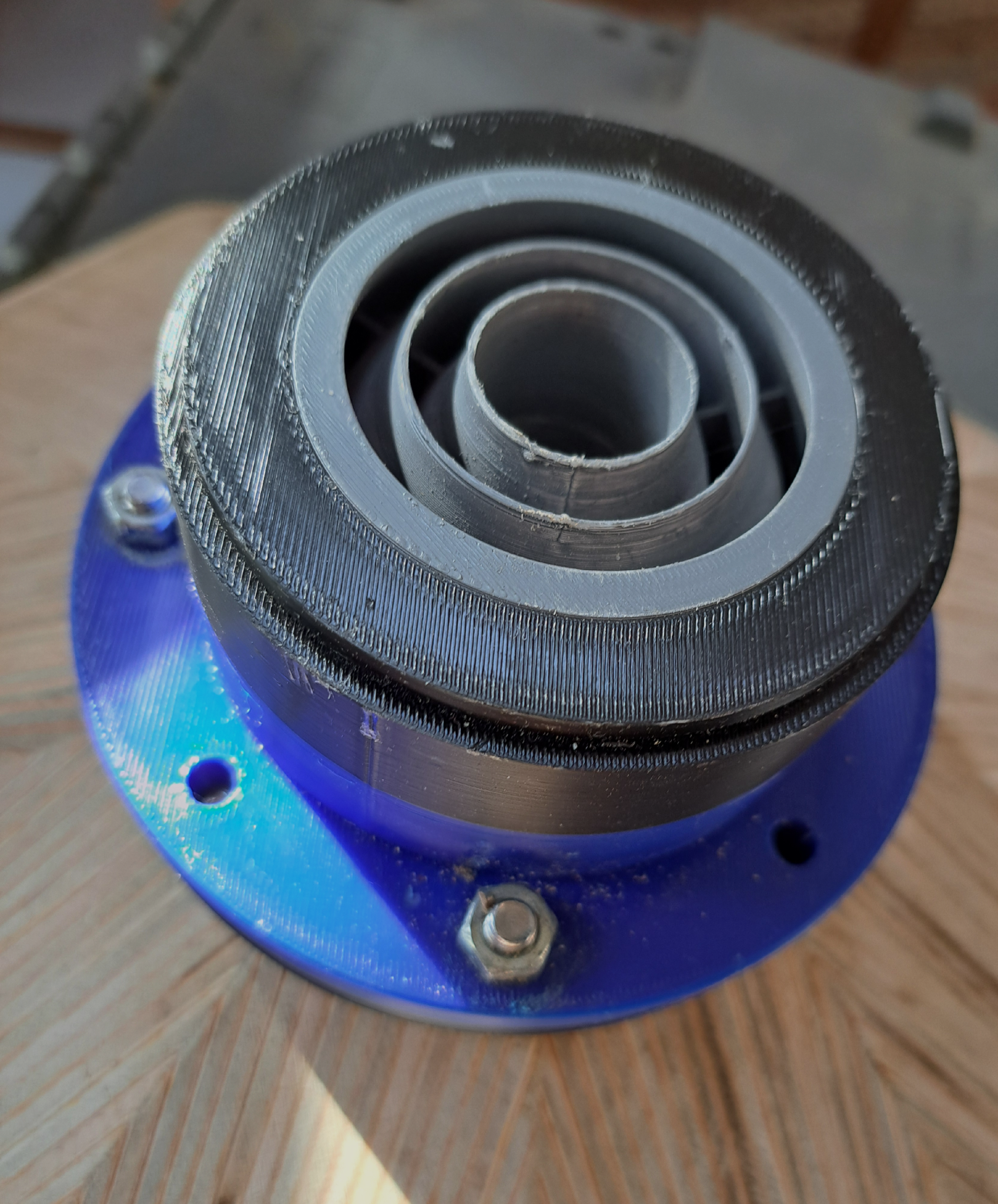

The only thing that will require some care is assuring that the printed parts are perfectly sealed. I thought about immersing the printed plug into a thinner epoxy for a while, or perhaps using a sponge brush. It just needs to be sealed, otherwise strange things can happen.
It printed fine. I've sprayed it with epoxy primer - perfect for the job. Looks cool.

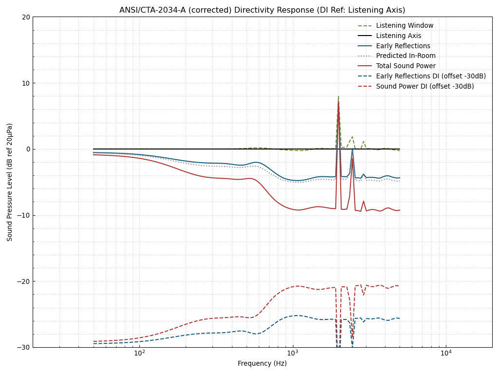

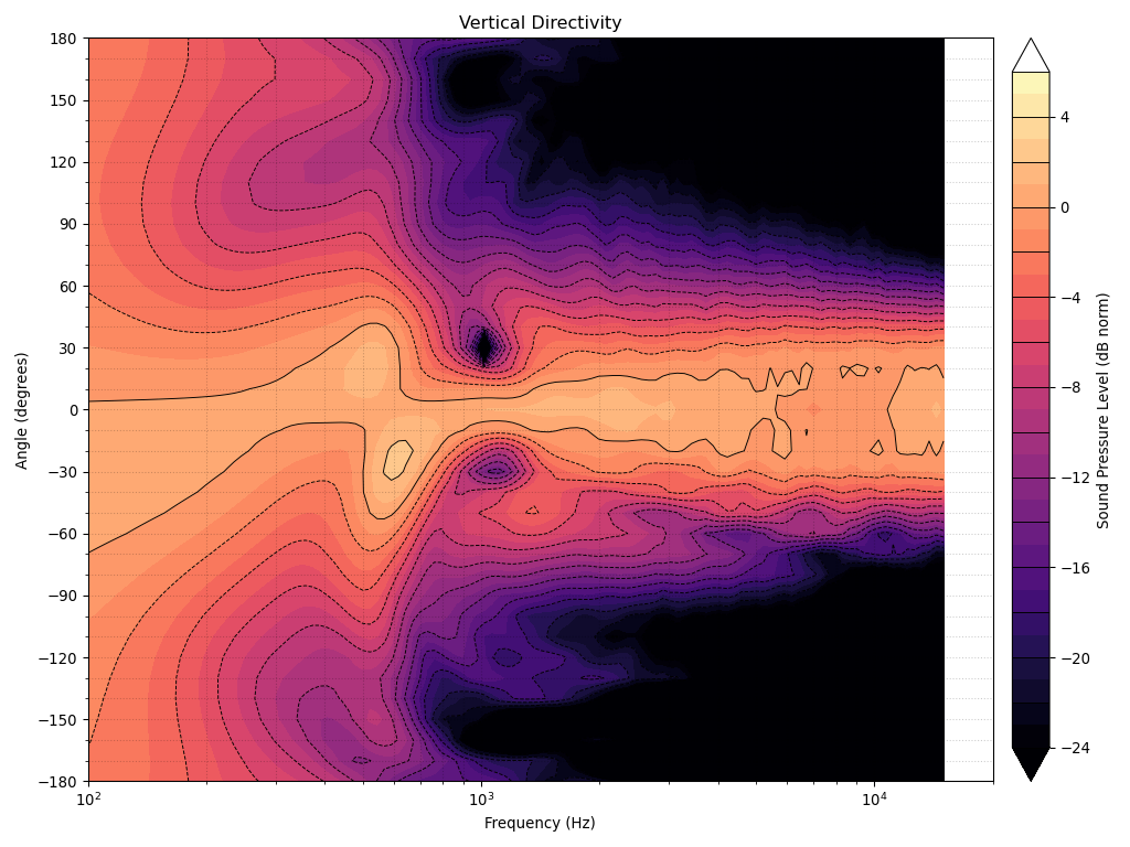

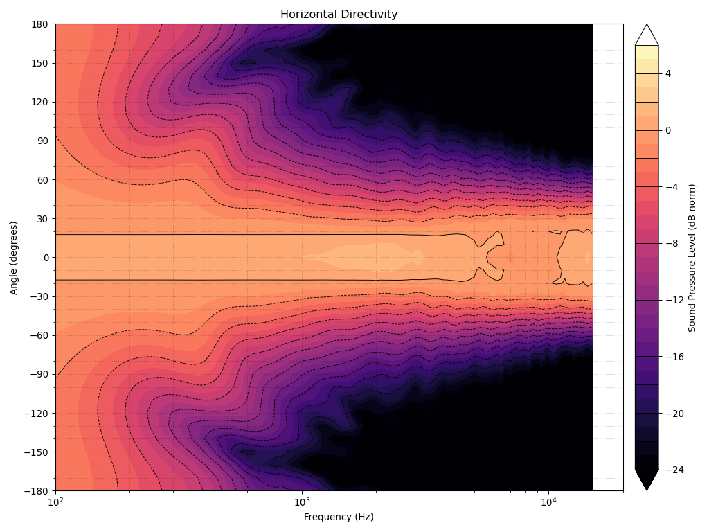

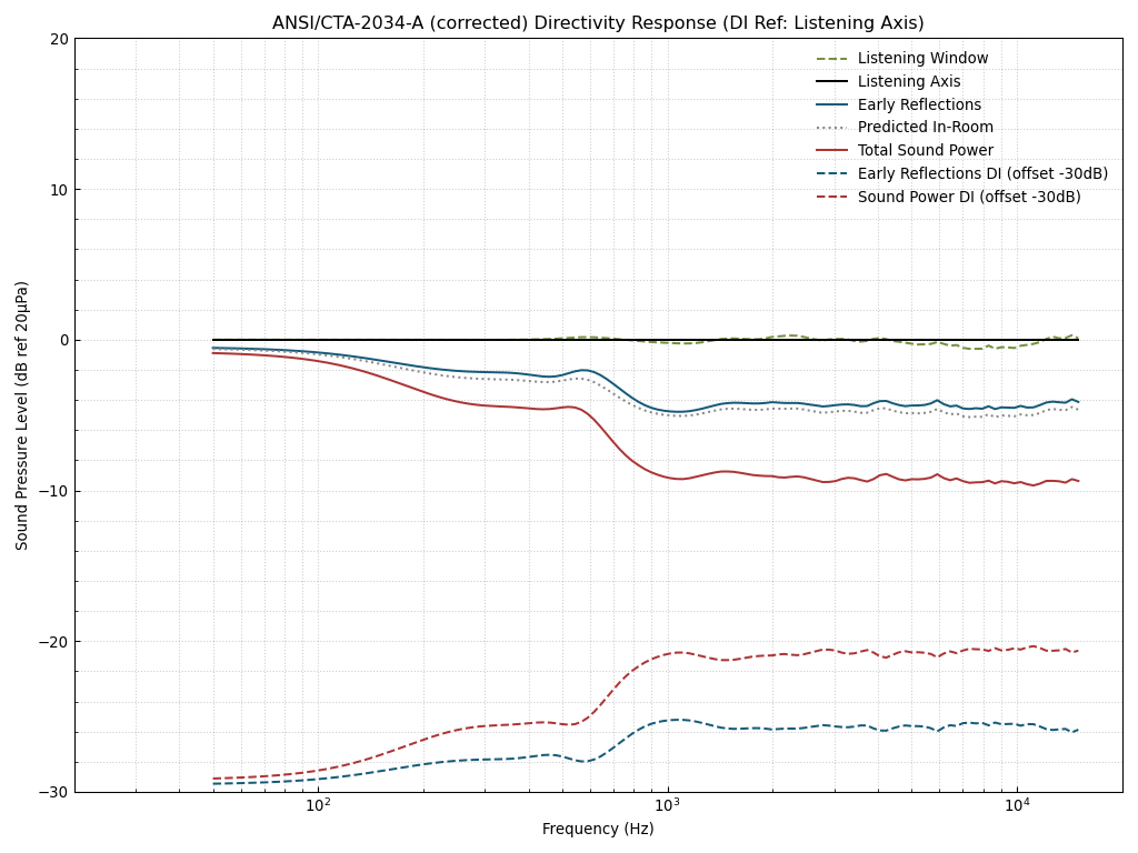

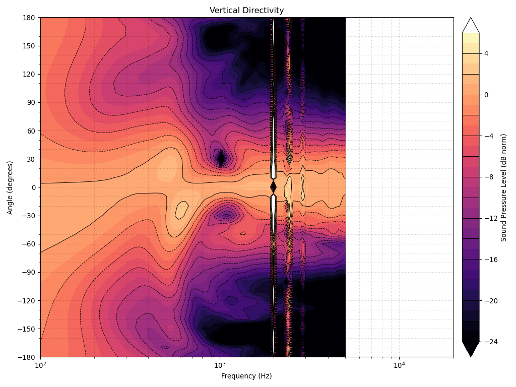

I've discovered something interesting regarding the choice of solver with bempp. All the examples I've seen make use of the GMRES solver, so I figured it was likely the best option. Two others are offered, however: GC and LU. GC is another iterative algorithm, while LU is a direct algorithm. Out of curiosity, I tried the LU solver and found that in this case, it's actually significantly faster at high frequencies and seems to be far more robust as well. In fact, I haven't seen any spurious solutions even though I'm just using a basic null field formulation (i.e. no NUC scheme).
Here's some data using the LU solver:
I used one mesh for 50-5kHz and a higher resolution mesh for 5kHz-15kHz, then spiced the results together. Bempp doesn't support symmetry, but it still only used about 3GiB of memory for the 5kHz-15kHz sim (mesh was ~14k elements).

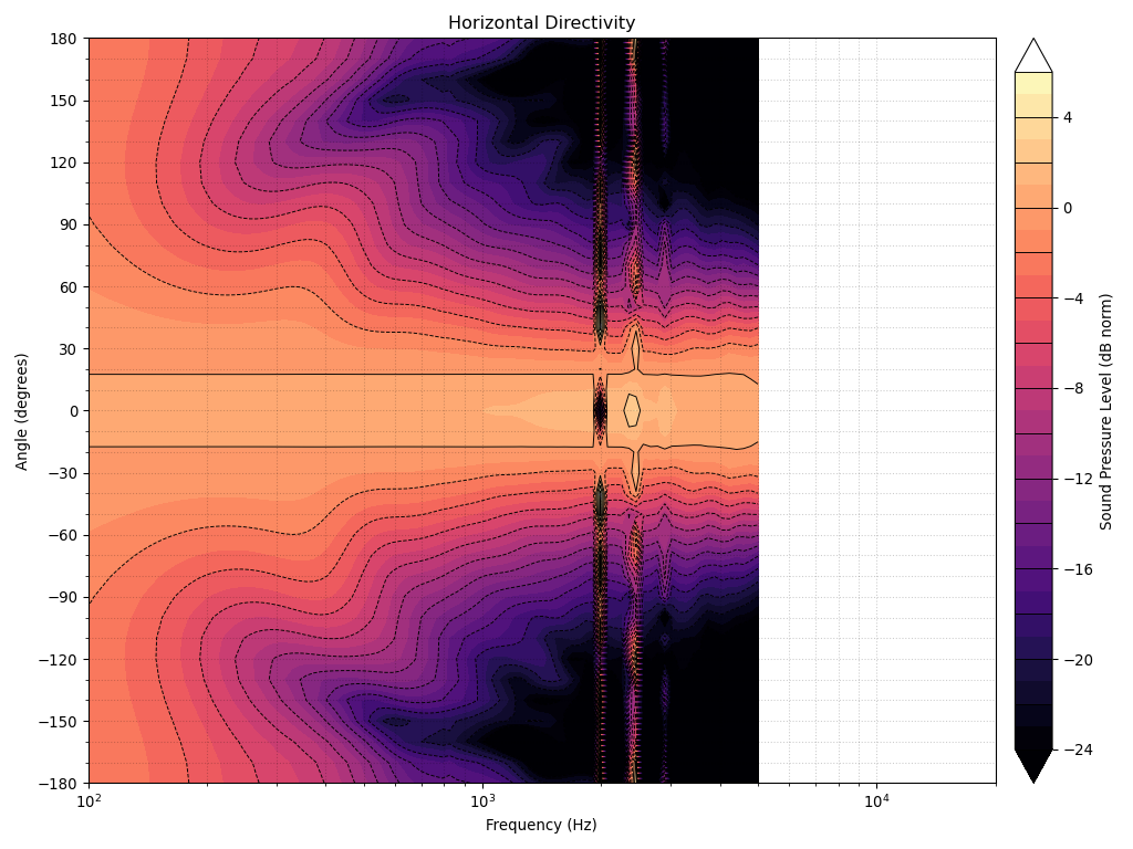

For comparison, here's what I get using the GMRES solver (same mesh and frequencies as 50-5kHz above):
How well converged were the solutions with spurious modes? If converged into round-off they are likely to give the same solution as the direct method. Not for certain though depending on the source of the spurious modes. What you may find is that the iterative method won't converge into round-off. The Helmholtz equation is difficult to solve iteratively and relies on appropriate pre-conditioners to work well. Don't know what choice your solver package offers in terms of pre-conditioning but it may be a fruitful line of investigation.
I don't know the body shape in your example but not all spurious modes are necessarily removed by, for example, adding points within the body and solving an overdetermined system, blending differentiated forms of the governing equations and the like (not sure what the current version of bempp offers). Some follow from the choice of discretisation for the pressure and velocity and which modes can or cannot be "seen" (apologies for an engineer's terminology). Bempp-cl is very limited in this respect compared to other toolkits and the dropped bempp-cpp but I think you can set 1st order on the pressure and 0th order on the velocity which may perform differently to 0th order on both with respect to some spurious modes which are not internal resonances of the body.
Whatever, you are illustrating nicely how a FEM/BEM toolkit can be used to research how best to go about solving one's problem of interest. The current version of bempp-cl is rather limited in what one can look at though. Hopefully the bempp-rust version when and if it arrives will be an improvement.
