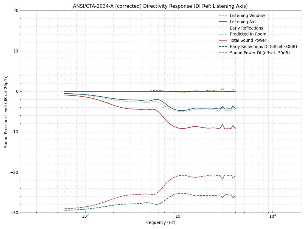

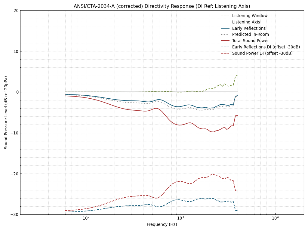

Observation distance is 3 meters. In practice, this just needs to be "far enough" relative to the size of the source.Forgive me for probably asking this again... what "mic" distance is the simulation done from and what "gate" is implied / used?
The simulation is free field, so no gate is needed.
Yes. The waveguide was completely omitted from that simulation. The reference point is unchanged (i.e. it's where the waveguide throat entrance would be if it were present) for consistency.To make sure we understood each other correctly: do I see the response only for the woofer in its second enclosure version (for the 'free-standing' waveguide), without the waveguide in place (neither firing nor reflecting)?
I haven't explored this, but it's certainly conceivable that a different crossover topology might be advantageous.asymmetric slopes and x-over points. Maybe this can counter the extra energy due to reflections without the need to cross as low as 550 Hz.
Yes, the BEM simulation only computes the directivity of each driver. In my case, I wrote a simple python script to apply the crossover and compute the system response from the BEM results. VituixCAD would be perfectly suitable for this as well.This lobe optimization is better suited for VCad work and extra simulation runs unnecessary.
It probably isn't realistic with this particular waveguide (standard 1 inch OS throat, so not so great loading at lower frequencies). Looks like it could perhaps be done with one of your "Gen2" devices though.550 Hz is not unreachable.
As a side note, I added a short (40mm) throat extension to my speakers some time ago (inspired by your experiments) and found that it reduced distortion considerably in the 1-2kHz range.
This is just a simulation with ideal constant-acceleration sources and unlimited "EQ" (normalization).Wait, sorry, how are you getting down to 550 Hz with the HF driver?

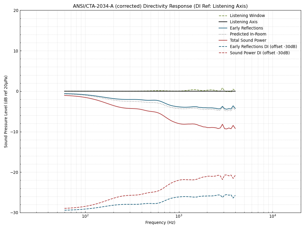

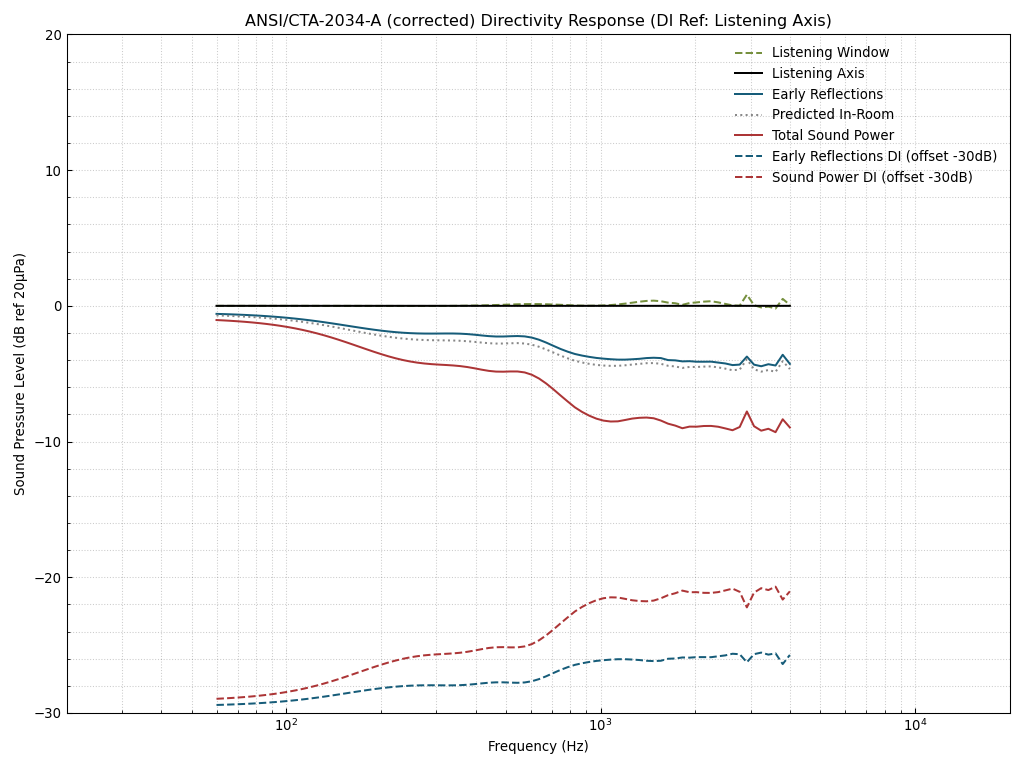

I've been playing with bempp_cl a bit over the last few days and found that the behavior you describe does appear to be related to the JIT compilation. I installed version 0.4.2 from PyPi usingI have started playing with bempp-cl which seems to the current version and it is not running efficiently for me.
pip
. So far, I've only used the Numba backend. The first call to any JIT-compiled routine is slow (compilation appears to be single-threaded); subsequent calls are much faster and utilize all available cores.I decided to try uniform sampling rather than the typical H/V orbits and found that the H/V orbits actually seem to underestimate the true effect on the sound power for this as well as in-phase (LR) crossovers. This is the waveguide-in-baffle version again, computed with bempp:How does it look along a diagonal? Maybe the equal H/V weighting in the calculations is giving the vertical response too much weight.
No NUC, unfortunately (I haven't figured out the requisite math yet). Now with the sound power computed from five thousand samples (a bit overkill, I know), approximately uniformly distributed[1] on a spherical surface:
[1]: Using the "golden spiral" method.

bmc0, your crossover is way too high frequency compared to size of the box, woofer and waveguide. If you wanna cross say at 1kHz, with smooth power and DI, you'd be better off with 8" or 10" woofer and waveguide. In general, for smooth transition use waveguide that is smaller or similar size as the woofer, roundover included, and box that is not much bigger than the woofer. Waveguide freestanding on top if you can. Crossover somewhere 1-1.4 c-c wavelength with LR filters. This makes sure woofer DI ramps up bit lower in frequency than waveguide DI, and enables smooth transition together with suitable xo frequency not to lose too much power off-axis in destructive interference. If you want to use very big waveguide use very big woofer, or multiple, and accordingly low crossover point.
If c-c is ~50cm, then use say ~50-70cm wavelength crosover, roughly 500-800Hz, for smooth transition.
I see your spins use waveguide as rotating = listening axis. With big c-c like this, you might want listening axis between waveguide and woofer instread, in order to keep distance to ear from each sound source relatively constant no matter listening distance. This has possibility to increase highs in the room as well, if thats good or bad thing, depending whats you DI on highs and room acoustics. This is something I haven't fully thought through yet though.
I disagree.bmc0, your crossover is way too high frequency compared to size of the box, woofer and waveguide.
The C-C spacing is 32cm and the crossover is LR6 acoustic at 1050Hz. Almost exactly one wavelength.Crossover somewhere 1-1.4 c-c wavelength with LR filters.
With an observation distance of 3 meters, it doesn't make much difference.I see your spins use waveguide as rotating = listening axis. With big c-c like this, you might want listening axis between waveguide and woofer instread
With the ~32cm c-c try ~32cm cubicle box, ~32cm diameter woofer and ~32cm freestanding waveguide, xo above 1kHz. You could very well use 26cm freestanding waveguide like good old st260 for example.

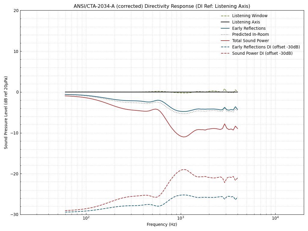

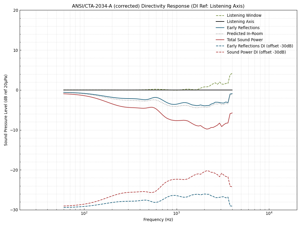

The main issue that @bmc0 was showing is the effect of a waveguide on the response of the woofer. If the woofer remains fixed, the scaling obviously doesn't work any longer. There will be some (probably not that difficult) dependancy on the waveguide size, but not just a simple shifting in frequency, I guess.
Yeah thats one anomaly simple scaling of data doesn't work for. But, simple scaling would show that shrinking waveguide size works actually quite fine. Smaller waveguide helps also with that particular issue being smaller having less effect on long wavelengths in the woofer response. Additionally a freestanding version with quite big c-c and one edge between woofer and waveguide reduces the effect bit more, minimal symmetric baffle helps as well. It's not gonna fix all things, just an example that gives smoother response, get's rid of the particular kind of wiggle bmc0 illustrated.
If I remove the direct sound from in-room measurements of my speakers (via windowing) and look at only the indirect sound, I do indeed see a small dip around the crossover point along with a plateau in the 300-600Hz range. It depends somewhat on the particular location, but averaging a number of points on a horizontal plane seems to show this shape reliably.I'm sure many are scratching their heads right now, me included.
Here's the woofer from the above sim; first with H/V orbits and then with uniform sampling:
And the tweeter:
I don't quite understand @tmuikku's assertion of the crossover frequency being too high or the waveguide being too big. Ignoring the woofer anomaly caused by the waveguide, the DI of the woofer and tweeter are very similar over a wide frequency range. A smaller waveguide may well have less effect on the woofer though.
