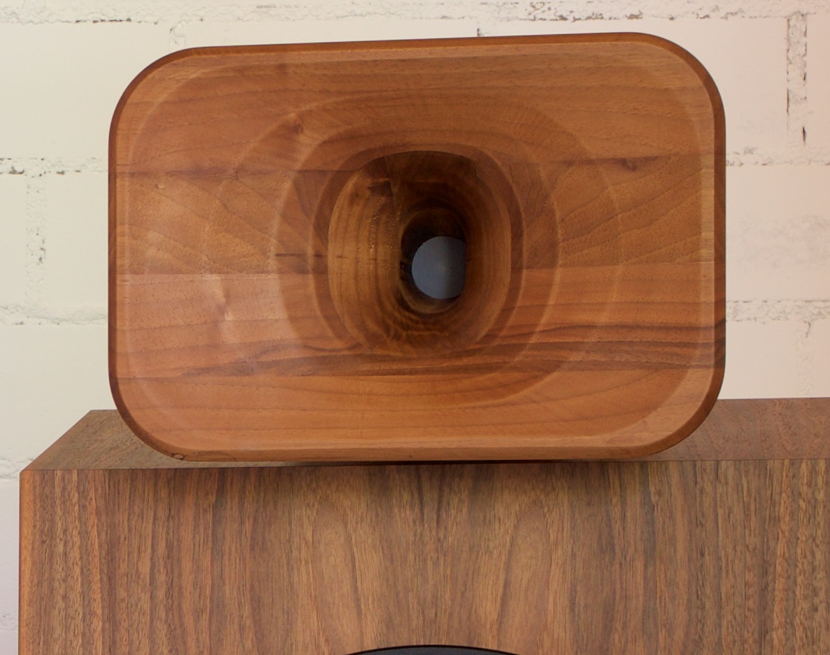

That's an interesting shape that in principle should be possible to create with Ath and test right away. I tried several times something similar but it never worked as good as the latest ones. Well, unless you are obsessive about loading 🙂 (And I guess they should be in PA).
The image comes from Roberto Magalotti (ex-B&C Speakers).
This concept is indeed interesting for a number of reasons:
- By using, for example, a traditional horn profile in the vertical plane, hornloading will increase.
- The asymmetry allows a smaller c-c distance.
- Due to the unequal opening in the horizontal versus vertical plane, pattern flip can be (almost) eliminated.
- This concept also allows smaller coverage angles, without the need for a much larger horn.
An OS opening (further from the throat) morphed into an exponential - or similar - vertical profile somewhat resembles a classic diffraction slot, but without the drawbacks.
In a French thread - where a large number of horns / waveguides were analyzed, this idea was also suggested.
It's still a compromise and true, it remains to be seen whether it actually "works".
However, there's at least one manufacturer that has been making horns in a similar fashion for years. He basically uses throat sections that are mounted to wooden mouths.
This brings forth another potential advantage; the possibility of using different (3D-printed) throat sections for a single, fixed mouth. This would require a mouth to throat (re)design approach, but it should be possible.

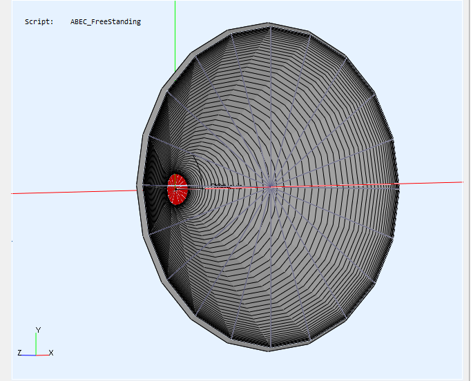

Greetings all,
thanks to fluid and Marcel, I was able to acquire ABEC and successfully execute both the circular symmetry demos.
I than started to work on a script describing my wave-guide made ante-Ath(TM). The wave-guide is pure OS, hence OS.k = 1 in the script. It does fare slightly at the mouth, hence the remaining terms in the WAVE-GUIDE DEFINITIONS section.
Once the ath.exe command completes, the dimensions are very close to the physical wave-guide. Unfortunately, when I execute the script, the ABCE Drawing tab displays a wave-guide with a "spider-web" across its mouth. Please, see the picture.
Despite cross-referencing the script against both demo1C.cfg and demo8C.cfg, I cannot find the problem. Thus, I was wondering if someone could review my (heavily commented) script and point me to the right direction.
Kindest regards,
M
  • PDK_1.cfg.txt
    PDK_1.cfg.txt
You have a typo (missing 's') at this line:
Mesh.SubdomainSlices =
Unfortunately Ath doesn't let you know about that - it doesn't do any syntax checking yet. So what you see is the default subdomain interface, as if this line was not there. It shouldn't matter in theory but especially in the CircSym mode ABEC seems to give better results without it.
BTW, if you don't need the STL file (which is really not very useful here), you can switch if off (Output.STL = 0) and speed up the execution.
