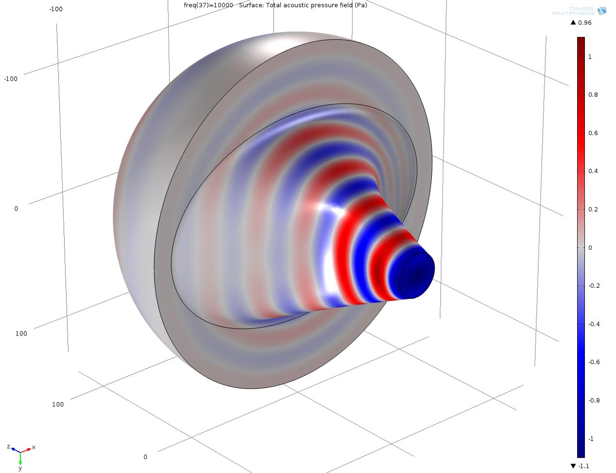

I was thinking about something along these lines.
I know I am a bit off topic here - but I cannot visually connect oblate and prolate spheroid to a waveguide shape - or are we talking about the wavefront shape? I still wonder how one would make a meaningful waveguide for the rectangular Heil AMT-1. And even when I think of prolate as the waterfront shape, I cannot get my head over how to start a waveguide with a rectangle - if it should stay rectangular all the time, or?
In prolate coordinates the origin is a line, in OS it is a circle. The PS waveguide would not start at zero as the OS does, it would start some ways out on the spheroid - like a conical does. The wavefront would remain rectangular to the mouth. A flat wavefront is not a perfect match so this too will always have HOMs at some point, as do all waveguides I suppose.
I can't quite tell - explain what's going on.
Is the mouth elliptical and the throat round? If so and every arc from throat to mouth is OS then yes that is the idea.
