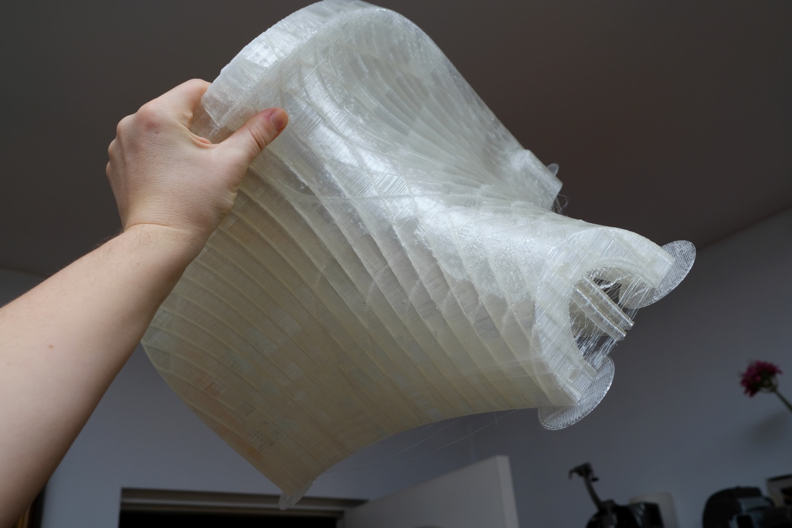

Iwata 300 print TPU65D - low resonance low decay, low weight, 16mm wall.

Try TPU - it's very dead.
