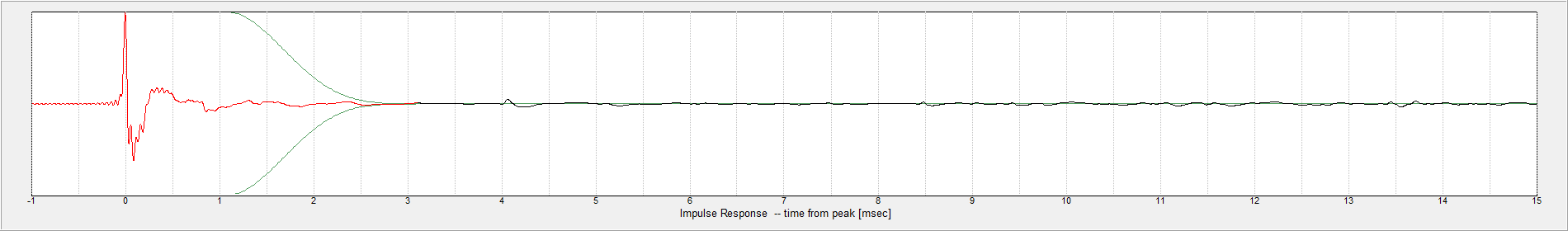

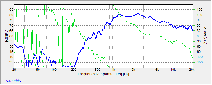

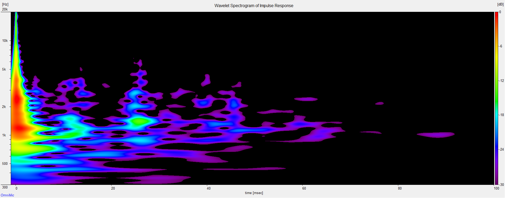

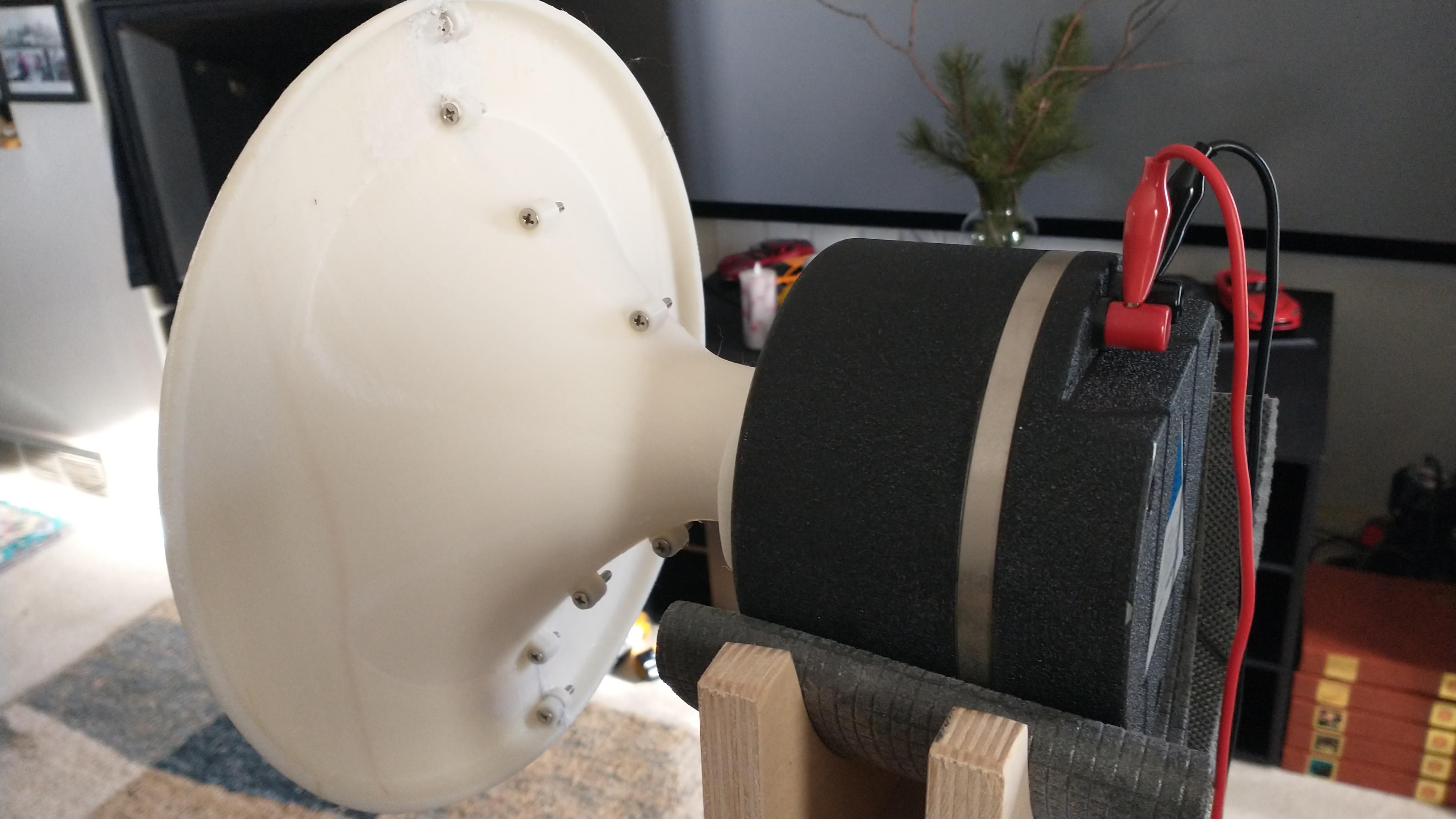

I just bought an Omnimic and Dats. So I used Dats to directly drive the TAD using a short sine sweep. Here's what I have...
Disclaimer: I just got these tools and don't really know yet how to fully use it.
I welcome any input and request what I should be measuring.
No smoothing. How does it look?

This is illustrative for the quality of the TAD and the horn.
Looks good already. There's only a shallow dip around 1500 Hz.
This is with a highpass around 1000 Hz?
Wow really, I thought it was just ok. The throat could use more sanding , a bit rough. Would it make a difference?
The track has less than 300hz removed. I was careful ramping up the volume.but the DATS only have less than 5 watts I think.
There's room for improvement/optimisation such as flattening the response, but I suspect this is already listenable.
So there's no highpass? Be careful not to blow your diaphragm.
There appears to be no loading below 1000Hz, which was to be expected.
If there are irregularities larger than say 0.8mm in the throat, then sanding certainly makes sense.

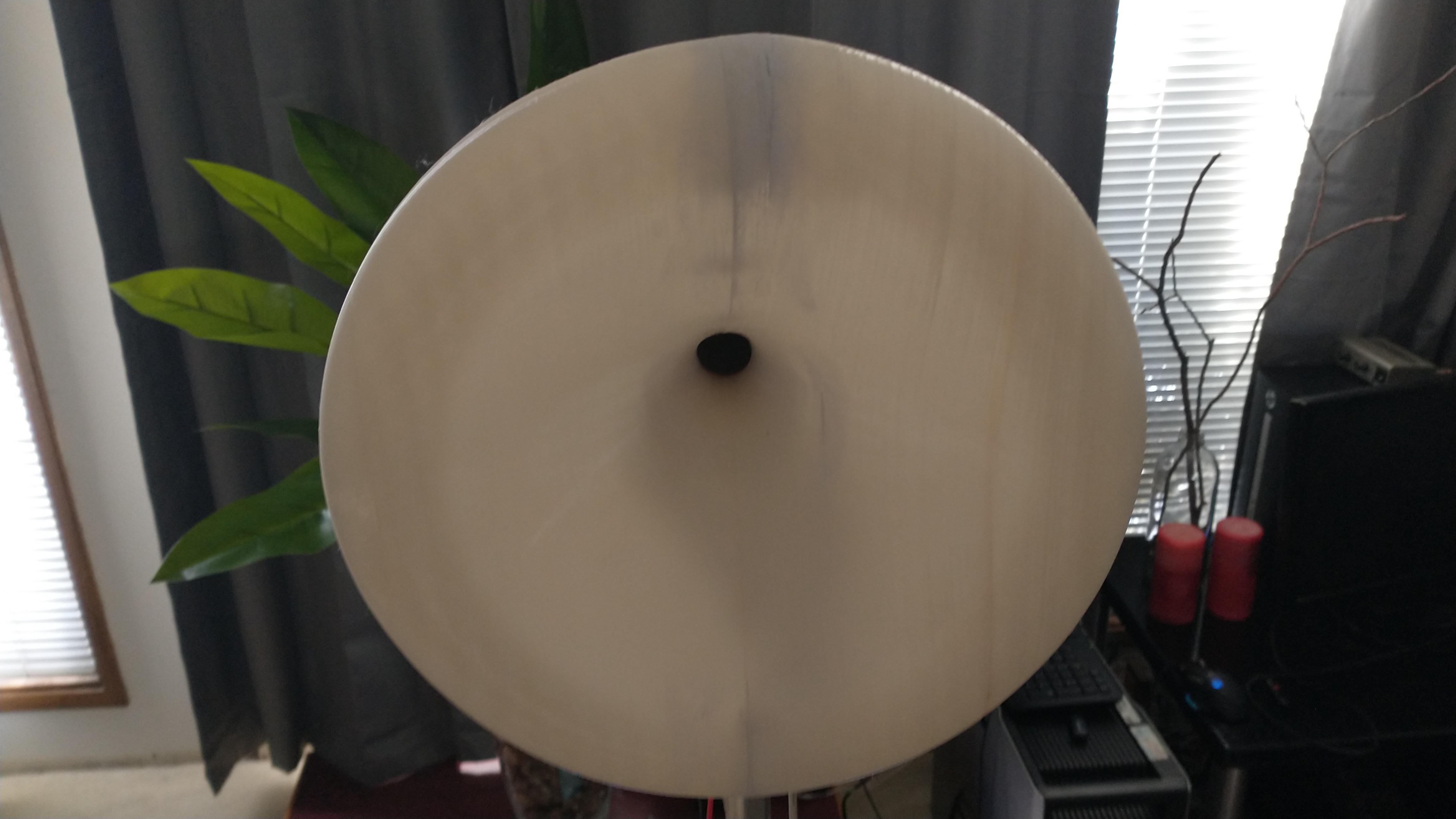

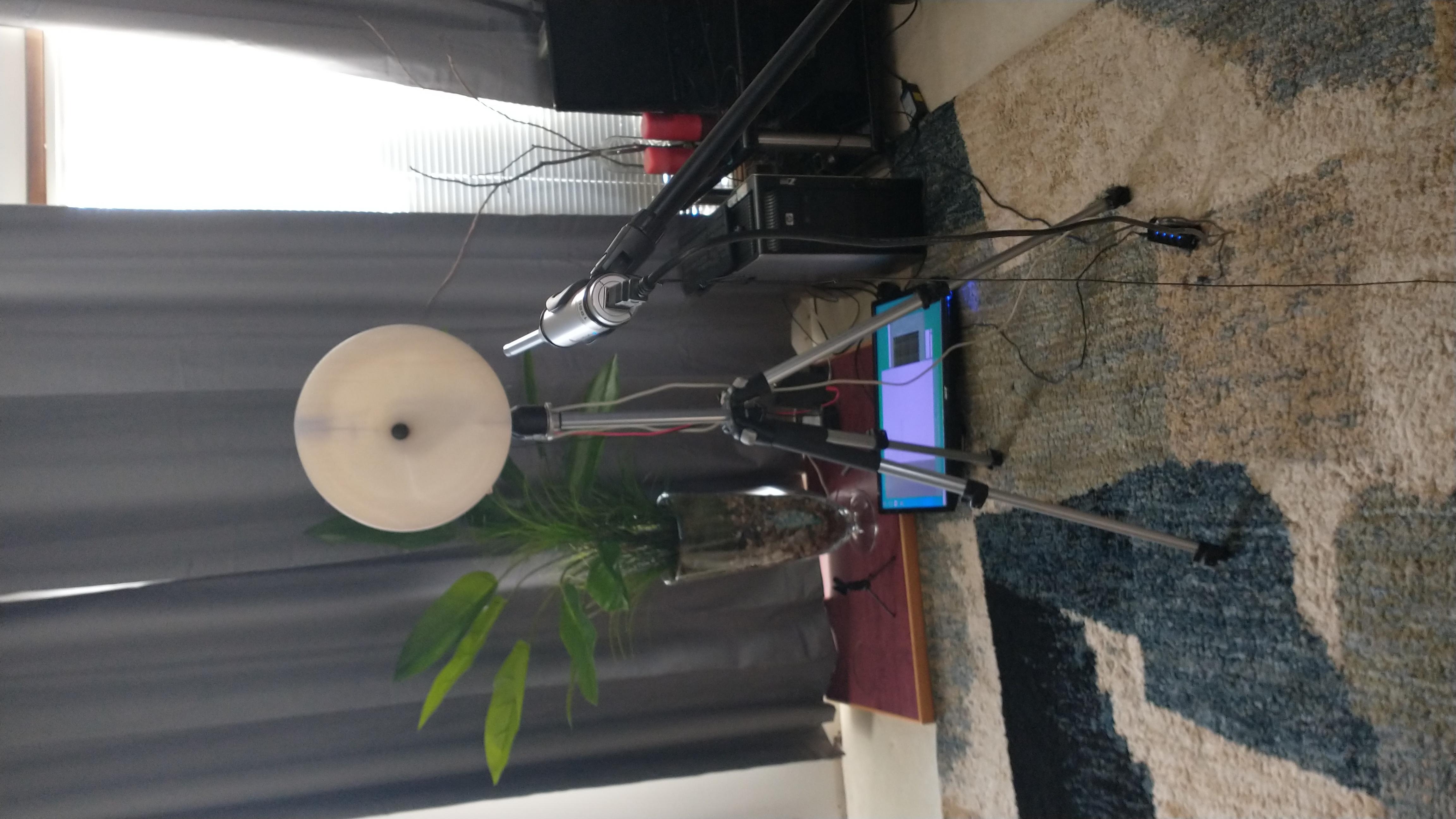

Looks good. How about going closer? It will mean that you capture less of the room and more of the driver/horn apparatus. Mic head 15 cm out from the mouth?

Yes no highpass for testing. I'll be careful with what I play on it.
I just run my fingers on the transition between the driver and the horn throat. i feel the horn diameter is a bit smaller and sticks out by more than 1mm . I'll shave it down, sand and report back...
It is set at 10cm from the throat. I have to figure out how the do polars. I bought a 12" lazy susan bearing already.Looks good. How about going closer? It will mean that you capture less of the room and more of the driver/horn apparatus. Mic head 15 cm out from the mouth?
Aha - sorry - it looked a lot longer on the picture.
C'mon, I'm sure you can look past those imperfections.
JSS' first attempt looks a lot better than this "finished" product including the TD-2001.
Yeah that is crazy FR for a finished product. I guess I should be happy with my first try.

I'll make some jig for polars and see how it looks.
When measuring, should I make the center of rotation at the horn mouth or throat? Increment by 10degrees enough?

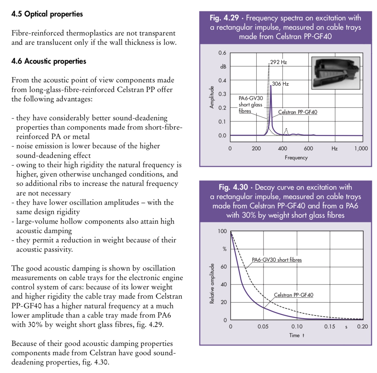

Iwata 300 print TPU65D - low resonance low decay, low weight, 16mm wall.

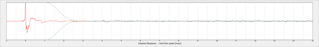

Don't go so close with the mic (but maybe I misuderstood). You can find the sufficient distance where the polars won't change further but you will definitely need to learn and use properly the time gating of the impulse response to exclude room reflections (should be documented in Dats - I've never used this SW myself so I can't hep). For the waveguide+driver combo alone the time window typically doesn't have to be longer than a few miliseconds, which should be obtainable in a room without problems - always go as far as possible with the mic (around 1 m should already be fine here, maybe even a bit less).
On one of your pictures there seems a time window applied but it's definitely not in the end so this is somewhat confusing. The critical thing is to not truncate the impulse at its beginning - always make sure this isn't the case.
Really looking forward to see more measurements. I'd use the throat as the center of rotation, at least this is used in the simulations (unless you change it). 10 deg step is fine.

Sorry, now I see it is OmniMic, not DATS. It's called 'windowing' in the manual....should be documented in Dats - I've never used this SW myself so I can't hep
