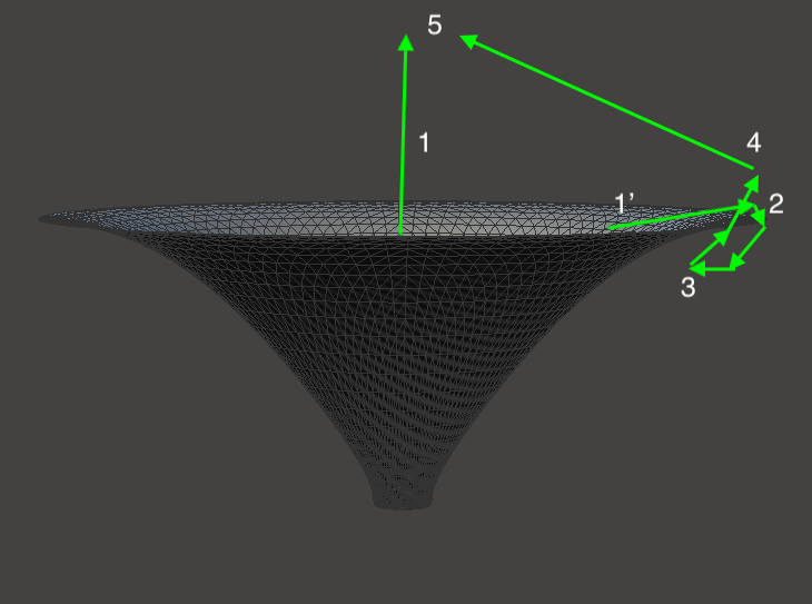

This has nothing to do with a room - this all happens in free field (with only the waveguide present) and it is clearly visible in all the simulated data.
Simply, after the sound radiated at the throat diffracts around the mouth edge, it can and will return back again, no matter there's no wall behind...and we want to minimize this.

I do the 180 deg (i.e. full sphere) analysis all the time, but no, I don't want to know how the waves behave behind the waveguide. I want to know how strongly they pass around the mouth edge again towards the listener. They really do pass, that's diffraction.If you whant to understand how a naturally excited wave behave behind the WG, depending on roll-back-length, just extend the hor/vert analysis to 180 deg? Then you will see whats going on "behind" the WG - no?

Could you please describe the course of events?
If what you say is true, then the simulations you do is not "correct" - the FRs for 0deg/0deg you show lack something! This diffraction contribution?
So its a diffraction on the curved edge of the rollback (say h45) that when it "diffracts", radiates in all directions including the 0deg/0deg and thus, contributes to the on axis FR?
You just can't prevent the sound from diffracting and reflecting and this happens all around the waveguide. At the rear, whatever is directed towards the mouth edge, it will diffract again, this time towards the listener (and perhaps inside the waveguide). These are small effects but we have already so good waveguides that we can see even these small changes.

Well maybe this explanation is completely wrong, that's also perfectly possible - it's only my best effort to understand what's going on.
Please, take the side profile of your big sand horn and with straight lines with arrows, draw the path of the event you envision. I'd really like to understand this and such a picture would help me.
