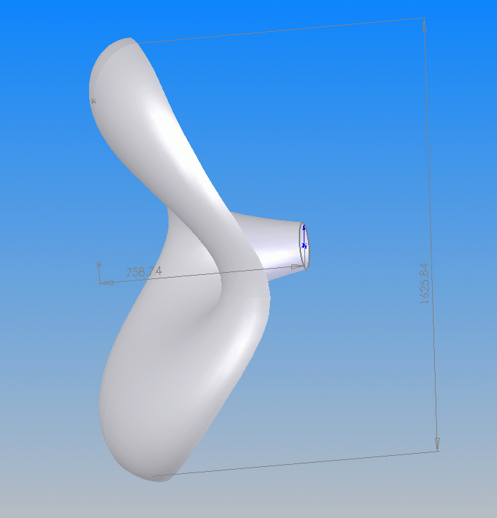

I don't know, perhaps. You can define almost anything as an independent function of the angle around the axis, I guess it should not be a problem but I of course don't know anything about this particular shape.Marcel, can ATH generate below shape?

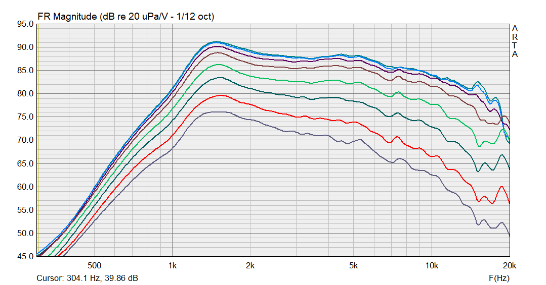

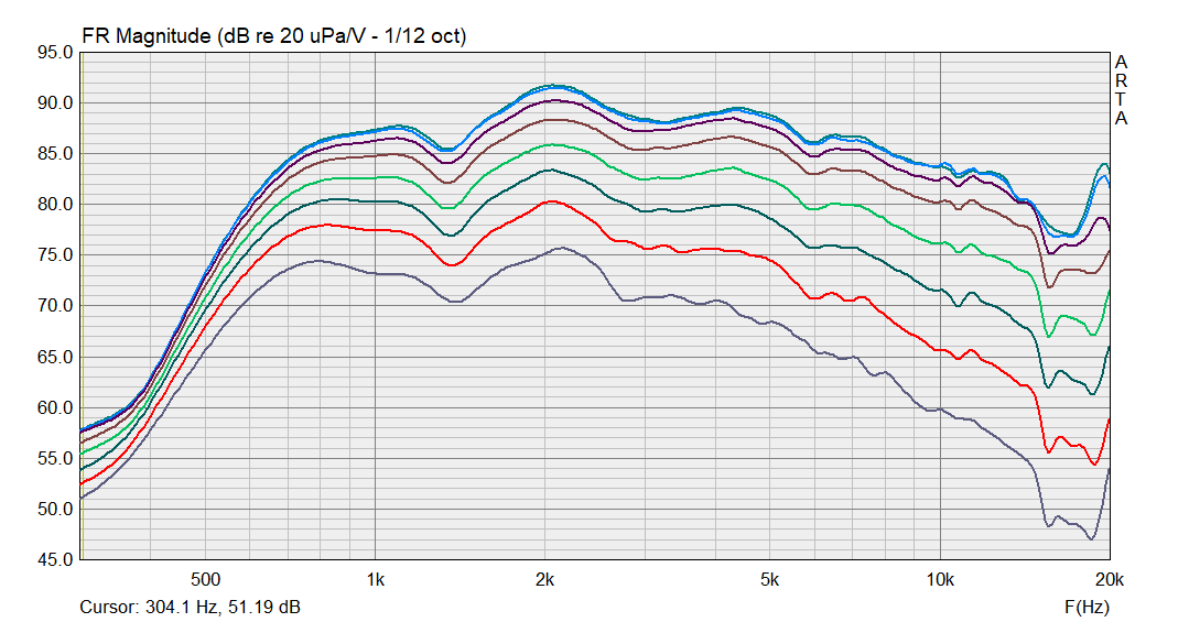

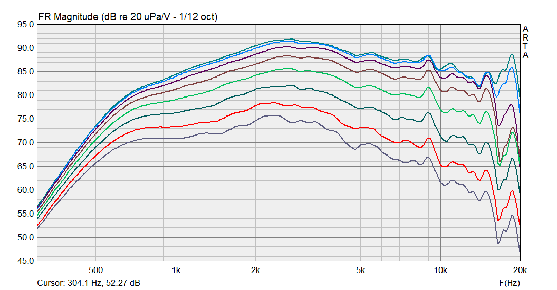

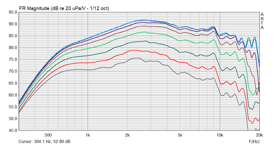

... HF108, the second piece (not exactly the same angles as for the first one- like I said, quick and dirty for now).
Time window ~ 4 msec, raw response, no filters.

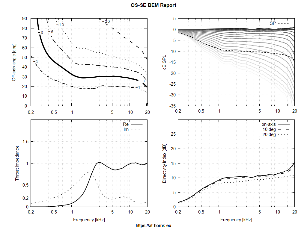

And the simulation inc non normalised FR looked like... sorry, the thread is so wast and hard to search...
