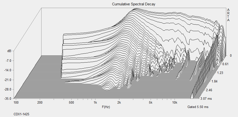

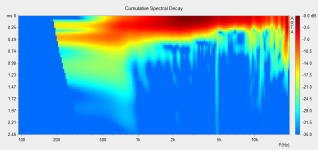

Measured with Celestion CDX1-1425 (~4ms window, raw response, no filters):
Those 1" Celestions are extremely well behaved, but clearly not suitable for use below 1000 Hz.

So far I'm not sure how to deal with something as damping of the waveguide - how to even assess the level of performance. When it's good enough?
No need for undue concern about the ringing / resonances of the waveguide.
You could stick some bitumen mats on the back. That's ugly as hell, but it works.
Yeah, that may be the way to inspect it -Good question!
Waterfall?
So who knows?
I tried the CDX1-1425 but the high-pass response itself drowns this out. Because of this a whole full range loudspeaker should be measured. Anyway, it tells a bit, at least what is due to the drivers.

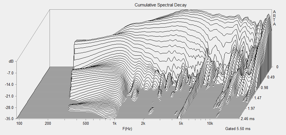

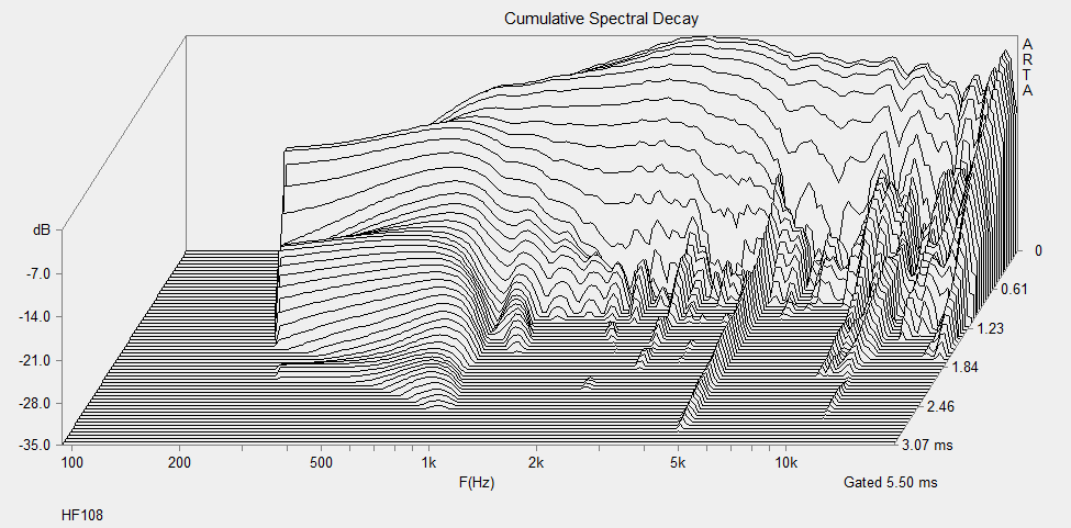

Faital HF108 (again):

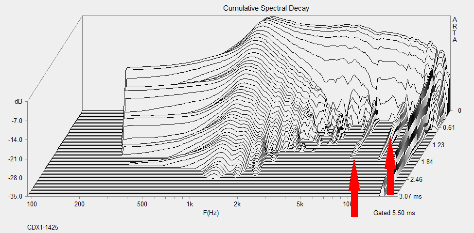

CDX1-1425:
CDX1-1425:
I know the spectra of the "ringing" when tapped intentionally, that's not a problem to see on RTA. What I don't know is to what degree are these modes excited during playback, i.e. to what degree this is a real problem for the resulting sound quality (it definitely doesn't sound like resonating when played a sound).
Maybe a way around this would be to damp the waveguide somehow and try to find the differences, I don't know.

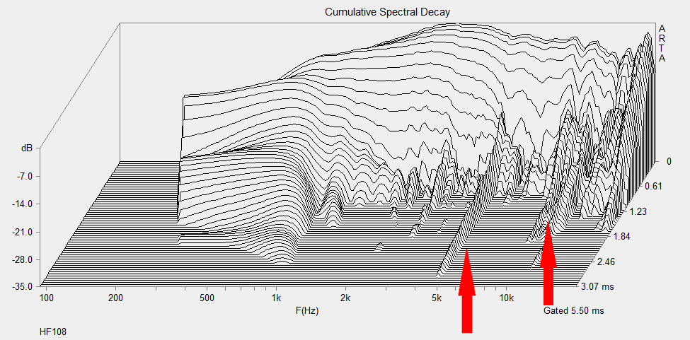

I don't see how you guys are concluding that the waveguide doesn't ring. I see two dominate resonances at about the same frequencies (the two drivers have different weights) which certainly could be waveguide resonances and both do affect the direct response. Both show dips and then ringing - a clear sign of energy being drawn off to the resonance and then dissipated through radiation.
As to the audibility, well, that's another question without answers. But my approach has always been to try and reduce all sources of aberration - a fairly safe bet.

I believe it doesn't ring
At least the half of the waveguide closer to the driver is virtually dead. It's only the rim where the wall is the thinnest (~12 mm) where it does respond to tapping. It would probably wouldn't be so difficult to damp it completely.

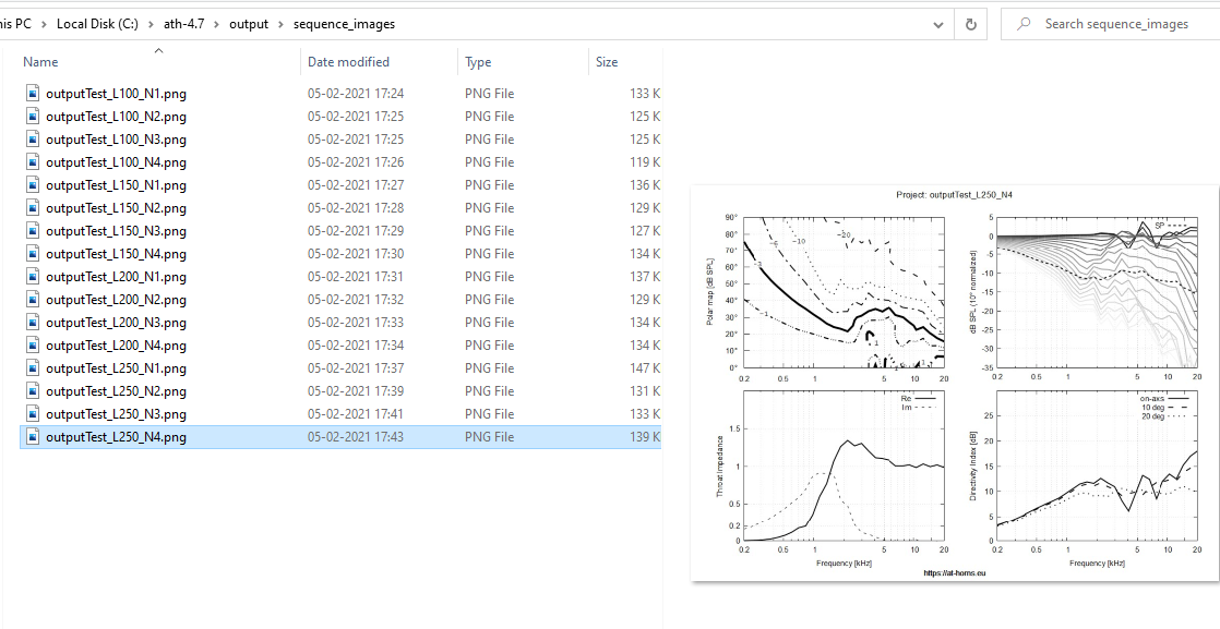

Great!I have been working on a little python script to step through a number of simulations. ...

I am sure that it would, my point is just that I see resonances where other do not.
Yes, I spotted those two resonances as well, but those are still small and could probably be reduced or eliminated by placing a felt damping ring between the mounting plate and the driver.
You may also try to wrap a thick towel around the horn, covering the thin walled rim.
