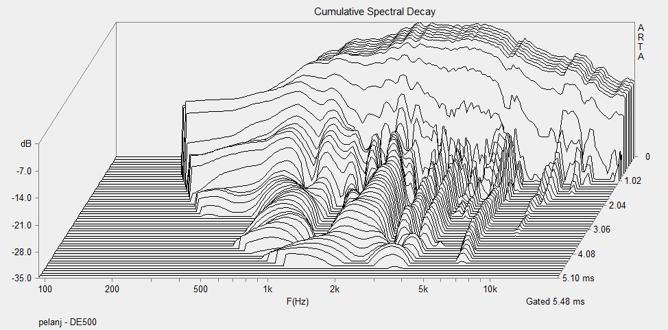

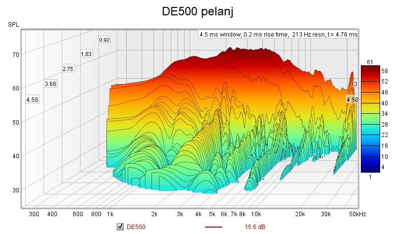

This is what it looks like in CSD mode in REW, I had to have the window be 10ms to see much at all, it is super clean

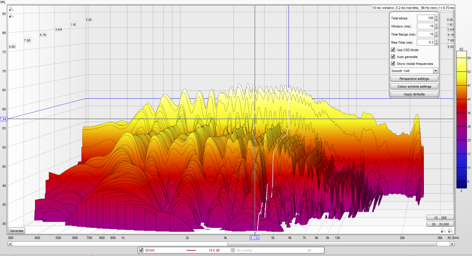

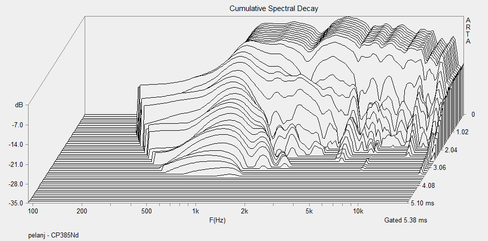

Here is an REW graph set closer to ARTA's presentation, waterfalls are the easiest graphs to manipulate to change the response but the hardest to interpret due to the time frequency resolution trade off. As seen by the two REW graphs of the same IR with different settings.

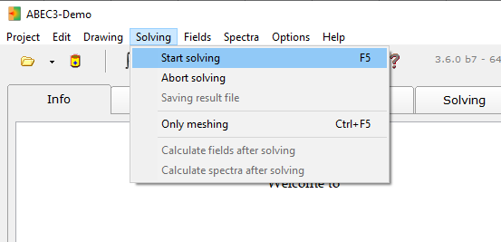

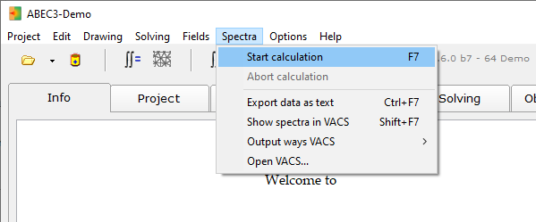

I have attached the code in a .zip file. There are three files; the main sequencer, a functions file and data container file.
If you look at this code form the sequencer there are two arrays called modLength and modN where the values are put into. Two nested for-loops run through the code. The code is not very dynamic as it is. If you want to run through more/other variables, another layer of for-loop must be added.
Code:
snippet from main file...
athRoot = "C:\\ath-4.7"                         #Define root path where ath.exe is located
varWorker = athABEC_simParameters.varOutput()           #Create class for variables
strWorker = athABEC_simParameters.stringOutput()        #Create class for strings
[B]modLength[/B] = ['100','200']
[B]modN[/B] = ['1','2']
start = time.time()
for i in [B]modLength[/B]:
    for j in [B]modN[/B]:
        loopFid = 'C:\\ath-4.7\input\outputTest_L' + i + '_N' + j + '.cfg'         #Define output file
        varWorker.[B]Length[/B] = [i]                                          #Set new parameter
        varWorker.[B]Term_n[/B] = [j]
        functions.generateScriptContent(loopFid,varWorker,strWorker)    #Generate content for file for ABEC
        functions.executeABEC(loopFid,athRoot)                          #Execute generated file with ABEC through ath.exe
In order to interface with ABEC I use a library that can execute keyboard commands on programs in the foreground, so when the code is running just step back from the computer 😀 otherwise it might cause unexpected behaviour.
Code:
code snippet from the functions file ...
    time.sleep(5)
    keyboard.press(Key.f5)
    time.sleep(0.1)
    keyboard.release(Key.f5)
    time.sleep(1)
Luckily the keyboard presses are quite benign just a little F5 & F7 and so on.

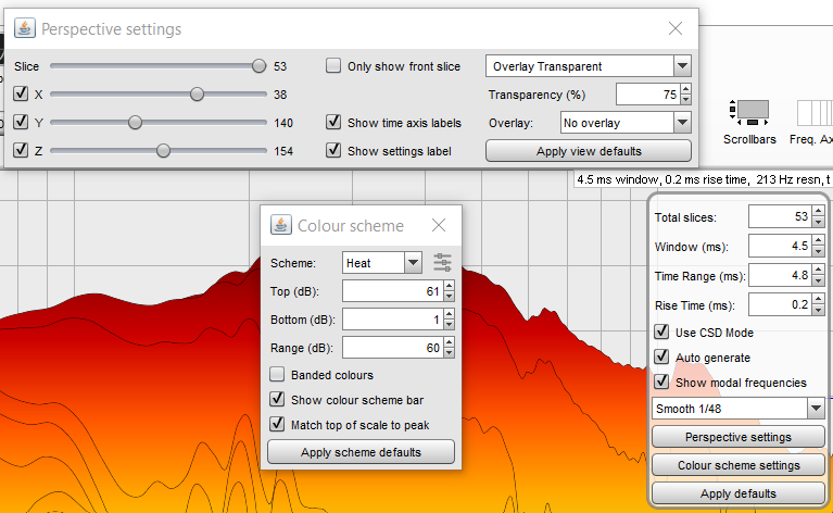

Fluid, could you please post a screenshot of the REW waterfall settings for Arta-like results !
These are what I used, they could probably be tweaked but this will get you close

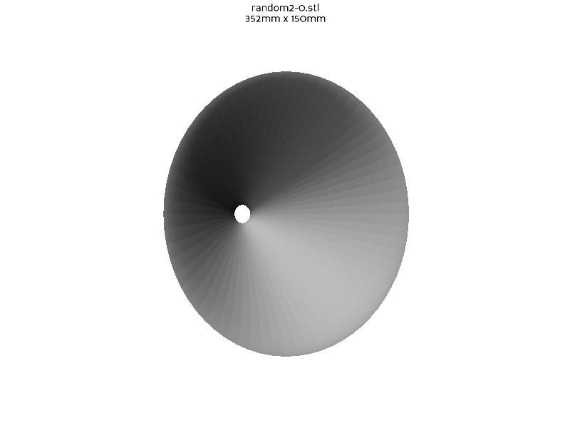

Here is another Python script that makes the .stl models into .png images. Use with the gif_maker from the previous message to visualize waveguide generations easily. Uses Panda3D library to render the model and then takes a screenshot so only for the nerds 😀
