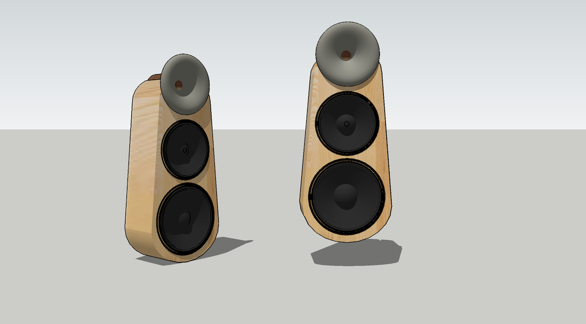

Having used them often, I am not a big fan of Passive Radiators, or ports for that matter.
I have several PRs in unopened boxes if anyone needs them. 15" I believe.
the ports makes sense from the horrid resonances they get, but what is the problem with PR's? I thought they where considered generally superior?
obviously its not needed if you're doing a multisub setup. but it can be nice to just have 2 speakers which are full range.
is there a big downside to having a PR setup like this, even if you may have subs? (apart from cost)

Since, to me, any really great audio system has to have multiple subs, I don't see the need for full range mains (although mine do go down to about 50-60 Hz.) Hence, in that sense no ports or PRs are needed. PRs do have some advantages over ports, but I still contend that a closed box works best with multiple subs and EQ availability. Closed box offers better excursion control than ported.I think this would be an amazing asset. would it allow us to better estimate power response and estimated in room response?
I would be willing to help an effort. only have c/c++ and python skills though. I'm guessing you used a language more suited to academic math work?
