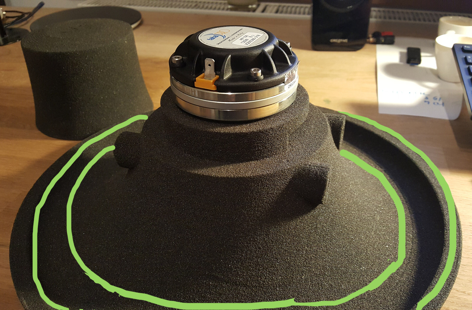

Perhaps a damping solution would be to fill the “trough” (see image) with a self-leveling polyurethane used for filling cracks in cement
Just occurred to me that for the sake of experimentation, a product like duct seal could be used to fill the trough (see image). Duct seal remains pliable and will not adhere itself permanently and is easy to remove.

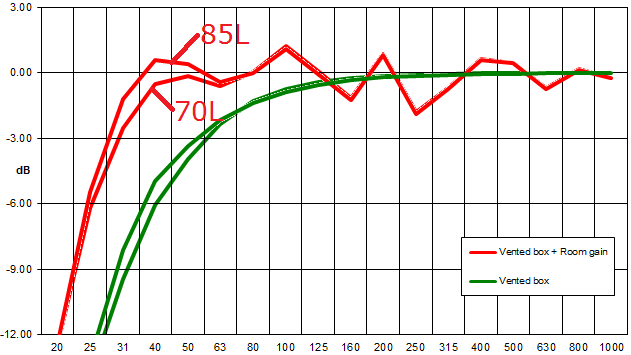

Regarding bigger loudspeaker systems with pro woofers, it was rightly stated on another forum that -3dB around 50 Hz + room gain is a realistic target for a nice bass reproduction to approx. 30 Hz in many living rooms. Troels Gravesen suggested something similar and has posted a plot to illustrate this.
It's nothing more than the LF extension / sensitivity / enclosure volume trade-off. You can always have only two of those at the same time, no matter what woofers you use.These kind of tower speakers usually require lots of amplifier current in order to get the lossy woofers moving.
There's probably some "sweet-spot" but I doubt it is anywhere above 90 dB/2.83V@m in the final sensitivity, unless you could tolerate huge enclosures.
