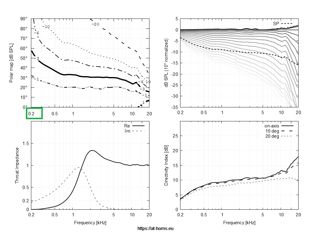

You can change that manually in the file lib\scripts\report2.gpl.@Marcel
In my sim parameters I changed the lower limit to twenty Hz, but the graph only goes down to default 200, can I change that?
By the way how does this look for a HF1440 large format horn?
Change these lines -
set xtics add ("0.2" 0.2, "0.5" 0.5, "5" 5, "" 15, "20" 20)
set logscale x
set format y "%.0f°"
set xrange [0.2:20]
to something like this:
set xtics add ("0.1" 0.1, "0.2" 0.2, "0.5" 0.5, "5" 5, "" 15, "20" 20)
set logscale x
set xrange [0.02:20]
