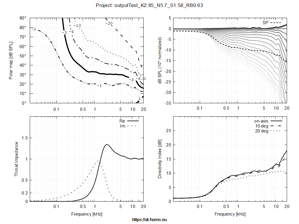

You can change that manually in the file lib\scripts\report2.gpl.
Change these lines -
set xtics add ("0.2" 0.2, "0.5" 0.5, "5" 5, "" 15, "20" 20)
set logscale x
set format y "%.0f°"
set xrange [0.2:20]
to something like this:
set xtics add ("0.1" 0.1, "0.2" 0.2, "0.5" 0.5, "5" 5, "" 15, "20" 20)
set logscale x
set xrange [0.02:20]

Twellmann may I ask what is the size of your waveguide?
Diameter around 640mm
Depth close to 200mm
Wowza, considerably smaller than I thought. Any chance to show annimage of the modeled device? 🙂

You can have the .stl
O640x200.stl - Google Drive
I expected a little smaller 🙂Wowza, considerably smaller than I thought.
That is about the same size (ignoring the symmetry) as the largest available waveguide with similarish design principles, the SEOS-24. Is there a way to model the SEOS waveguides in Ath4 to see how much of a leap this new generation of waveguides is?
