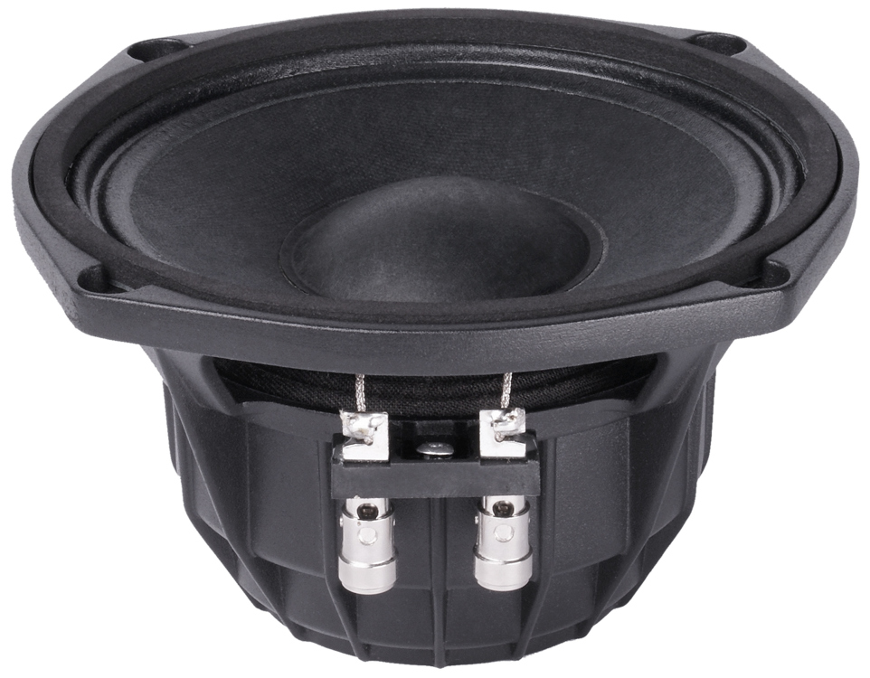

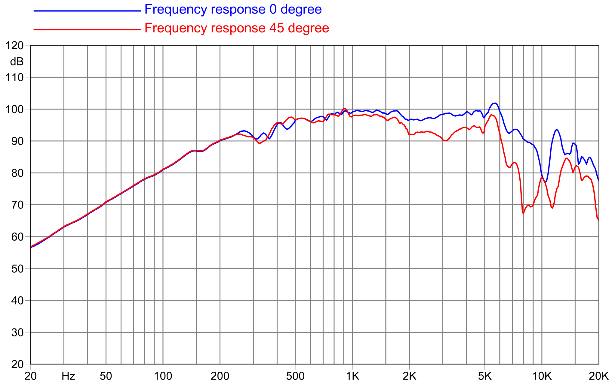

This is a concept that might work.

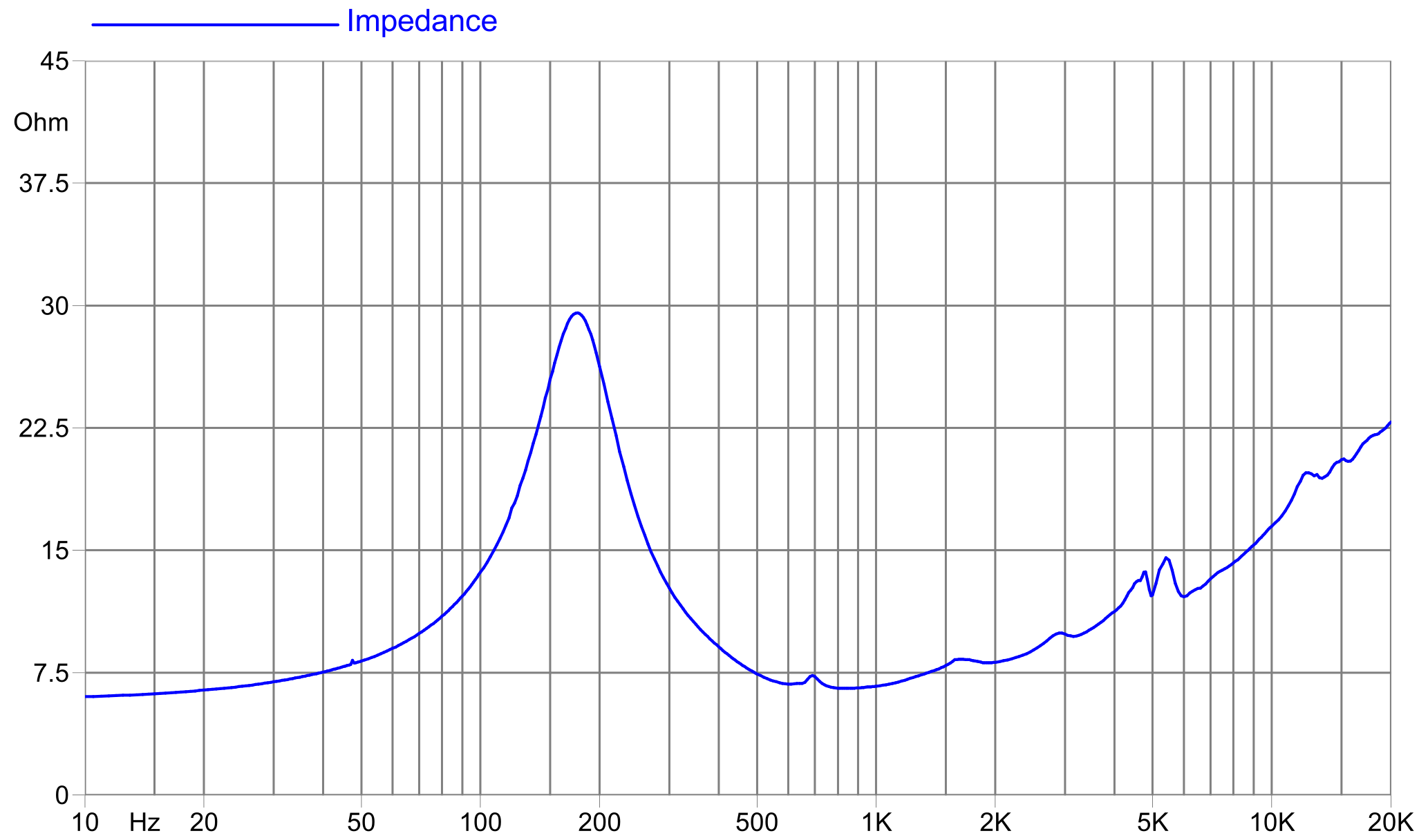

I would take a slightly bigger, efficient mid, with Fs < 200Hz, to keep up with the comp. driver.
Something like this (impedance could be cleaner though):
In a passive speaker you are typically limited by the sensitivity of the woofer. Reaching around 90 dB/2.83V@m in overall sensitivity of the speaker would be a very good result. So there is really no need for such efficient midrange. It does no harm either but there's no "keeping up" with the CD.
