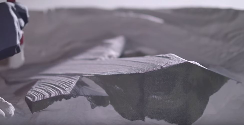

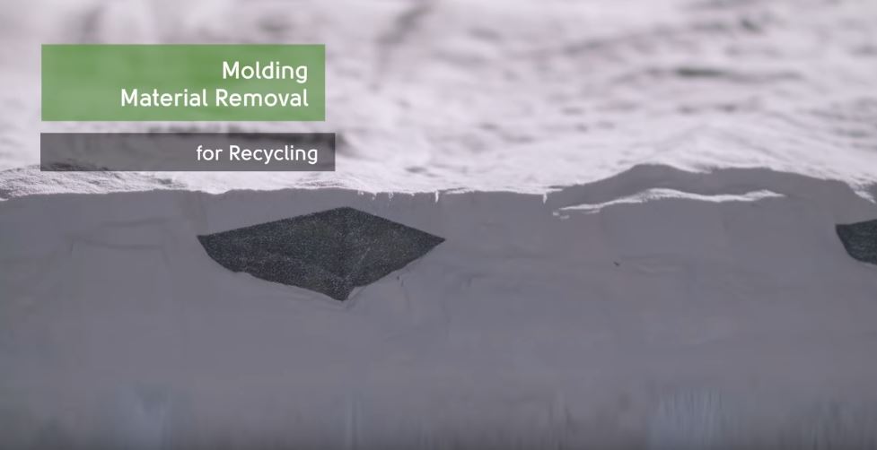

Probably one of the reasons/advantages (no additional supports needed). See the video, it's fascinating. The print speed and size available is just amazing.
