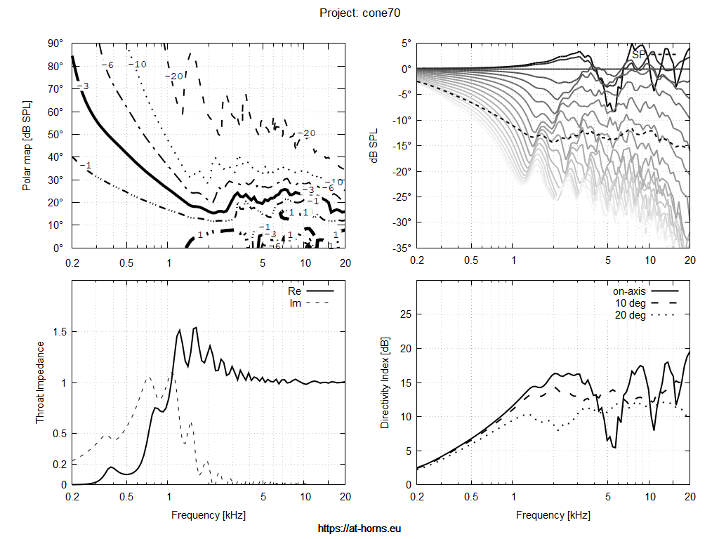

As HOMs are reflections they come later - how is time aspect represented in the presented simulations - cant recall I have seen this!?
All the simulations are complex (amplitude and phase) so all the information is there but so far I haven't tried to extract anything in time domain. That could be the next steps, I don't know. The information is definitely there to explore.
OK - its probably very interesting. A reflection need to "pin-ball-machine" itself on the way to the mouth whereas a direct travelling wave will go the fasted way out 🙂 The late comers are "nasty".... ;-)
I'm not sure I would agree on that. Maybe it doesn't make much difference if there's a lot of other diffraction going on but in my experience the bigger size doesn't make the termination less important. I would say that the better the waveguide from throat to mouth the better must be the termination to maintain that quality.
I should have qualified that "the termination doesn't really matter for the compression driver."
IE, the SH-50 is 71cm wide, that's 479Hz.
If it was 20cm wide, the abrupt termination would be an issue, because 20cm is 1700Hz.
With a crossover point of 1500Hz, and a baffle width of 20cm, the wavefront will expand in an uncontrolled manner as it exits the waveguide, because the baffle is narrow.
This is similar in concept that you don't really need a roundover on an infinite baffle. (It probably wouldn't hurt.)
The main thing here is twofold:
1) I'm not too worried about diffraction at 500Hz, the research indicates diffraction is a bigger issue at high frequency.
2) The SH50 is 71cm wide
Yea, we could examine an impulse response, waterfall or some wavelet analysis, "spectrogram", whatever. All that's needed is to get the impulse response from the complex pressure data. That should be definitely possible but I haven't tried yet.OK - its probably very interesting. A reflection need to "pin-ball-machine" itself on the way to the mouth whereas a direct travelling wave will go the fasted way out 🙂 The late comers are "nasty".... ;-)
Well, this is 74 cm wide -...
Ouch!

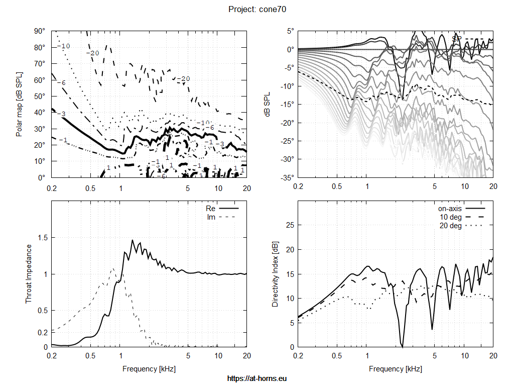

Here are my Cosynes
Here's the difference in off-axis response, with and without a 5.7cm roundover
Here's the polar response with no smoothing and no roundover
To this day, it's a bit of a mystery to me why the waveguide seems to be doing nearly nothing between 5khz and 15khz.

Here are my Cosynes
If you take an inverse FFT on the FR you should see a tail on the impulse due to HOMs (at least this is what I saw in the past.) If you compare that impulse with the impulse from a pure spherical source you should see the effects of the HOMs (assuming, of course, that there are no other resonances since these will also have tails.)

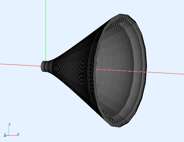

General waveguide shape like that is in the pipeline, including the secondary flare and smooth throat transition segment (from circular throat to the flat panels). I already started but then realized it's not that simple, especially if you want a smooth transition where the flat panels start. But I figured out how to do it so now it's just a matter of my spare time to actually implement it (and me feeling like doing it).Patrick Bateman, I'm trying to push mabats buttons so that he would possibly maybe post some simulations of DIY MEH style horns like the cosyne (made out of plywood panels, maybe try to find a better mouth termination) or give some tips how we others could simulate them. ...
Yeah! Sorry about pushing it but I felt I had to do it so, now its almost done!😀 What exciting times 🙂
Do you really mean to simulate a free-field spherical source and compare with that? Hmm, I wouldn't think of that. How is that different from comparing to a perfect impulse?If you take an inverse FFT on the FR you should see a tail on the impulse due to HOMs (at least this is what I saw in the past.) If you compare that impulse with the impulse from a pure spherical source you should see the effects of the HOMs (assuming, of course, that there are no other resonances since these will also have tails.)
I wonder if it was possible to implement rectangular throat for ribbon type drivers (yes, my AMT-1 for example🙂).
The reason for the impulse of the pure sphere is to determine any phase characteristics of the calculations. Finite spatial resolution results in dispersion (in the real meaning of the word) towards the higher end of the spacing. This could affect the calculated impulse response especially at the HFs. Do a half sphere in an infinite baffle, that is the ideal.
But I suppose the real test comparison would be to a vibrating cap in a sphere, where the cap and mouth are the same size. The problem becomes what size cap to use if the flare is large. You want to extract things that are caused by the waveguide itself and not the unavoidable acoustics and calculation errors.
The HOMs are likely to be small and concentrated in a narrow bandwidth, so resolution would be imperative.
