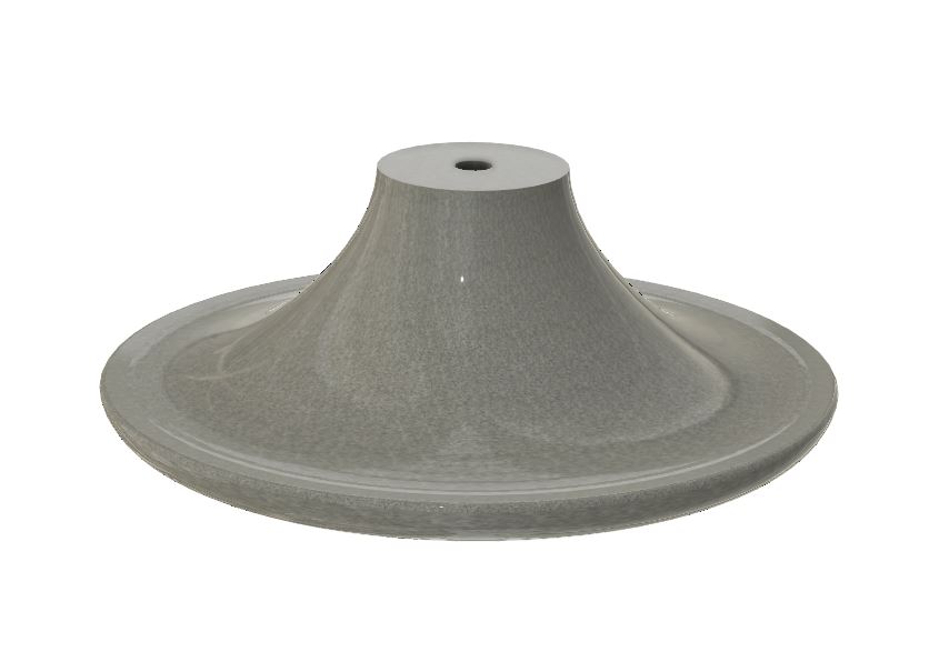

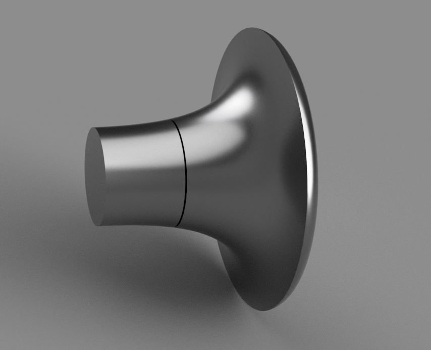

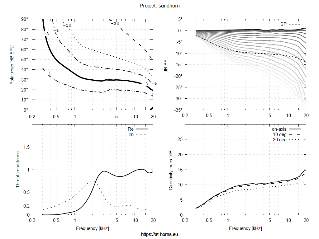

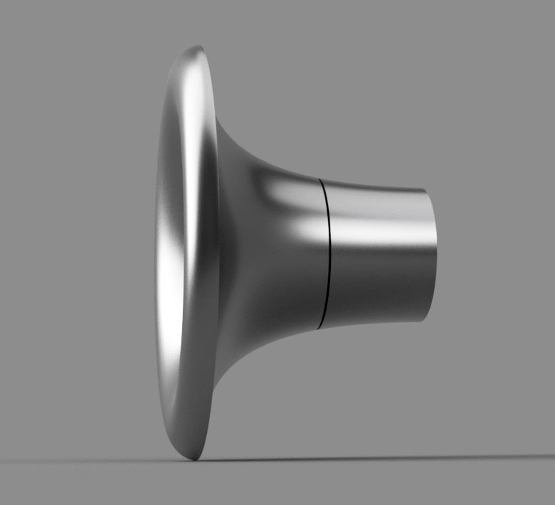

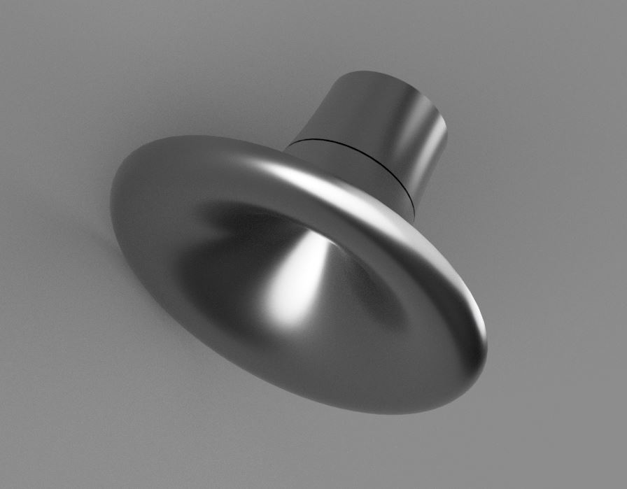

Preparing the first sand-printed one (13"), suitable for a 12" woofer -
(BTW, this was made on the same machine: DEEPTIME | LIFESTYLE AUDIOPHILE SPEAKERS)
(Simulated including a 30° conical exit of a compression driver, e.g. Faital HF108).

Why keeping the size of woofer and WG the same? A woofer at XO radiates form the dustcap/coil former mostly - no?
What XO freq and order planned for this one?
Kind of, yeah. I want mainly to test the sand printing with this one.Cool! Very interesting to follow as now you do your own first realisation!?
I expect the crossover around 1 kHz, hopefully somewhat lower - that of course depends also on a particular woofer as not all are the same but it will be around 1 kHz. I think that at that frequency it's still the whole diaphragm that contributes significantly - that's still below break-up and that's why we can use the woofer this high in the first place. You simply want the directivities to match.

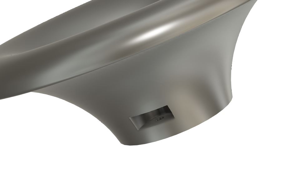

Now I have to devise some mounting.
Woofer starts to narrow it's radiation pattern on a frequency depending on the size. Same goes with the waveguide, it "loses" the pattern control on a frequency depending on it's size. Now when they are both roughly the same size both undergo transition from wide radiation to narrower radiation roughly at the same bandwidth. This is a good spot for crossover, both have similar radiation pattern over a bandwidth and there the combined power and directivity stays as smooth as possible over the crossover region without sudden changes which would happen if you crossed too high of a frequency with smaller waveguide where the waveguide has already lost the control and has much broader radiation pattern than the now beaming bigger woofer. One could cross at lower frequency though, where both the waveguide and woofer have a wide radiation but this is unnecessary stress for the tweeter/compression driver to have lower than necessary crossover.
A big waveguide and a big woofer is to get the crossover point as low as reasonable for the application. a 15" woofer and waveguide would get the crossover under 1kHz, below the most sensitive region of the hearing system.
I was very happy with using a mounting plate between the driver and the waveguide. The only complication is that the plate needs to have the correct flare in it, but that's not too hard to to.
