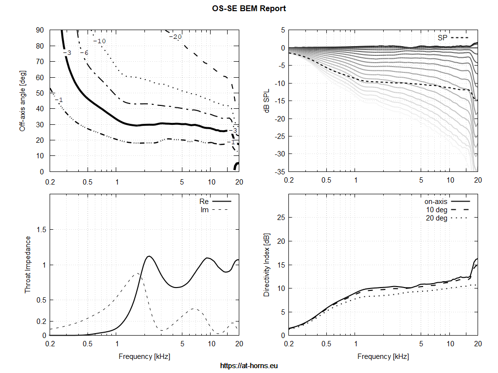

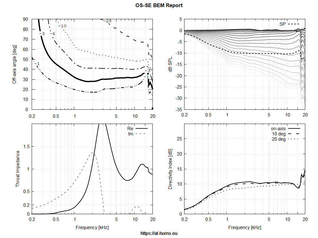

I again tested the effect of throat angle mismatch. It seems that in case of 1" driver it really isn't that critical (the graphs are normalized to 10°). Probably the biggest effect is on the acoustic impedance and respective ripple in absolute SPL (not seen here because of the normalization).
Two extremes -
Flat wavefront connected to 30° throat:
attachment.php
30° spherical wavefront connected to 0° throat:
attachment.php
