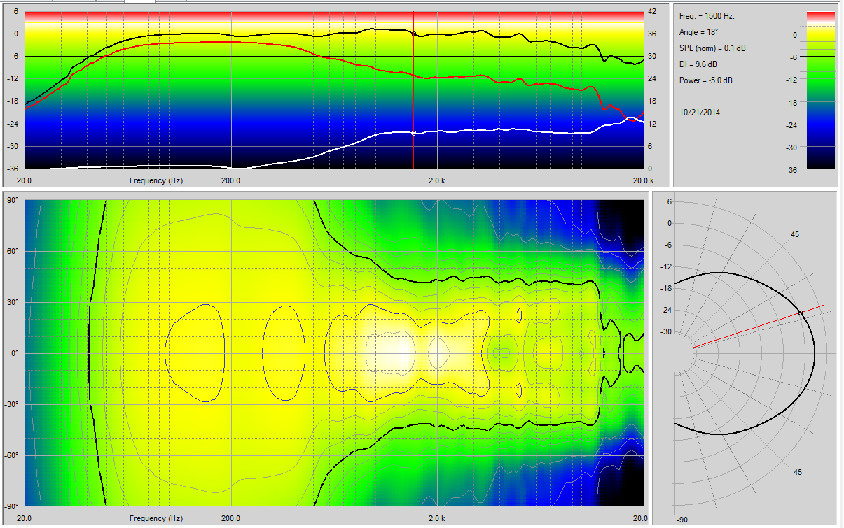

The better polar response is as expected, that's the whole point, of course.
Why was the frequency response worse?
Sources sum in a known way so it must be down to a disturbance in one or other of them.
I would expect neither the horn/WG nor the woofer response to be much disturbed unless the woofer was pushed quite far into mouth.
Which I assume you didn't do, based on other speakers of yours that I have seen.

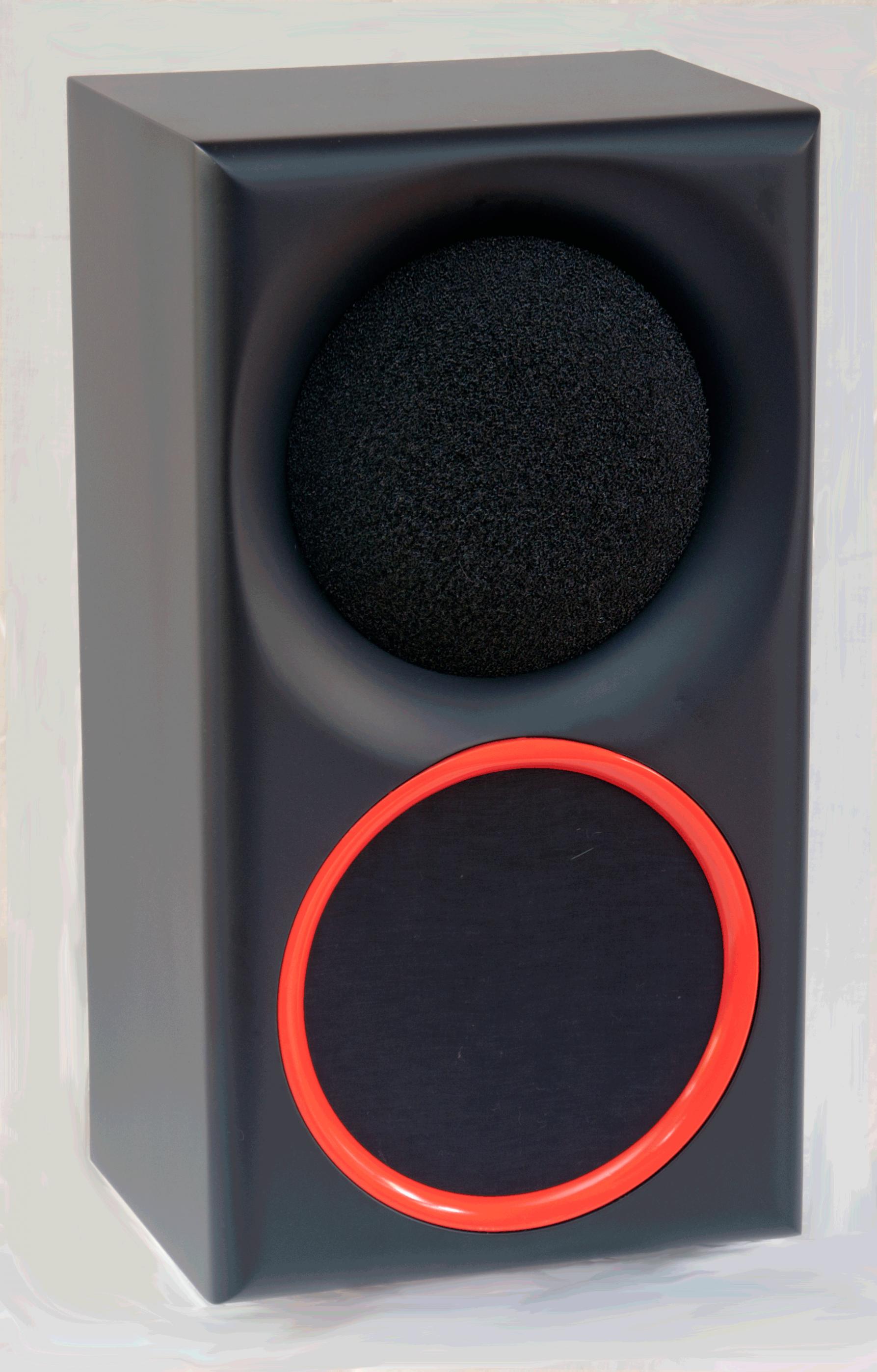

But I haven't actually seen the NA12, can you post a picture?
Best wishes
David

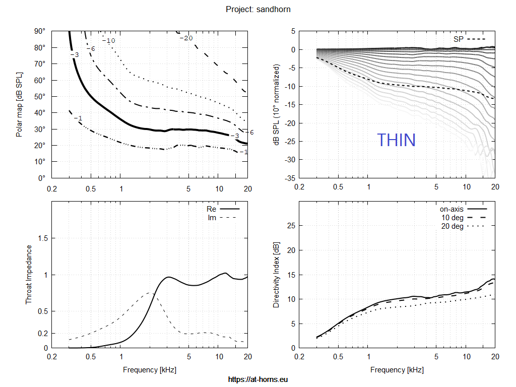

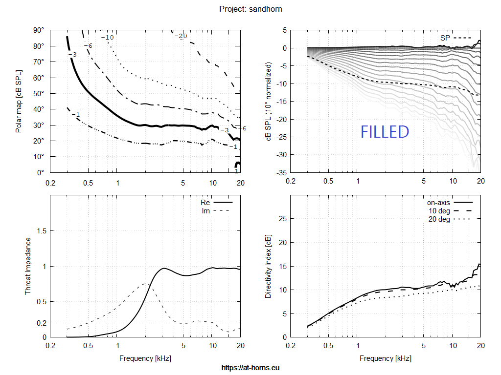

Actually, the thin wall version is smoother (for me this is not really intuitive and I wonder if this is not just a simulation thing):
attachment.php
"Filled-back" (sand printed version with a thick wall):
attachment.php
Thank you.
...find all that I have on them.
I knew you had stopped manufacture of this speaker, didn't realise you still had the picture up.
This confirms that the woofer has only been nested very little into the WG, as expected based on your previous comments.
But that only makes me more curious as to why such small difference would make the frequency response worse.
Presumably either the woofer or WG frequency response must have altered.
Did you determine which was responsible?
Is diffraction from the woofer frame and surround detectable when it's recessed to match as neatly as shown in the picture?
Best wishes
David
