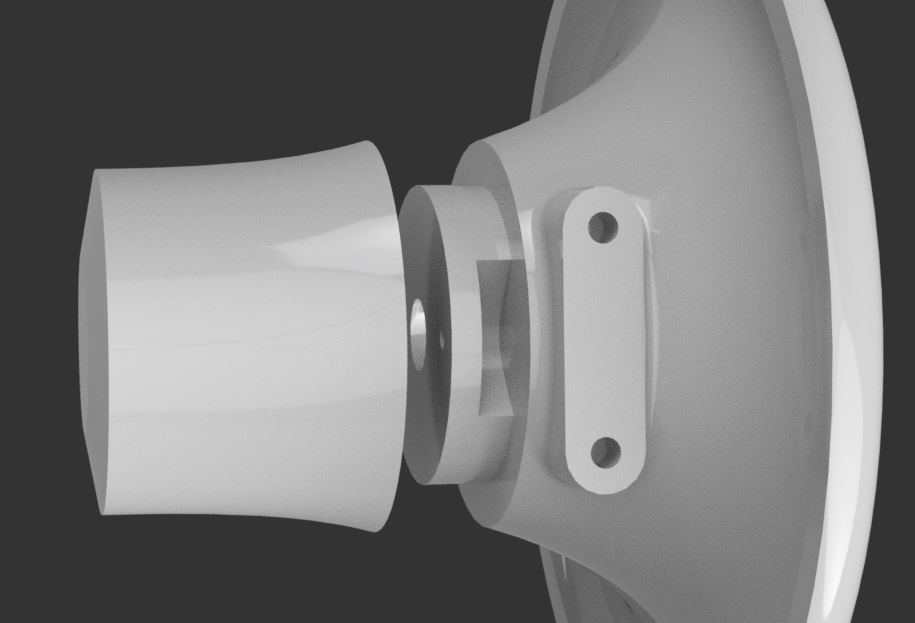

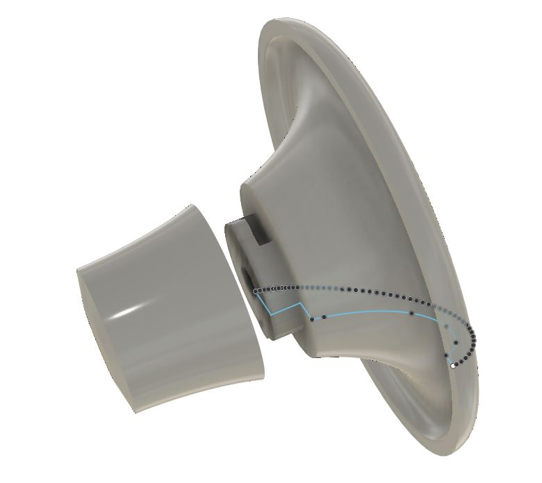

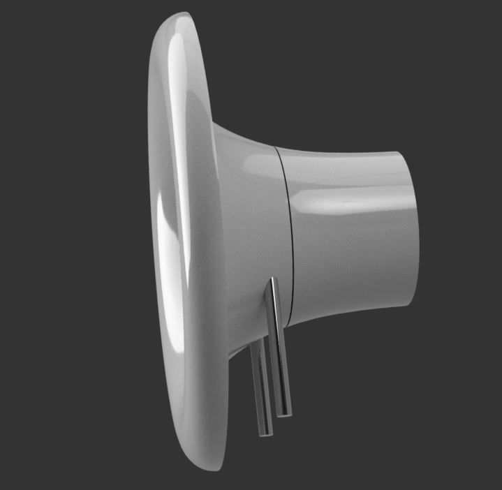

Unfortunately only for two bolts (at ⌀76 mm) - there's is not enough space for more (3x at ⌀57).
Very nice.
