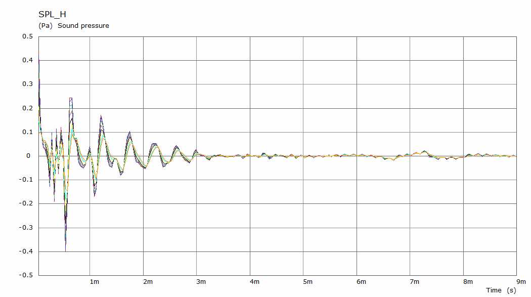

I'd be more interested whether is such a horn a minimum phase device at those frequencies. Don't you know?
I would suspect it is. Than the loading would be just irrelevant.
- Maybe it's the right time to get the impulse responses from the simulations. Then we could extract the excess group delay. Has this been done?
If you choose Fourier response from the processing menu in VACS you get this from an SPL contour plot, copying a single selected value to another window should give a single impulse rather than them being grouped like here

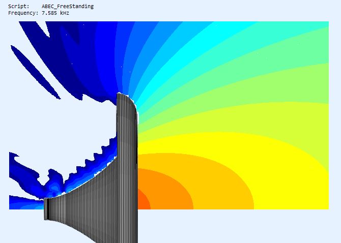

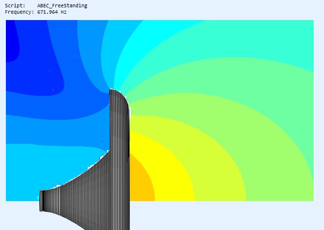

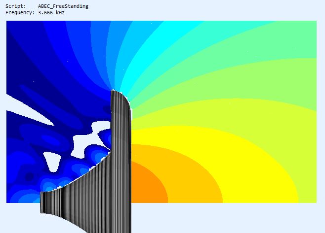

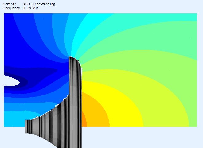

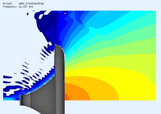

To illustrate the smoothness of the pressure field 🙂
(Grey areas are outside of the color range, i.e more than -60 dB from the throat. 3 dB step.)
All your simulations seem to be describing just one moment in time. I mean that you might want to look how a pulse injected into the throat looks at the mouth, in different directions, during a certain duration in time - say 10ms. Like a waterfall.
